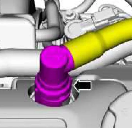

How do you remove the hose which is over the PCV valve? Simply pulling it off does not do the job. It feels locked into place.
GT Pony
Mar 13, 2015
77
9,402
4,839
Pacific NW
It is locked ... you need to press in on the side to unlock and at the same time pull it up and off.
