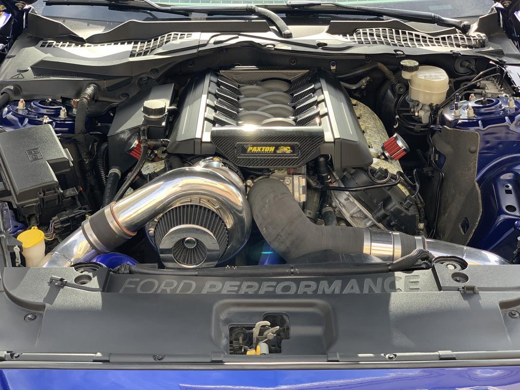

I also think it is one of the best looking set ups. Why? Because I like the huge polished blower smacking you in the face when you pop the hood :-D
Does look really awesome! I'll probably keep an intake tube running to a closed box setup with my Velossatech in the grill though. I'm not that hardcore, lol.

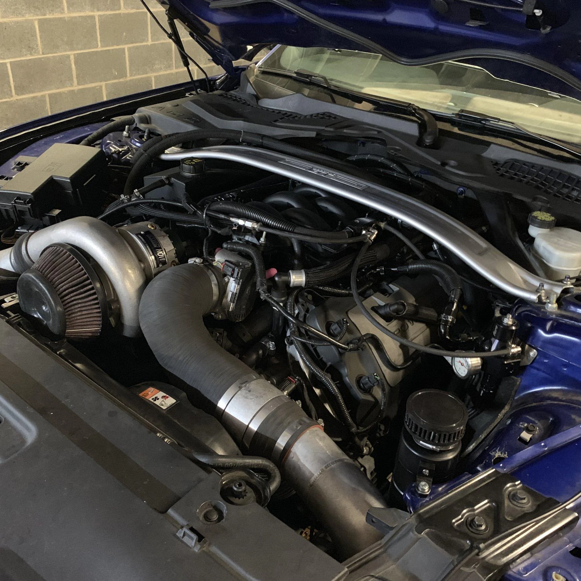

Btw does that filter on the blower suck a lot of hot air? Did you do that because the airbox is problematic?
It appears the 350 intake didn't pose any real problems for you?

lol just realized your down under. the gt350 wasnt problematic at all. I locked out the imrc's which helped take care of all the clutter. The manifold works flawlessly in the upper rpms. I put a wastegate on with 3.33 belt. I personally think its the best and most streetable kit around.
