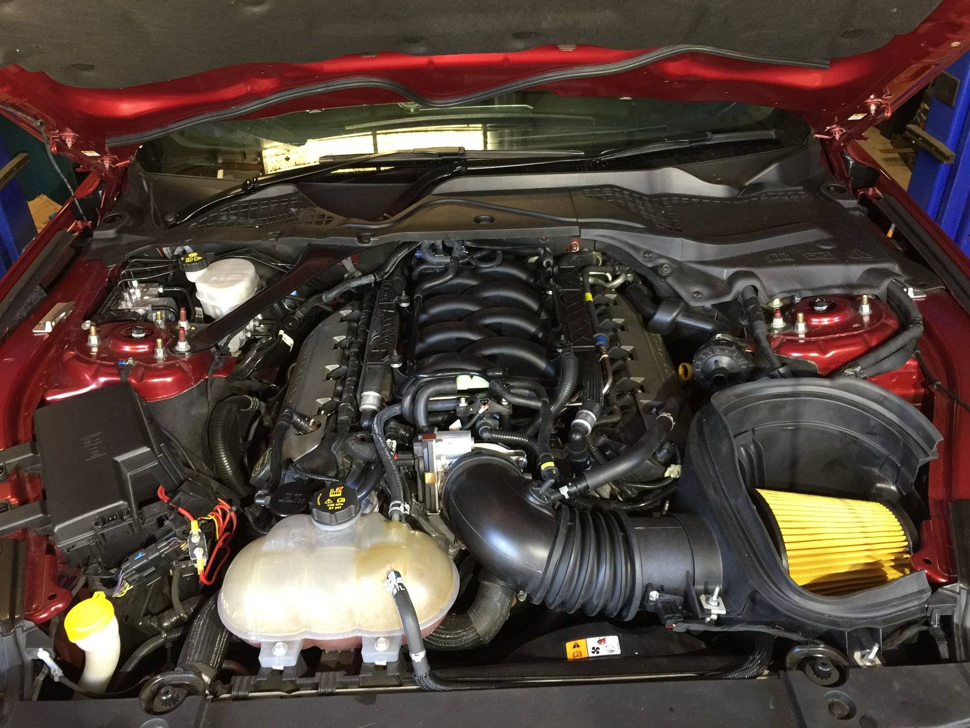

We'll I'm eyeing off blowers again. Ford won't do anything about the tick so I'm just going to give it hell anyway. I've since fitted headers and the GT350 intake manifold etc.
So, I was going to go for the Vortech JTB engine oil fed but I have another question which, i searched an answer for but couldn't find.....
What's the theory behind centrifugal sizing? EG; Si-trim vs JT-trim?
I suppose the Si spins up faster(easier) off idle than the JT but if the impeller is larger in the JT does that mean there's more airflow for the same speed?
If I'm not going for E85(too hard to get) or race fuel am I wasting my time with a JTB?
