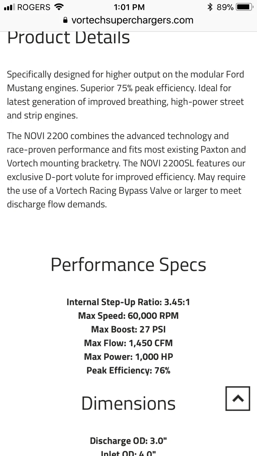

Was just on the new Paxton website, it states the max RPM of the SL as 60,000 rpm. Interestingly enough, the same as the HD model.
Is this corrrct?
The Common Procharger models it’s wither 62,000 or 65,000. So, it seems plausible.
Is this corrrct?
Was that for the NEW Head unit? I called Vortech and thats the info they gave on my the head unit I have which is SL but I believe the new SL head unit for the 18 is bigger and can handle more.

That pic is from the 2200SL not the heavy duty.
Did they say the SL could do 60,000?
Is the heavy duty self lubricating as well or oil line?
Yeah I asked them 3x he’s said the oil feed which is the HD version does 60k and the SL does 52k ..

Well, their website is wrong then! They need a proof reader perhaps. That would suck blowing up your blower spinning to 60 k like the website says and then finding out you’re over spinning by 8k.
The Procharger can spin to 62 or 65 k depending on the model.
