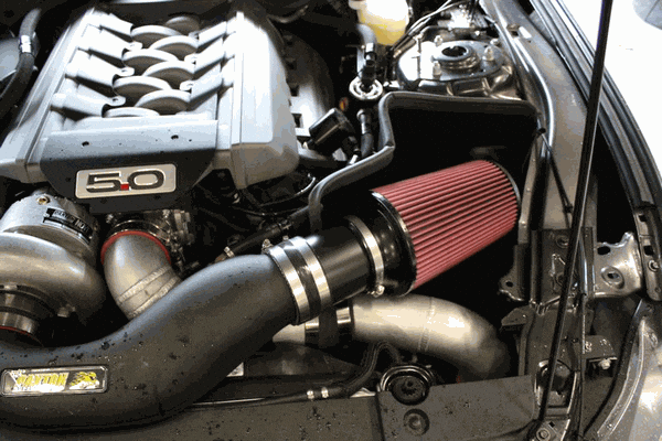

Looking at this pic it looks like you'd have to butcher the stock or GT350 airbox?
