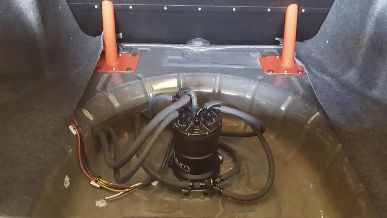

Yeah I was expecting around 15-16 but I’m suspecting belt slip. That boost curve really flattens out for a little there at 6k. I bet with an 8 rib I’d pick up a little more. 20 degrees of timing. It’s set for a max of 22 which I saw on the 3.8 pulley, but with the added load it’s restricting timing to 20 even with a happy knock sensor. Lund said that’s how he has the tune set up. It’s a fore system with my custom surge tank setup in the trunk. Single Walbro 465 in the main tank priming the surge tank then 2 465’s in the surge tank to the rail.
I am curious why you have a seperate surge tank. What is the purpose of two fuel tanks?
For cornering purposes. These cars have a fuel starvation issue on hard left corners. With the fore system which has no basket, this problem becomes much worse. So the surge tank is just a half gallon cylinder so the pumps are always submerged in fuel regardless of which way the fuel wants to slosh. This is a road race car, so having to top off every 3 laps got old quick.
