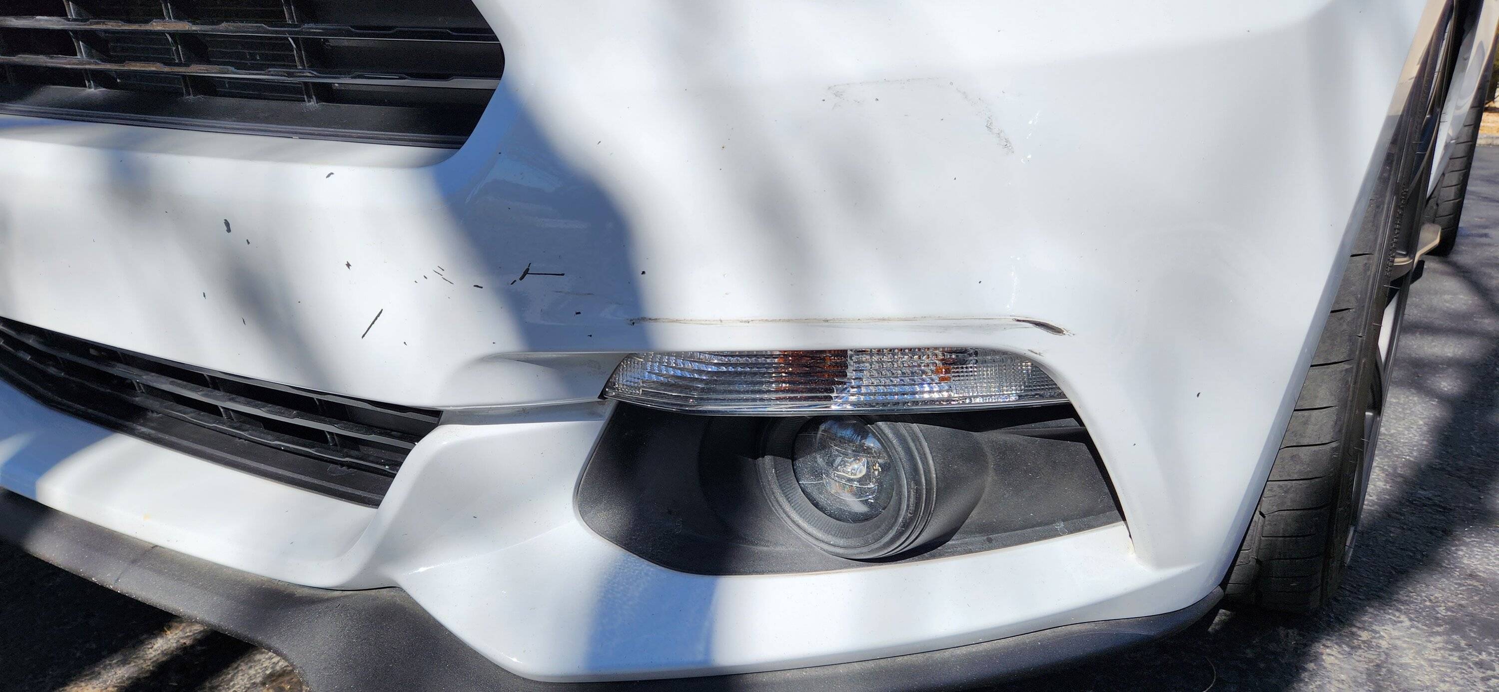

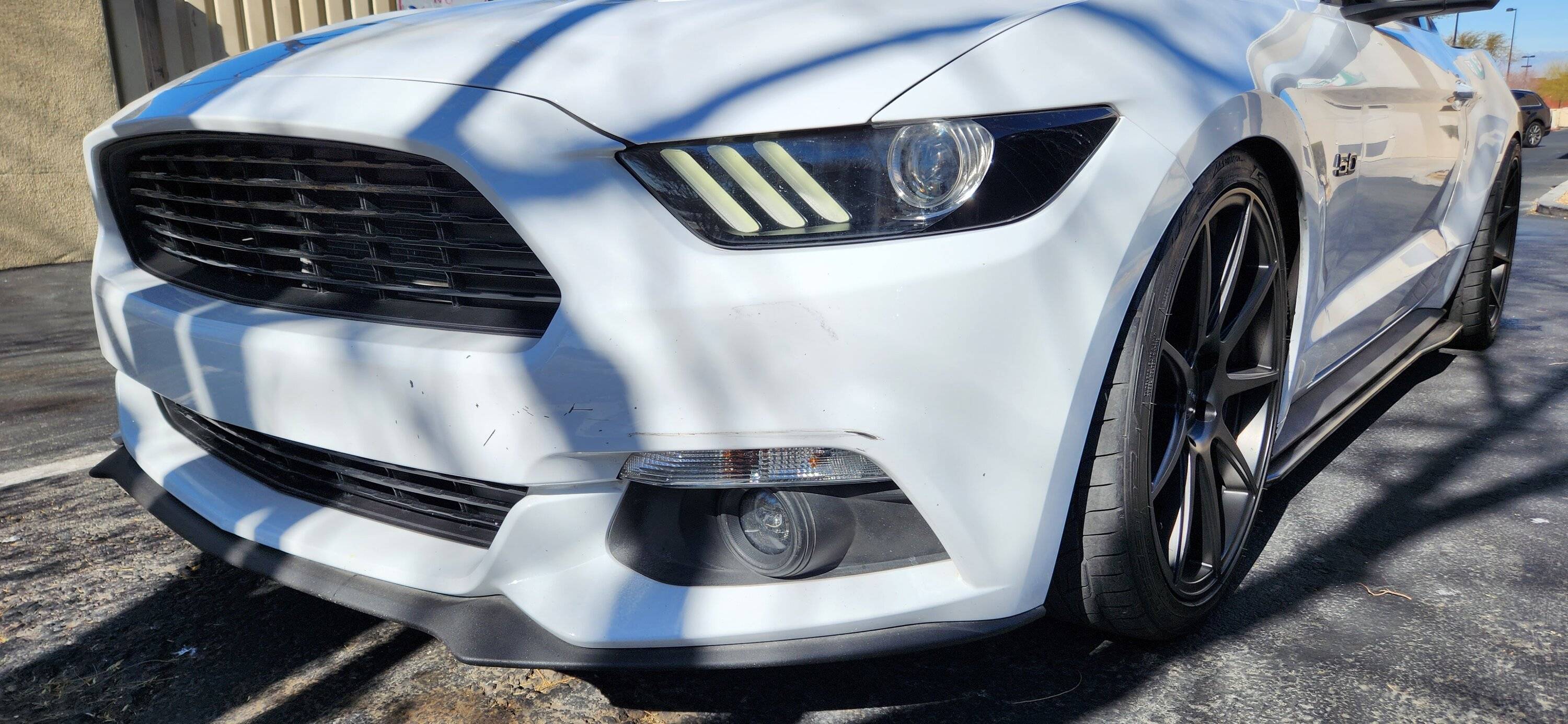

Long story short, lady pulled out in front of me in 100% retard fashion. Thankfully since one of us was actually paying attention, this was what resulted in which would have otherwise been a full on T-bone. In the moment I wanted to end her. Once the head cleared, I realize how lucky I am that this was the only result.
Anyway, for this damage, is it something only a shop would fix due to the size of the area of paint removed? Or is their some home remedy application that might be able to match the surface area? There is somehow no gouging in the body itself, slight scuffing as it gets smaller right above the foglight.. Thoughts?

That looks like it needs to be painted in a shop.
You could try a paint correction pen, but you will definitely notice where you have corrected.
You can also try 3M Scratch remover -- or similar -- if you wanna clean up the scuffing. It might get to a point where you only see the larger scratches.

Some of the lighter spots might be able to be polished out but the deeper spots would need more prep and either a touch up (which will be noticeable) or be sprayed at a shop. That part is all plastic which makes touch up paint a little less desirable IMO.

I am going to bet some of the bumper clips are busted and maybe more damage than meets the eye. Have it looked at.
It’s difficult for 2 cars to meet and not break plastic.

That sort of damage I would have repaired by a professional.
That doesn't necessarily mean having the bumper completely repainted. I have a paint-less dent removal guy that also does small paint touch ups like this, it may be worth seeking out someone like that in your area.
