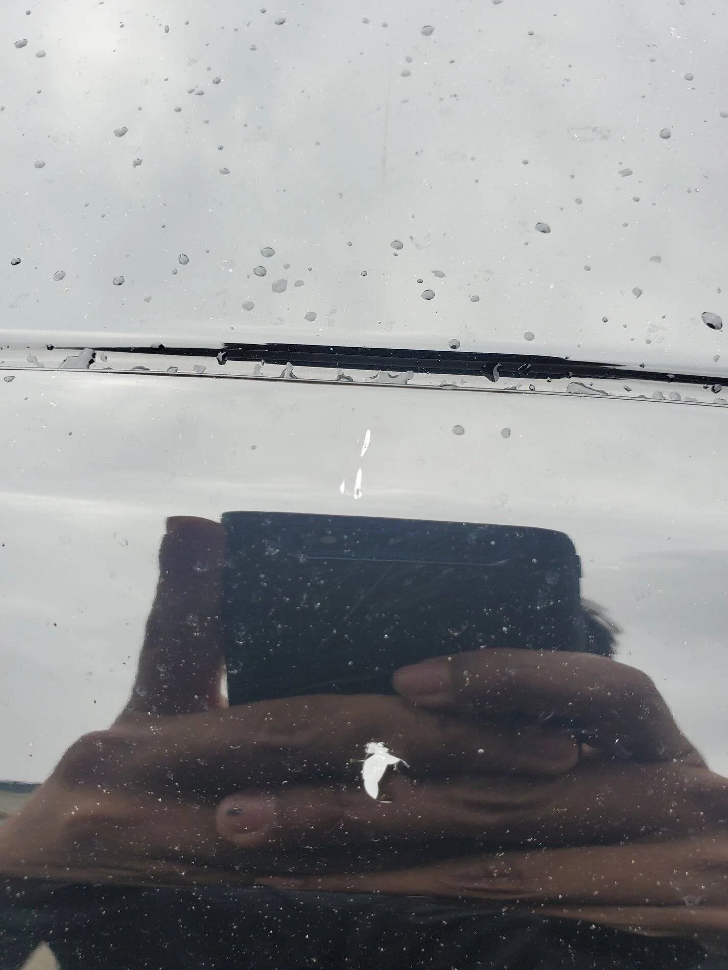

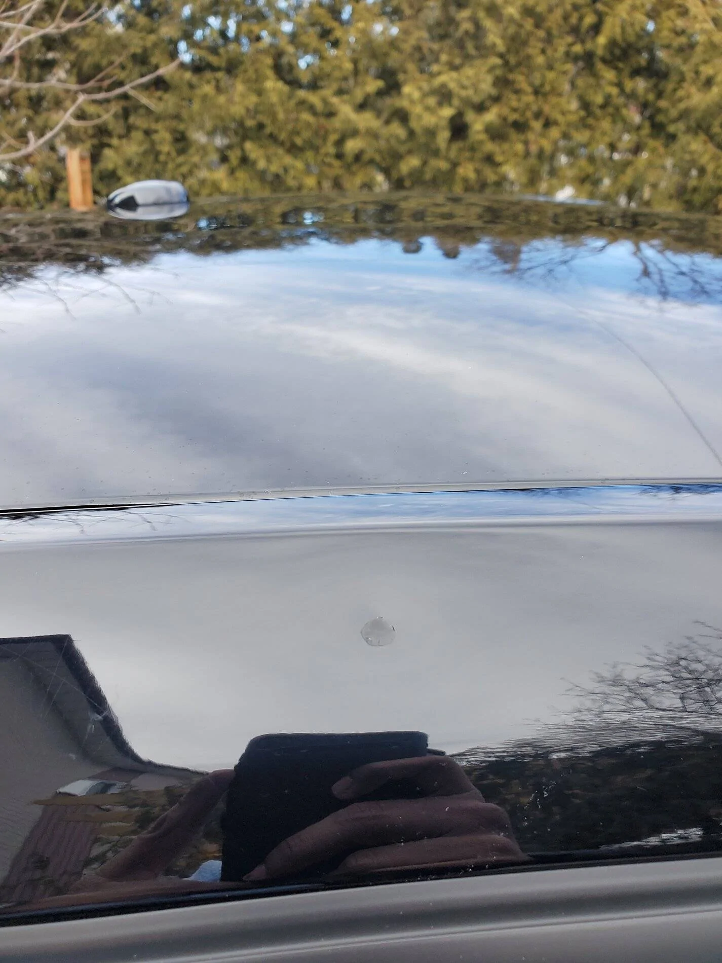

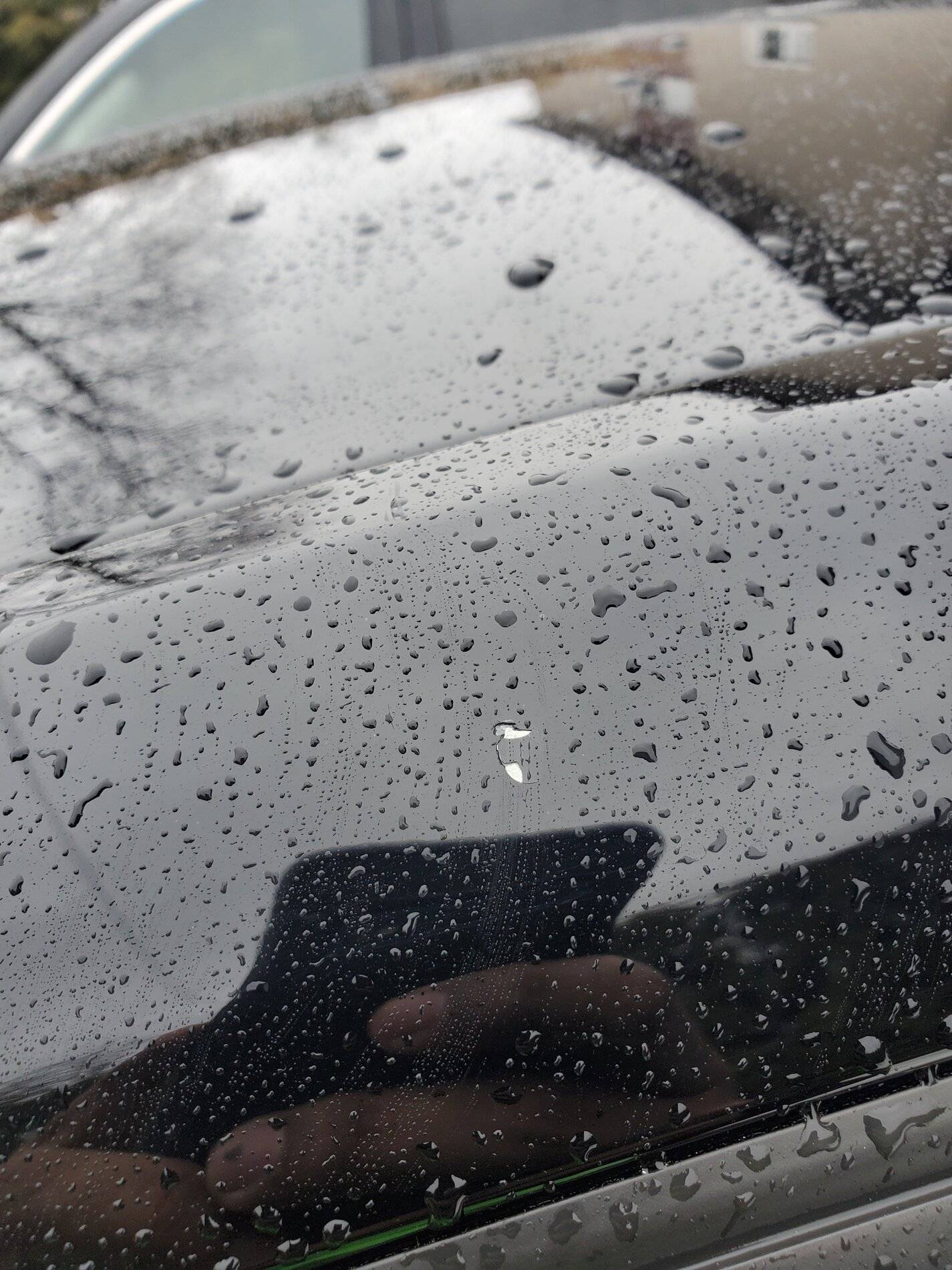

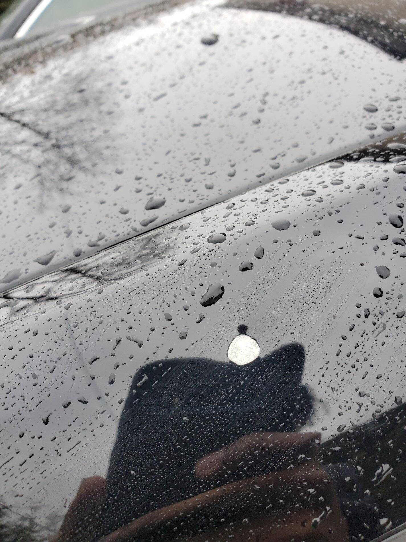

Hi Everyone,
I just washed my 2018 Mustang EB today and noticed 3 reasonably large chips in paint all on the passenger side.
2 of them are on the railing above the passenger window and one large one above the rear fender beside the trunk. I still have 2500 mi left on my warranty.
The car is a daily driver and gets washed weekly but I never noticed these until today so they are relatively new.
Its hard to say these are rock chips as they are on the passenger side at the top and back. Is this something that would be covered by Ford under warranty?
Above Passenger Window Rail:
Above Passenger Side Rear Fender Beside the Trunk:

Not covered by warranty.
Welcome to Ford's brittle as an eggshell paint!
The first two were most likely caused by rocks or more specifically rock salt from the road. Rock salt will blow out some big sized chips.
that last big one looks like something scraped against it I can see the witness Mark in the metal.
Throw some touch up paint on it as best you can. Do it in layers to slowly build up the chip. Then if your really good you can build it up higher than the surrounding paint, wet sand it down and polish it so it blends into the surrounding paint as good as it's going to.

The 2nd pic if making it larger looks like someone scratched the surface and the paint flaked. Make the pic bigger and look at it closely.
Attached is Ford Warrantable vs Non-Warrantable paint guide. The Ford paint is covered under the 5/60 Paint And Corrosion Warranty outlined in your Mustang Owner's Manual. It does not protect against damages such as rock chips or other, only workmanship and corrosion.

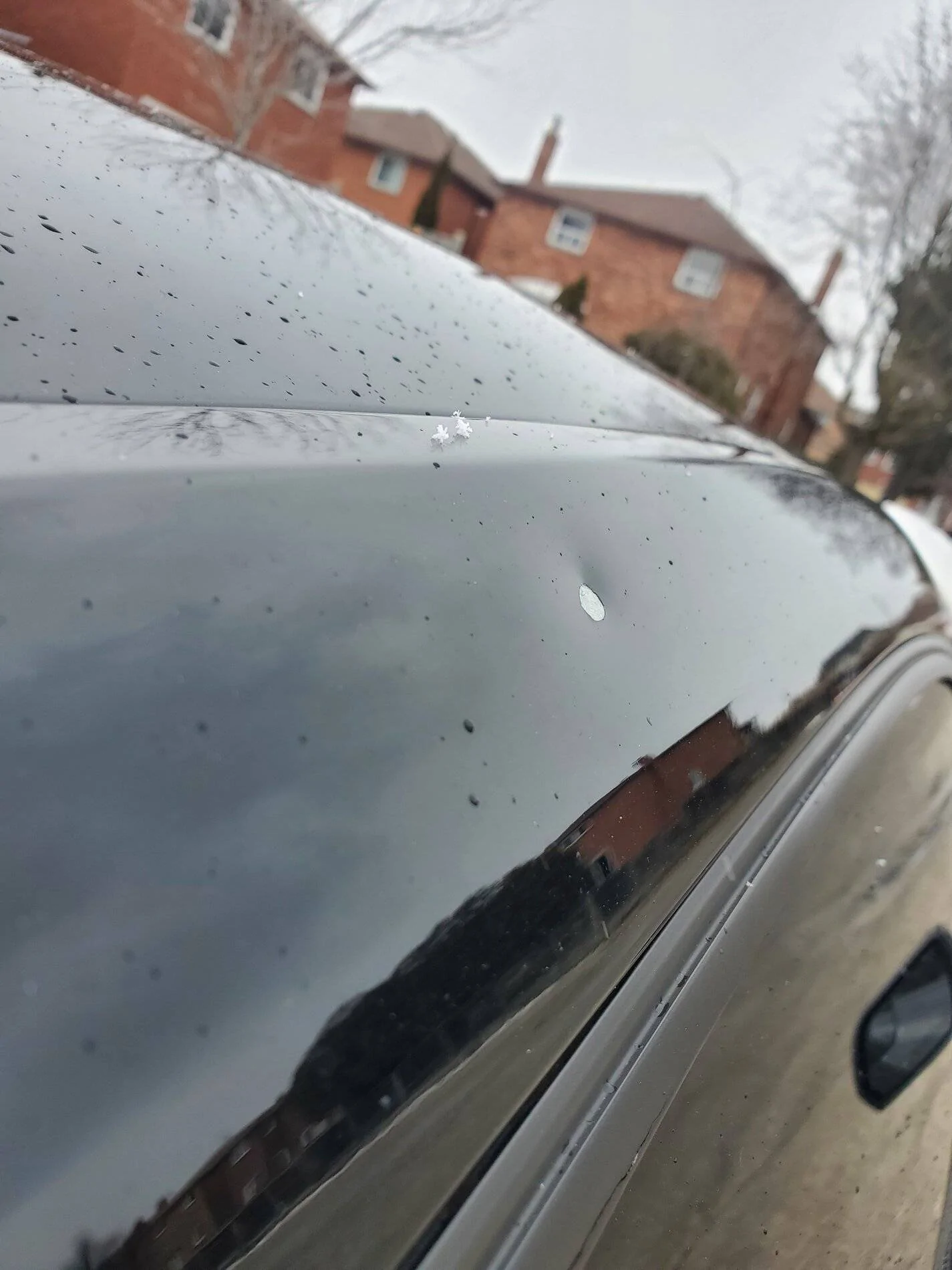

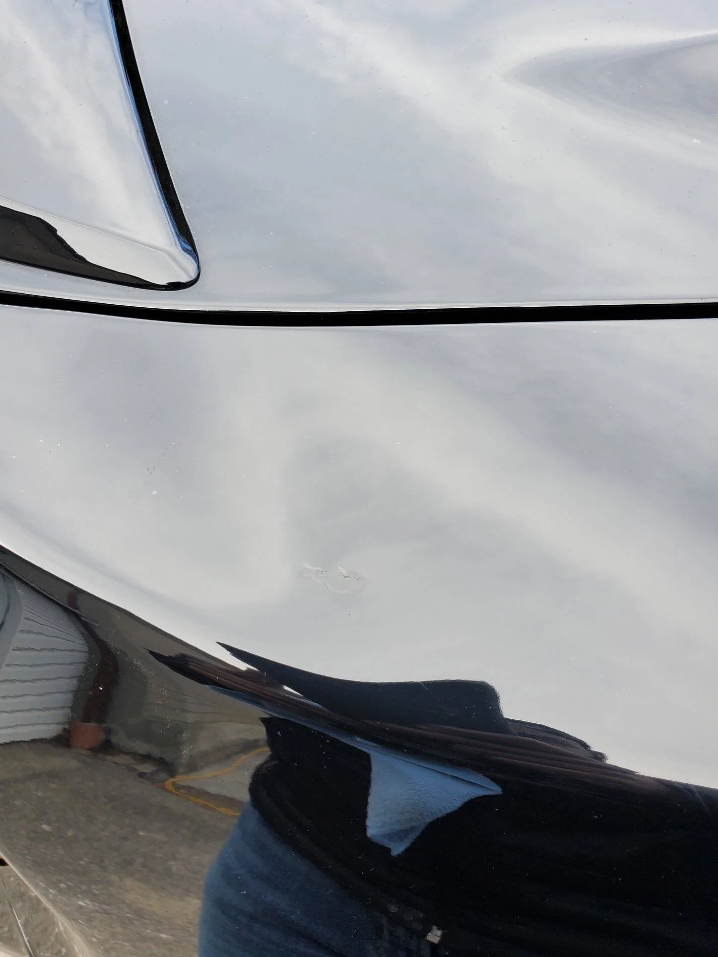

Was requested by the dealership to take photos from different angles. With more light outside, I captured some and now it looks pretty evident that something hit the car as there is a dent as you can see in the first picture. This pretty much closed the door on Ford fixing it.
On the 2nd picture you can see vertical marks just above chip as well.
It just boggles my mind what caused this as it seems something was thrown head on at the passenger side.
I guess I'll have to use touch up paint for now to atleast protect it before it gets worse.

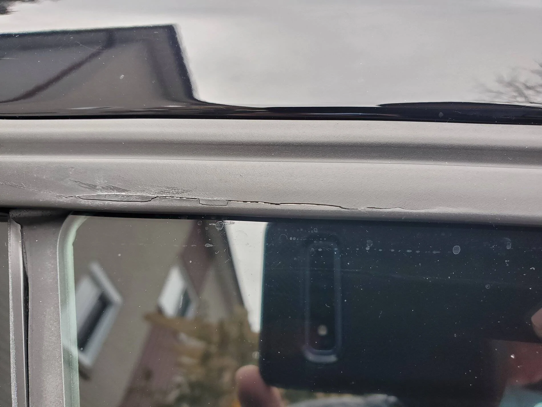

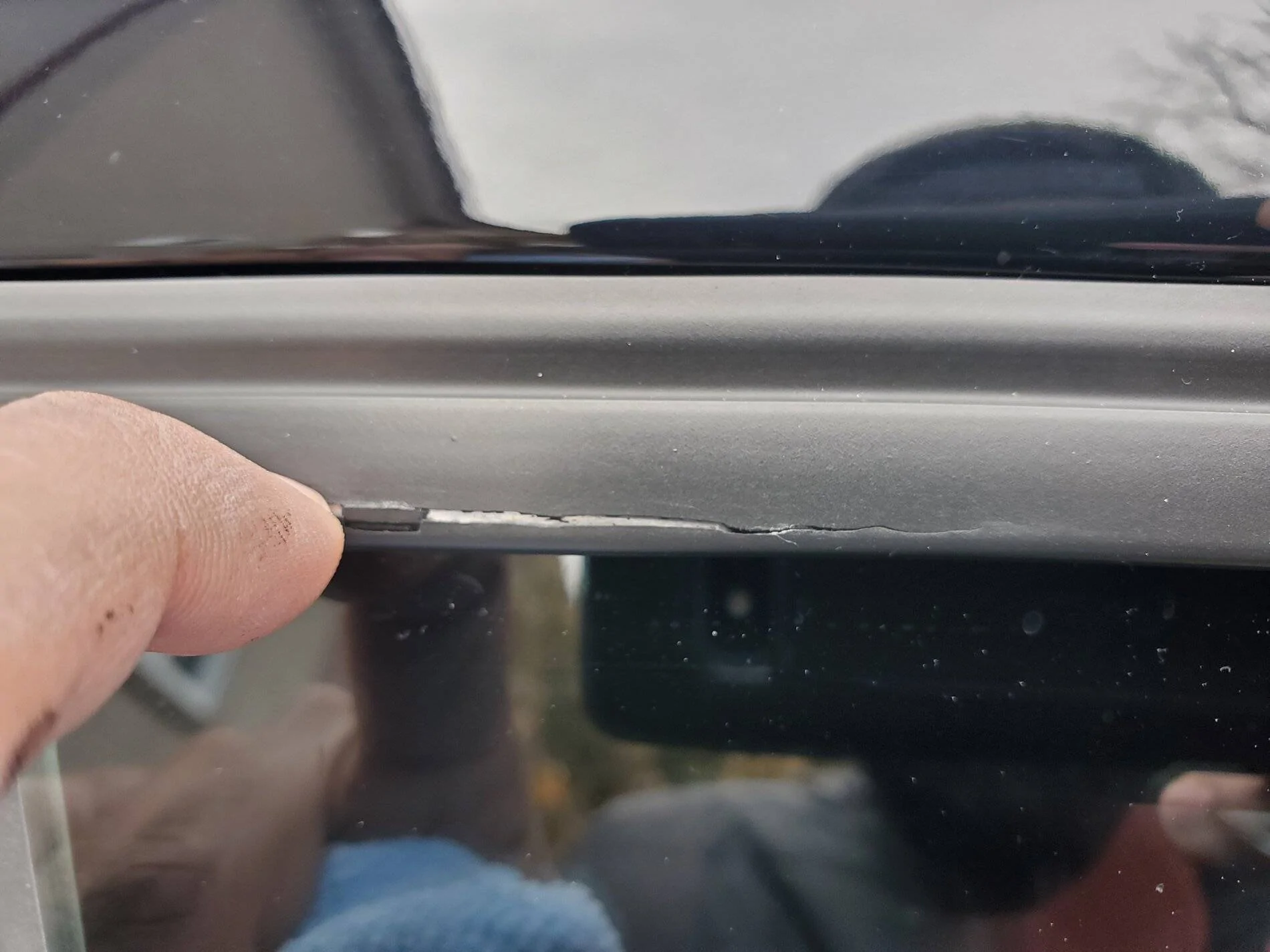

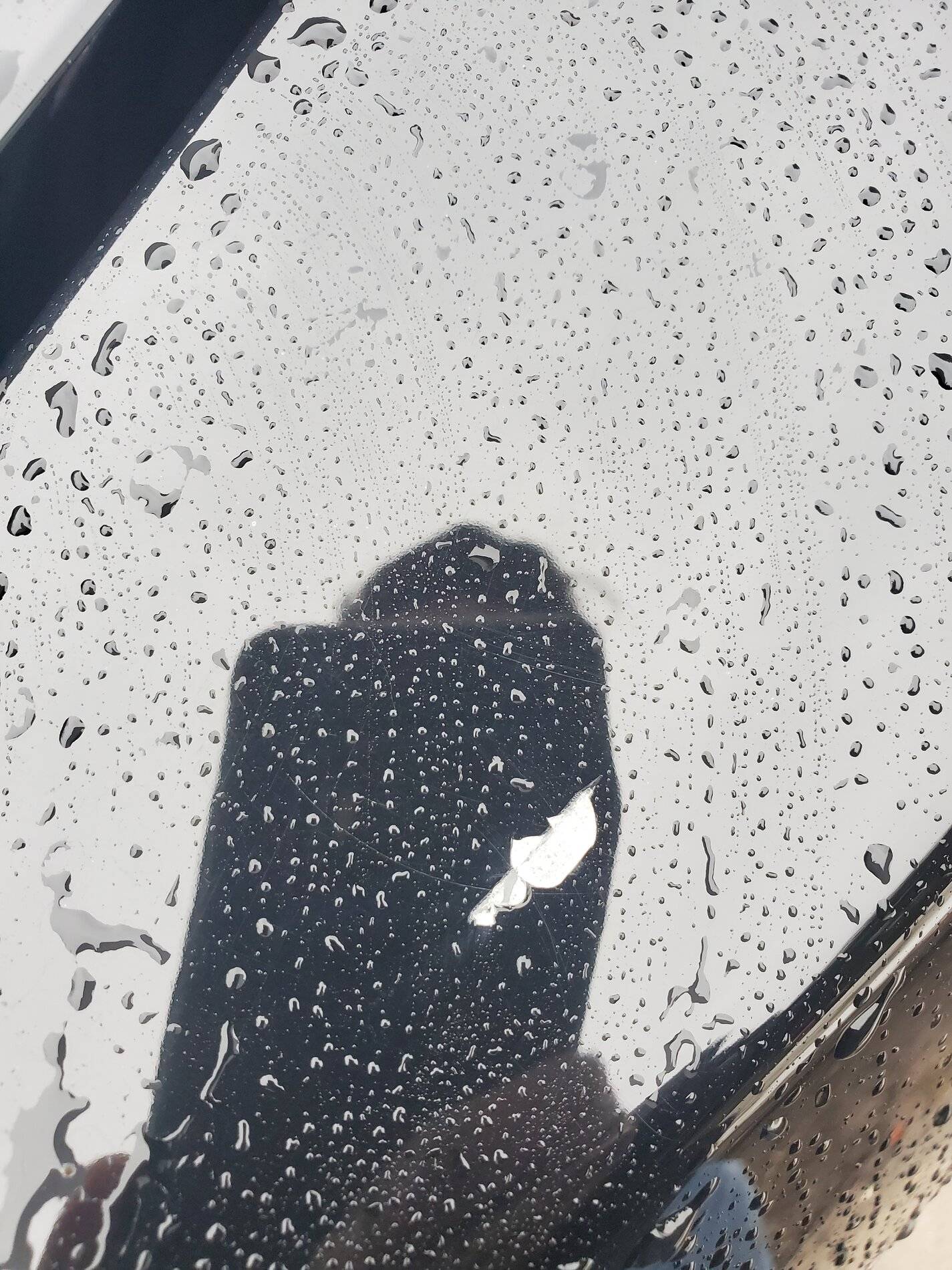

I found something though as I was repairing.
The plastic trim above the window seems to have cracked or peeling. Has this ever happened before? I'm really hoping this is a warranty repair because I don't see what might have caused it.
I’ve never seen that piece crack before and I don’t think there are any prior threads about anyone reporting such damage.
Are you sure someone hasn’t thrown something at your car while it was parked to cause the damages to that part and the paint?

U can see from marks that was induced by a impact.

Looks like it was pried on. As if someone stuck a wedge in there to force open the door. Kinda like what repo guys do when they're opening locked doors.
Also, I've seen similar damage done by an egg. Eggshells can absolutely chip paint off and the yolk will eat away at the clear coat due to the protein.
I assume you'd have mentioned cleaning eggs off your car if that was the case though.

As its winter and you have mentioned salt on the roads, have your doors ever froze up enough to stop the auto window drop ?
That kind of looks like the window has impacted it if the door was closed with the window in the fully up position.
My other half's mini had the window freezing issue and although it sounded horrible, we were fortunate it didn't break or damage anything.
Whatever has caused your issues, I hope you get them sorted :like:
