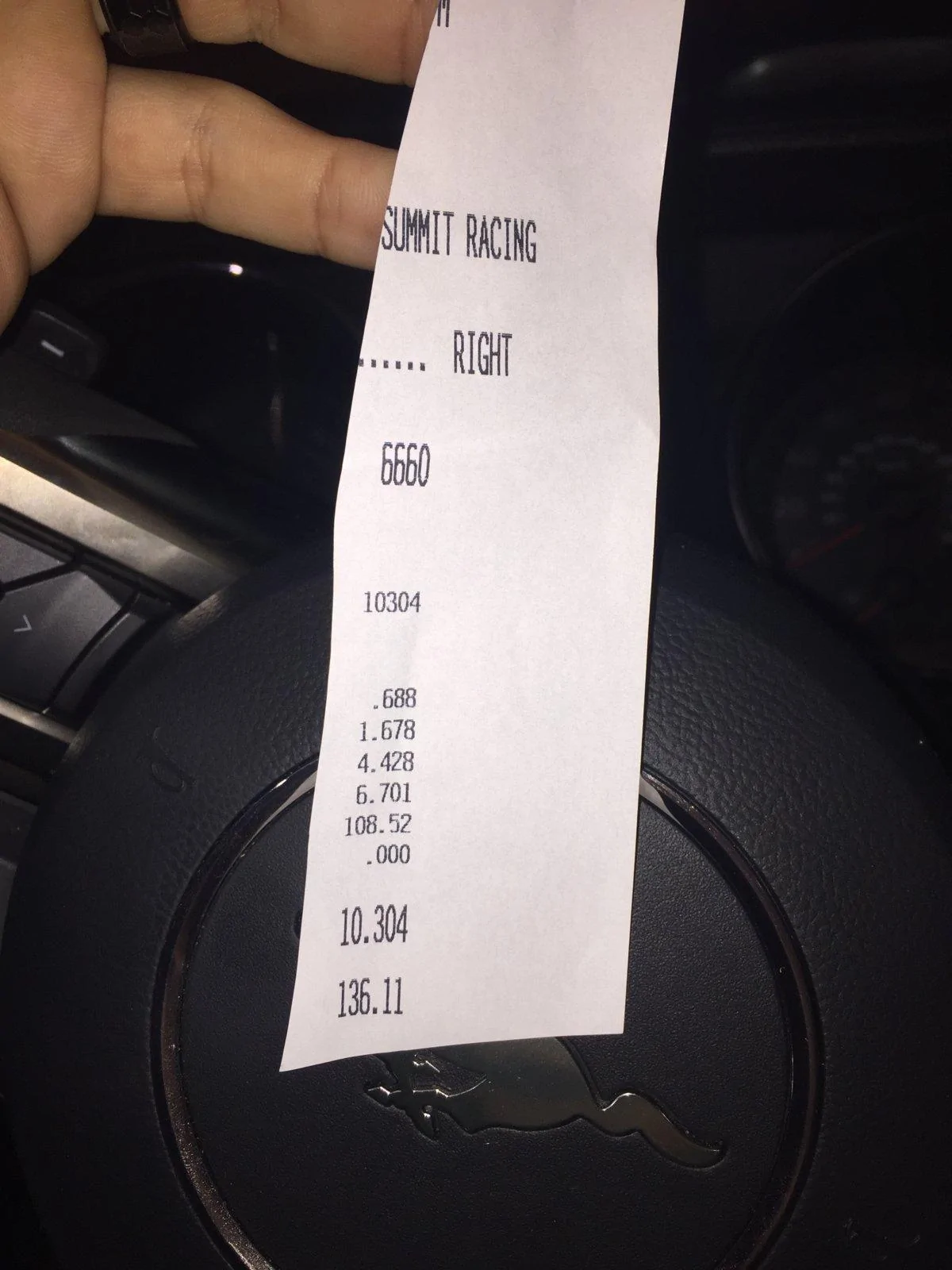

Its running good,without a stall on race gas i ran a 10.2 at 140mph in about +1000 da.If u can get some -1000 da 10.1 is possible.I also need a intake manifold,stock one is hurting me.

I thought you ran low 10s at very high 130s with a D1sc and FTI converter. Didn’t gain anything from converter? Tune was off?

Yea im at 9.7 at 142 with the convertor now,without,but u are right when i first put convertor in i did go a 10.2 on a hot day.Then i changed my fuel.system and went e85 then starting hitting the 9's.I have some tweaking to.do to my shift points and think i can get a 9.5 in good air.My car is shifting 1st gear way to early.

Also.without a convertor my car only ran 10.6,but i was having knock issues from fuel and wanted to just go e85 to be safe.

Yea man i went from a low 1.7 60 ft to 1.40 60ft two weeks ago at capitol.Makes a huge difference.
