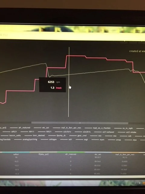

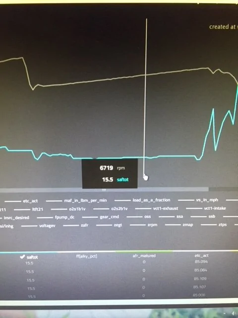

Well after looking at log, not what I expected to see, but it surely has more in it. These are just a superficial look. TM hit hard on the 1-2 shift which was a hair on the low side RPM wise. Also commanded timing is 17*, but only saw 16* in 3rd and a lowly 15* in all of 4th,

what are you using for fuel 93 with an additive?
Torco or octanium mostly. If I can’t get it then I’d dump a gallon or 2 of MS103 to avoid situations like these (knock), but I’m at the mercy of the mix. I need E85.
