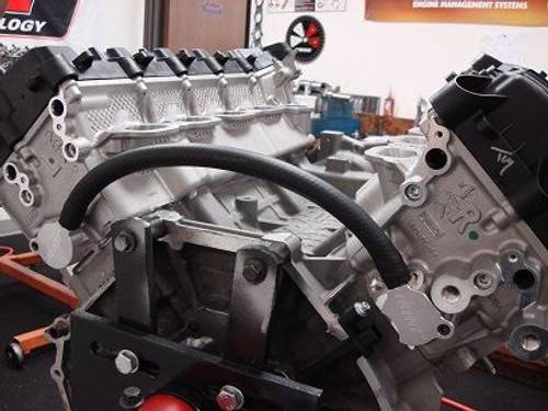

Interesting, look how the former MMR hose is routed…… lower than the cylinder head coolant outlet ports.
Mine is probably that low. I can check tomorrow.
I hope it is as low as the second illustration for your sake.
It would be good to know the flow bias of left and right cylinder cooling port outlets. I think it’s nearly impossible that the bias is a perfect 50/50 split.

I don't see the mmr crossover deal doing anything productive.
I’m not sure. It’s hard for an independent person to do testing to back up their claims.
I believe if Ford engineers found a crossover was NEEDED, and had any significant benefit, they would have put one there. With all the rigorous durability testing they did on the Coyote, I think it’s a useless mod IMHO.

Have they backed up their claims?
They just make statements:
"MMR's cooling head mod ( HCM ) for the 2011-2023 5.0 / 5.2 Coyote is designed to help eliminate hotspots in the #8 cylinder by promoting coolant flow around cylinder # 8 - the cylinder long known to be the first to detonate with aggressive naturally aspirated tunes and forced induction. Dont fall victim to this failure, protect your investment with this simple, professional kit. Installation requires tapping out the factory freeze plugs and simply installing the MMR kit. Kit seals with high grade DOUBLE* Viton Brand Aerospace O rings. NHRA Approved Socketless hose does not require hose clamps for simple push on installation. Includes all parts shown, no other parts required. Fits all Mustang, BOSS and F150 with 5.0 & 5.2 TiVCT engine. Billet Alloy construction. 100% USA MADE by MMR - Patent Pending"
Someone would have to call and ask what testing they did.
To be fair Ford also has kept the same oil pump gears. I have also seen people crack their engine blocks where it mates with the transmission (another product mmr sells).
I think it's not a need on stock cars, just like oil pump gears aren't. But I think there is a possibility of it being a benefit on modified cars.
If data was available, it would be present in the product info.
MMR doesn't even include installation instructions for any of its products. You kinda have to call and ask, they are pretty helpful on the phone.
