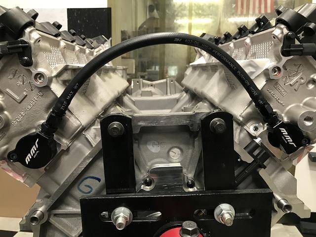

I do also have the mmr head cooling mod. I’m wondering if air may be trapped in there.
Also I pressure tested the system again at 21 psi and it lost 1 psi of pressure after about 3.5 hours. Don’t think that’s enough to cause issues.
My MMR cooling mod leaked. Luckily it was the connections of the lines (and not the seal/fit of the assembly into the heads). Was a real MF to remove them and apply teflon tape to get them sealed up. Should probably check them.
Mine did too the first time I did it. This time I used thread sealant and don’t see any signs of leaking

Now that is an air trap.
Yep, maybe because it was leaking a little last time the air could escape. But maybe air is stuck their and messing with the cooling idk
