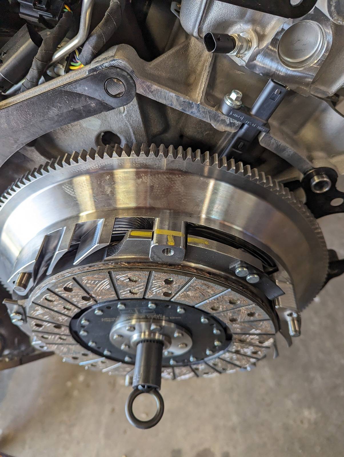

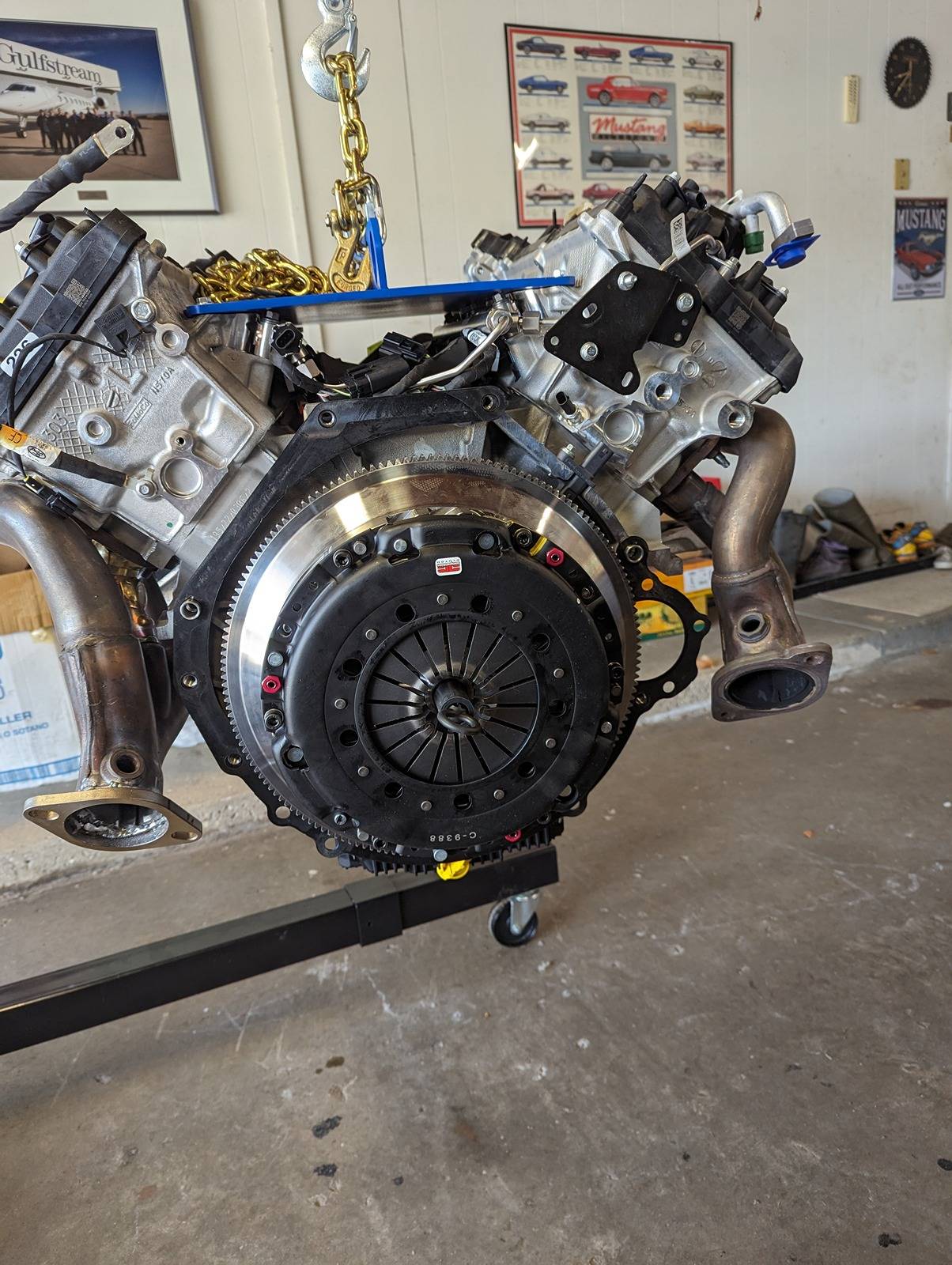

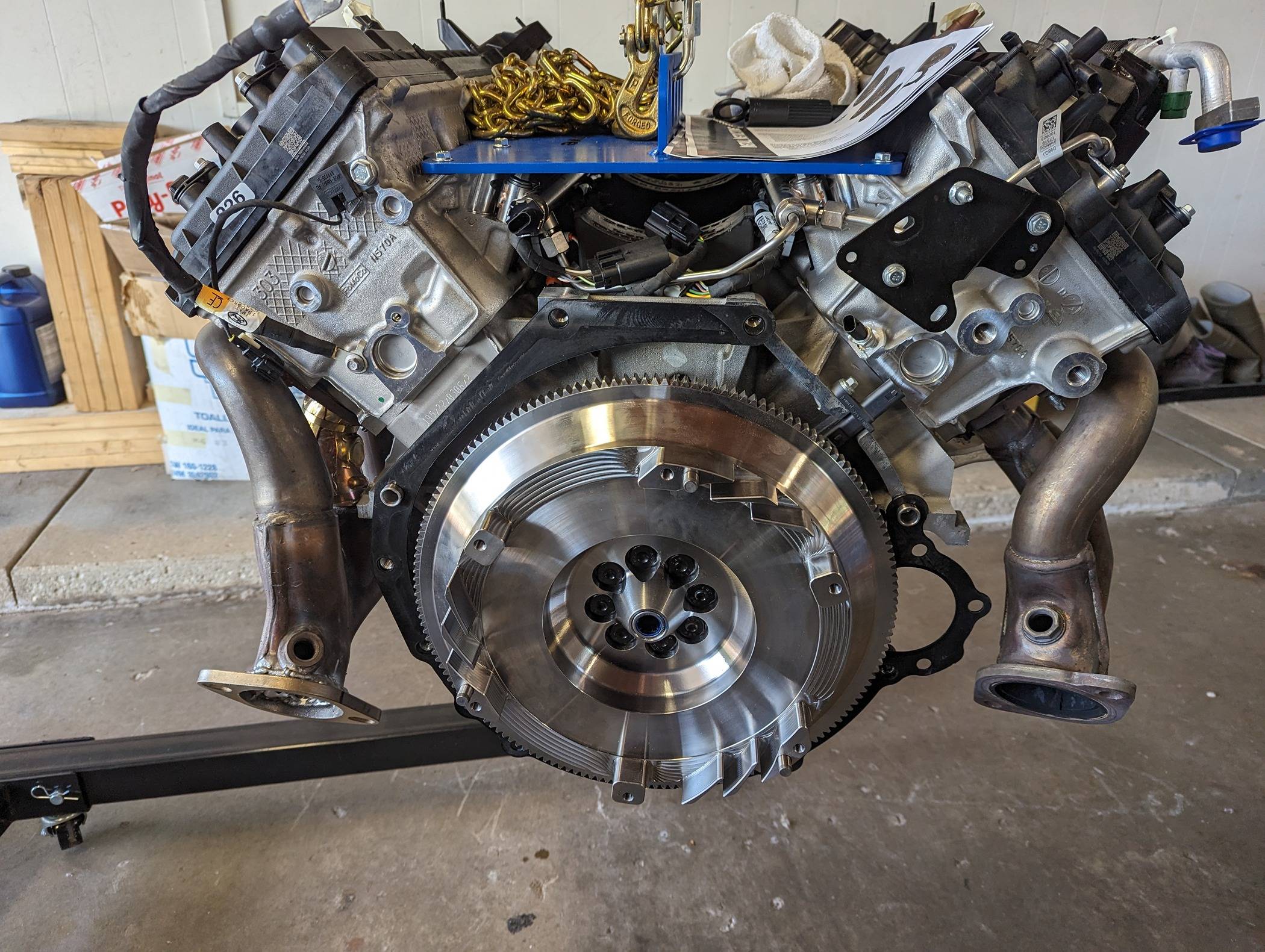

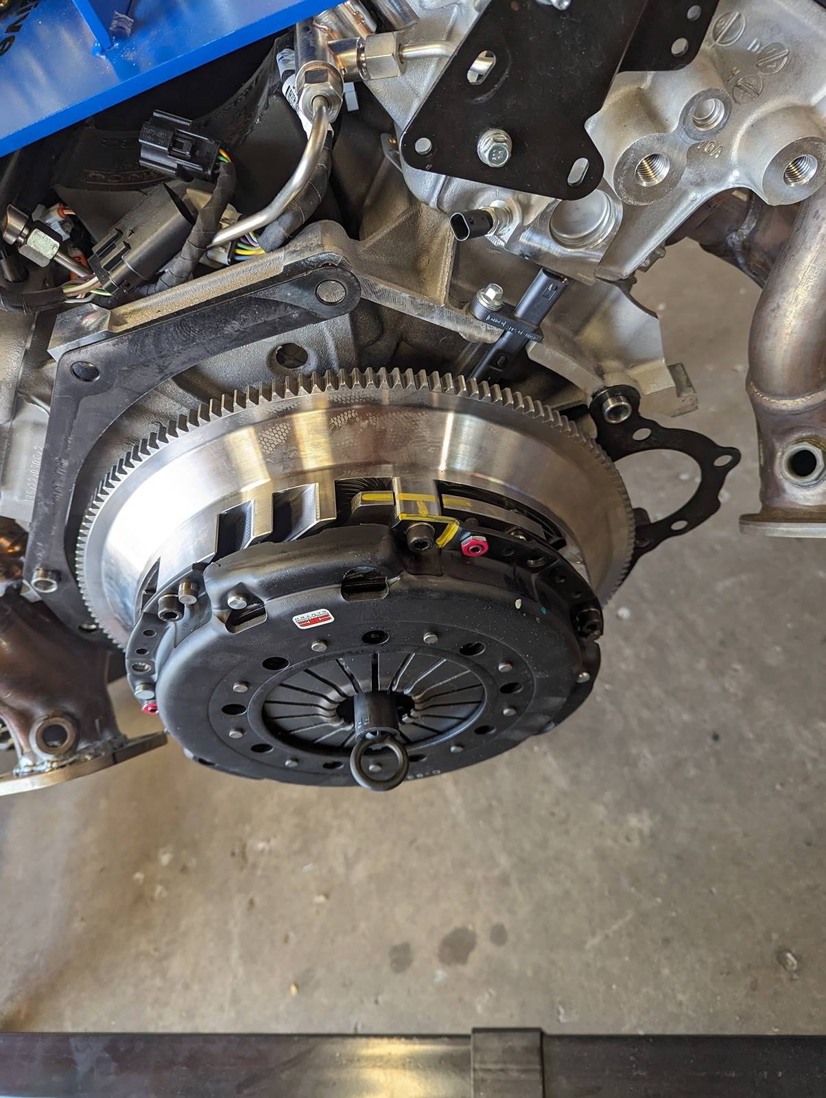

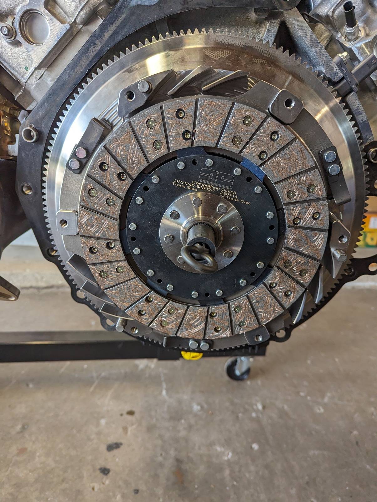

Went with the RST, new throwout bearing, braided line, MGW X-Spec shifter and some other parts I've wanted.

I installed the RST about 2 months ago. The car shifts so much better than before. My only complaint is I do have some chatter from 1300-ish to 1500 RPM under load. My advice is to take your time when installing the pressure plate. The installation guide poorly details how to set the clearance between pressure plate, floater plate, and friction disks. You may have to run through the process a couple of times to get it right.

I'm paying someone to do the install. I've never changed a clutch before and I'll probably mess it up. My car is my daily, so I only have limited down time too.
