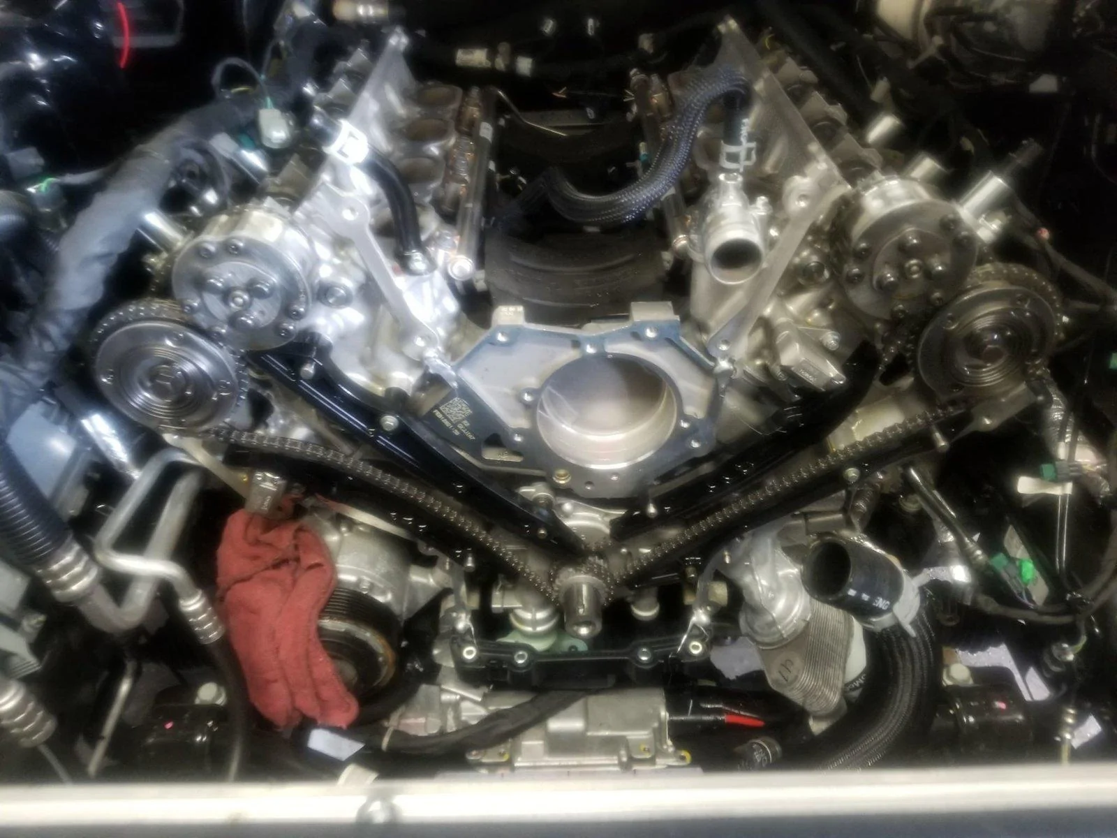

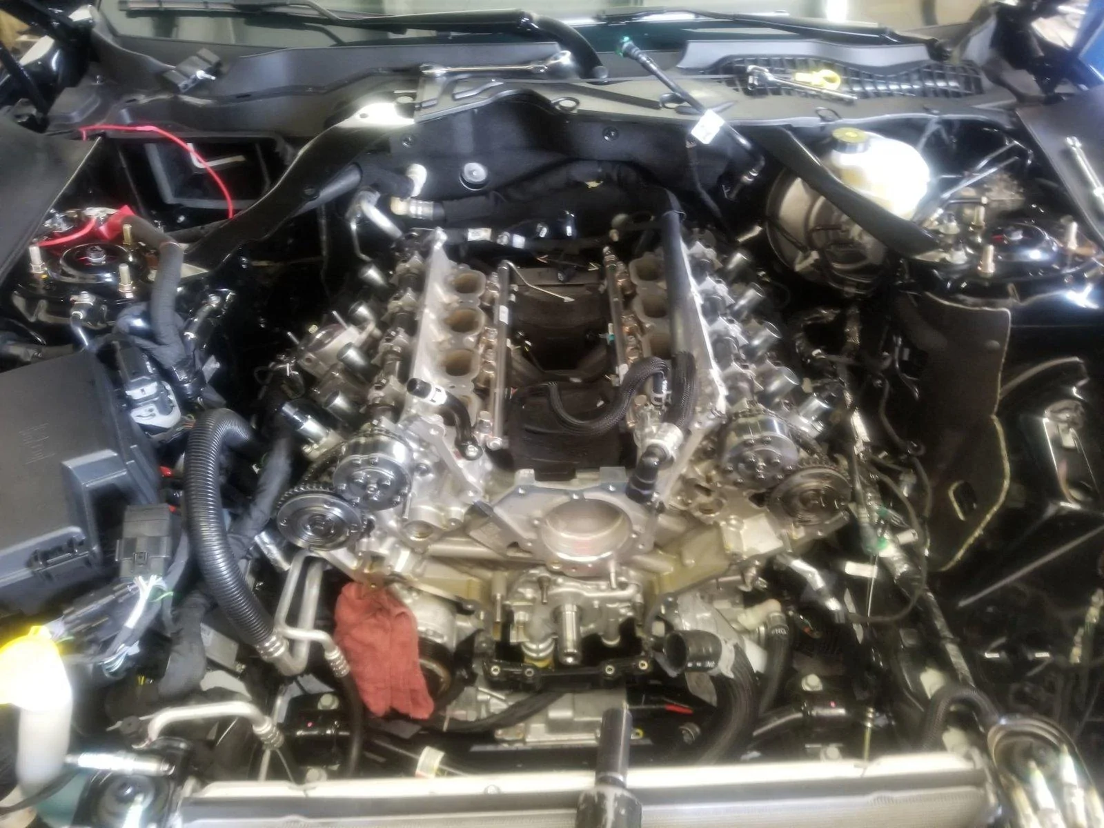

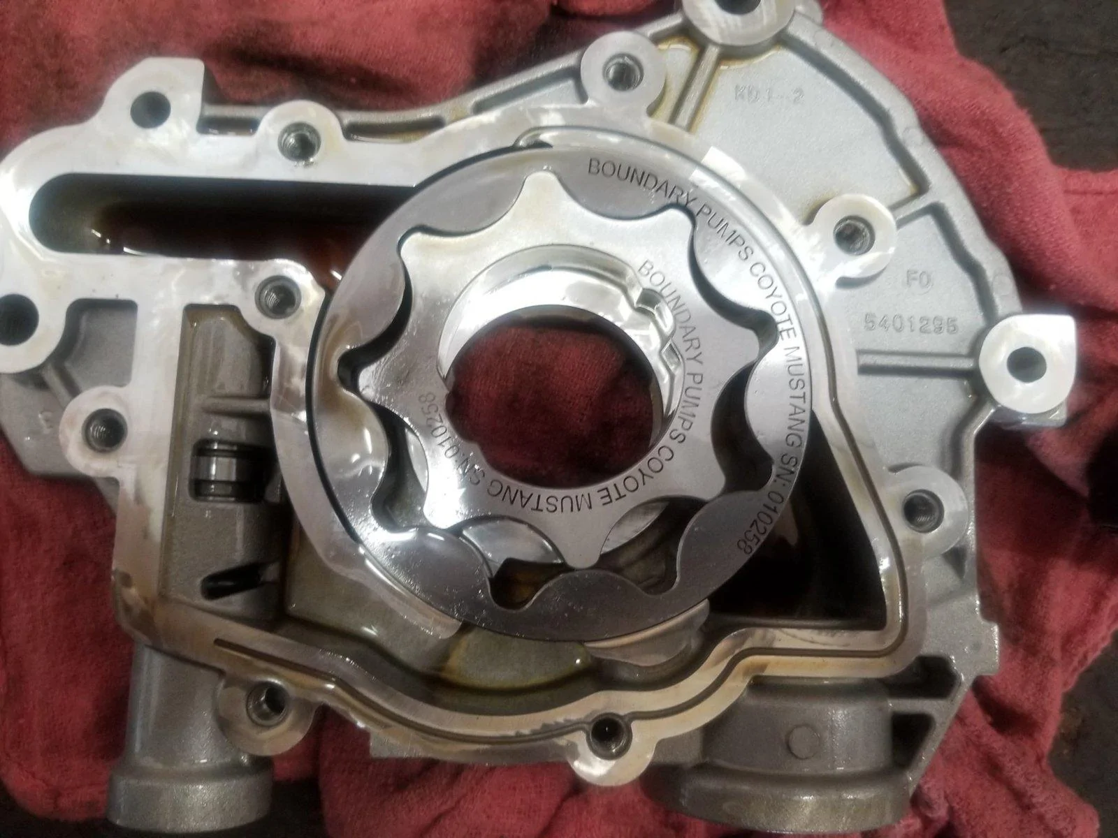

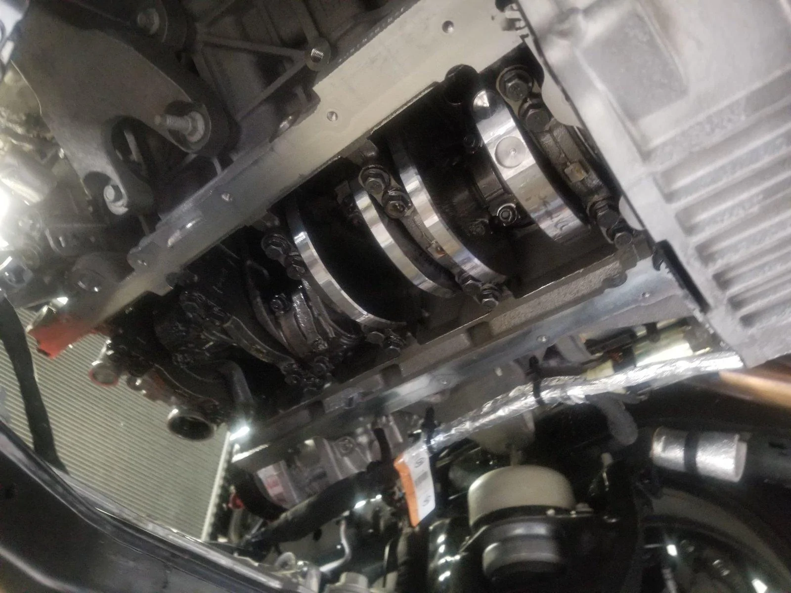

Here's mine while Anthony did my OPG's. We also bought a brand new oil pan which was only $132 in case the stock one somehow distorted from original install and heat cycles. It was a very cheap thing to do and know that I had a new OP installed.
