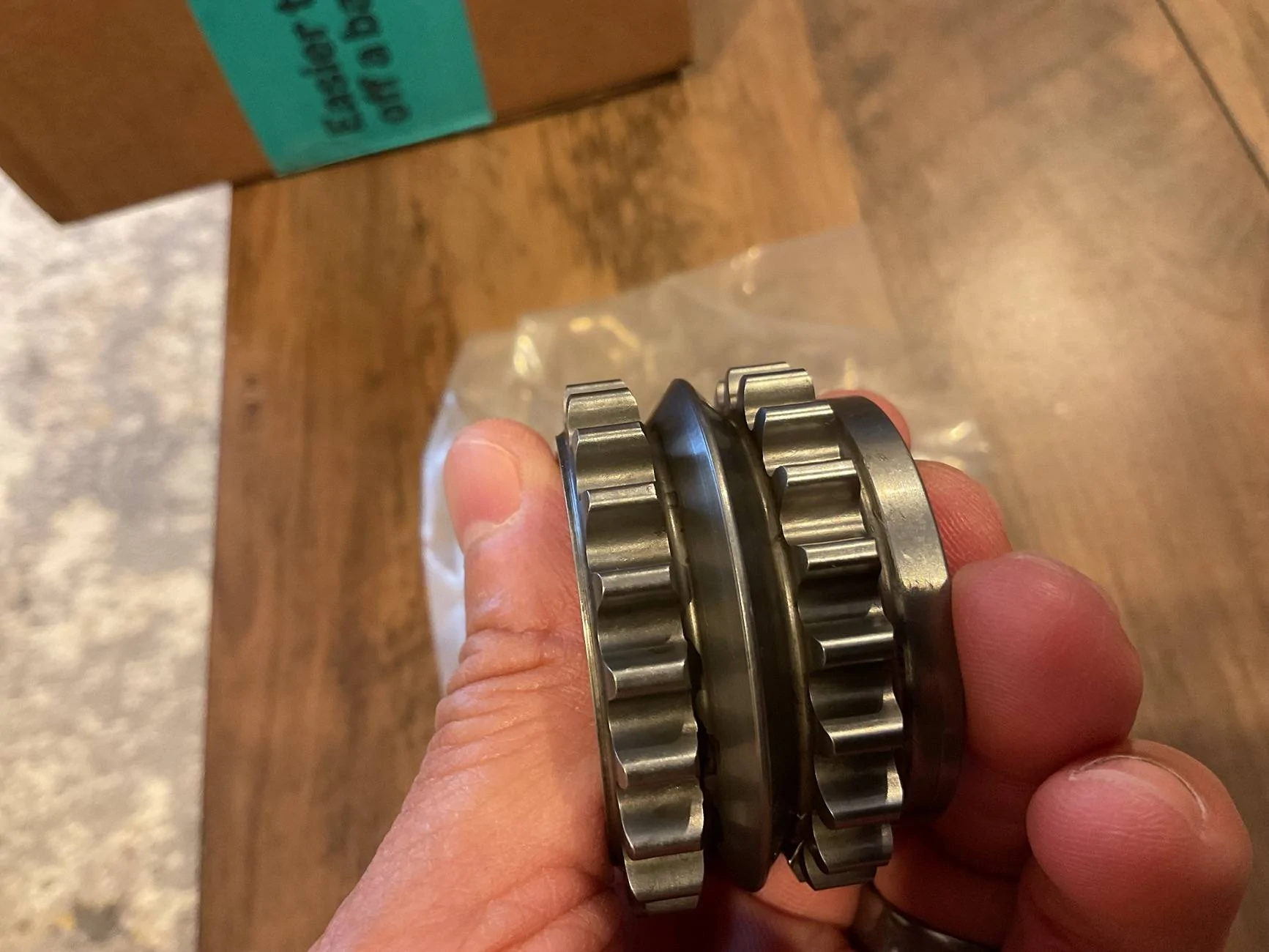

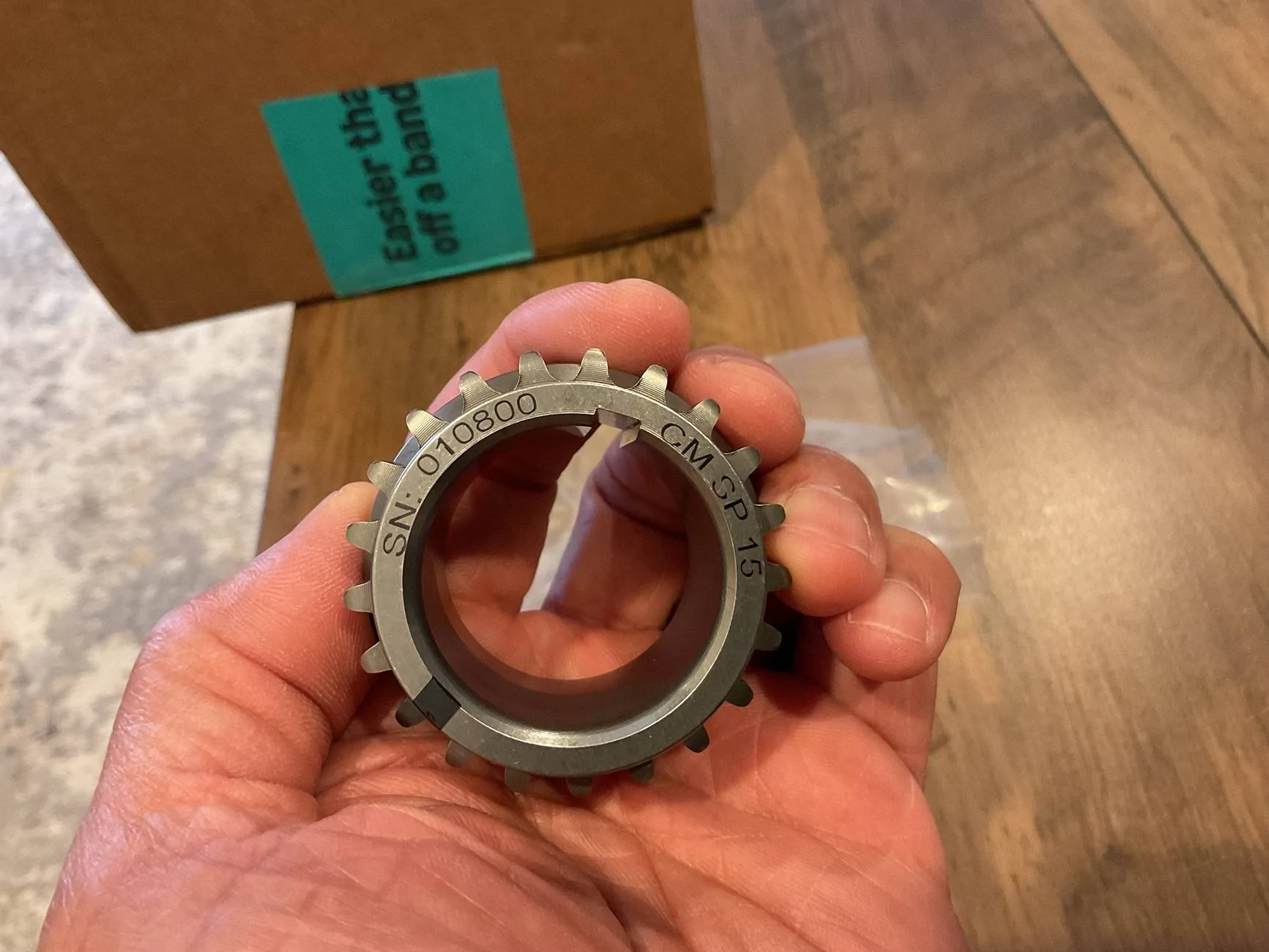

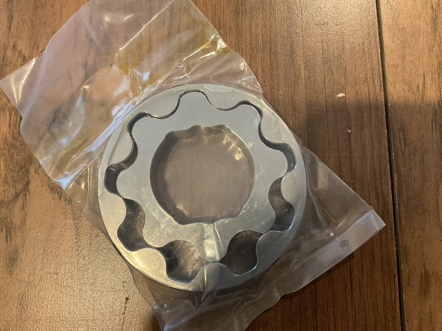

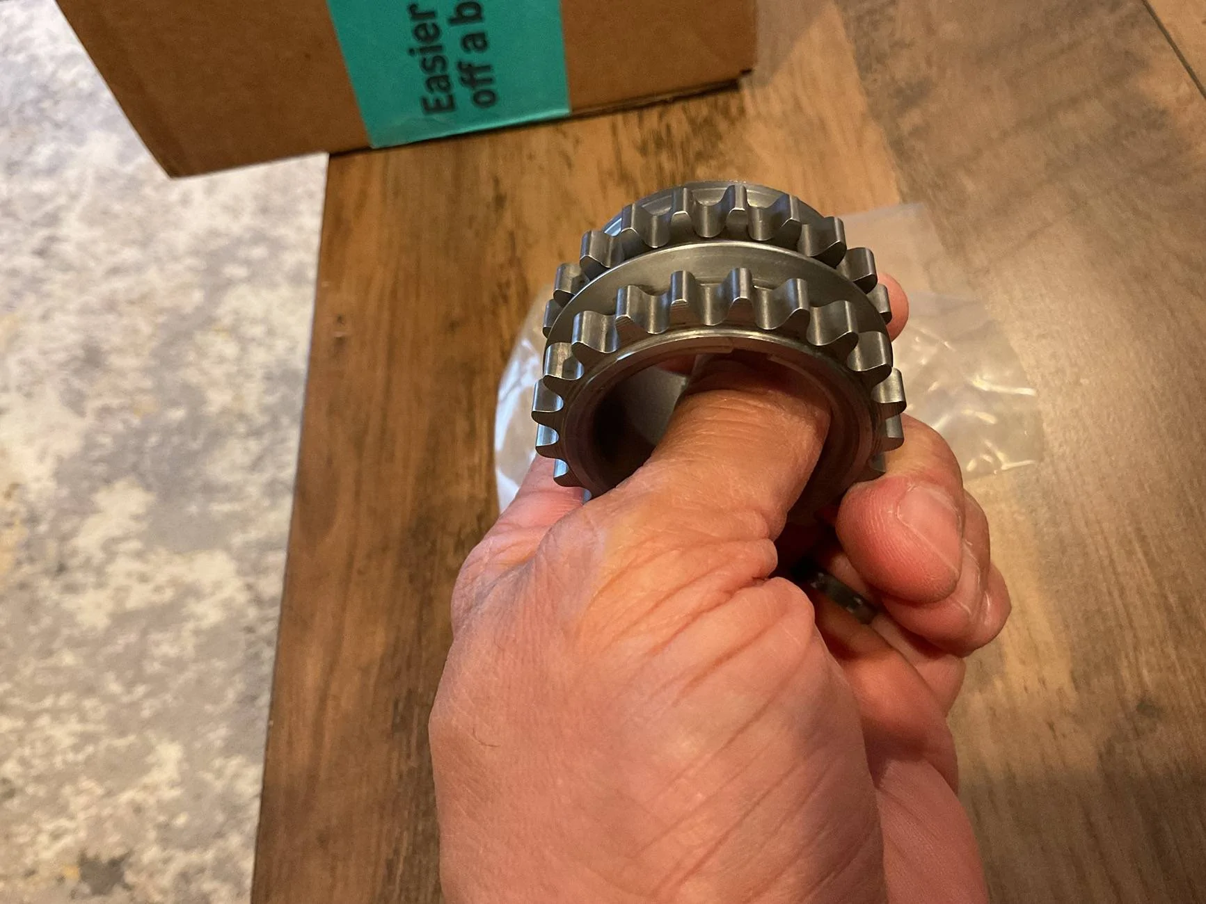

While billet OPGs are strong, an even bigger concern that is often overlooked is adequate clearance on the Gerotor gears. I’ve seen pics of many with way too much clearance which will surely lead to low oil pressure and oil starvation.

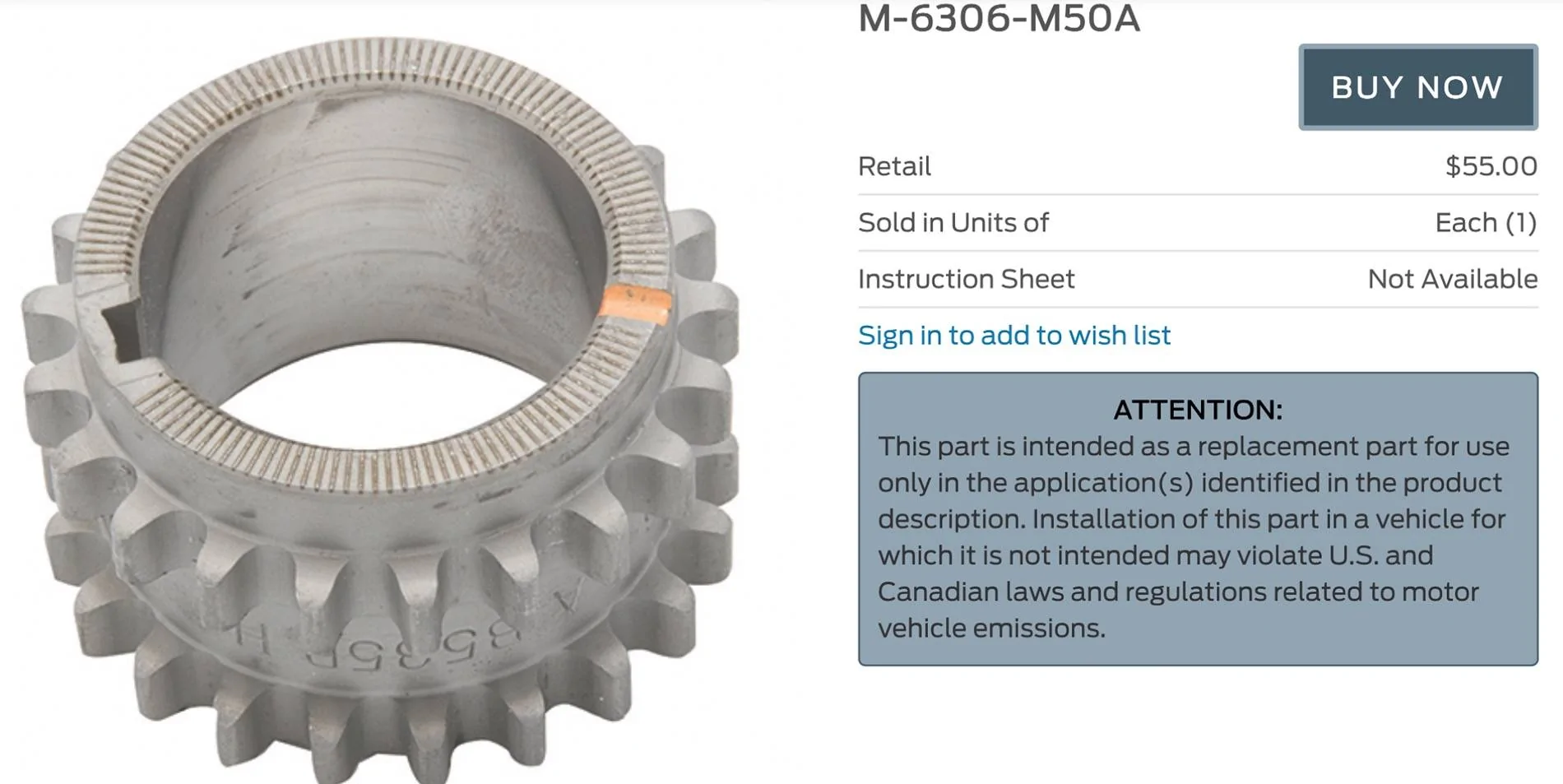

@OhioHPMach1 apparently, forged offerings are even stronger than billet. Ford Racing crank sprockets are said to be made of forged steel. This may be something to bear in mind when deciding on a brand. I’m not aware of any forged OPG offerings and believe they’re all billet, regardless of the brand.
Here are a few pics for reference. Notice the Ford Racing CS doesn’t have the raised center section like my Livernois CS. I’m not sure what the purpose is for this design change, but it’s very apparent. Maybe someone with more knowledge can enlighten us.
The Livernois OPGs also seem to have very tight tolerances, unlike some of the other brands I’ve seen.
