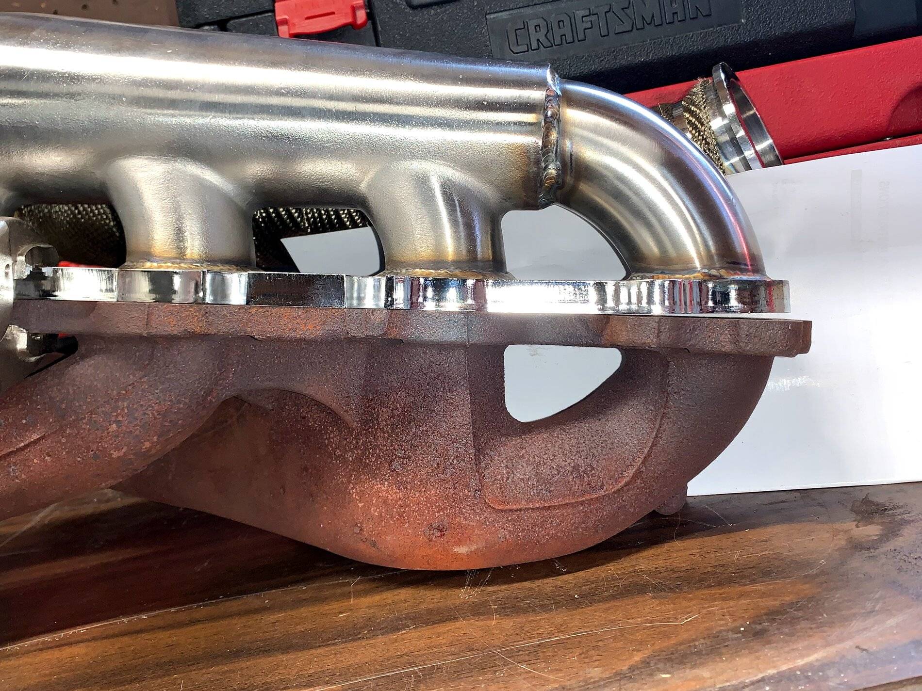

Mine were warped by more than a 1/4 inch... the replacement was even warped.
Yeah, you'd have to get that one planed unfortunately. That's the first thing I'm going to check before I get it ceramic coated.
you'd have to remove too much material though.
No pride in their product !
Pity as on3 could do well with just a bit more effort.
Yeah, it's a crapshoot at this price point. If you get manifolds that fit well, you're gold with the single kit. The rest of it is much easier to install than the twin kit. I definitely have my concerns with some of the stuff but I also didn't want to spend $12,000 on a Hellion twin top mount.
You should be able to get that milled flat without issue. Plus with the MLS gaskets, you'll be fine.
Nah that one was too far gone. They swapped it out. I have a mill but that one after milling would have left no more flange.

Flanges on mine were good. I was able to lay a yardstick flat on both and put both manifolds on each other with no visible gaps at all. Both flat. I sent the hot side parts and turbine housing to get ceramic coated in black.
