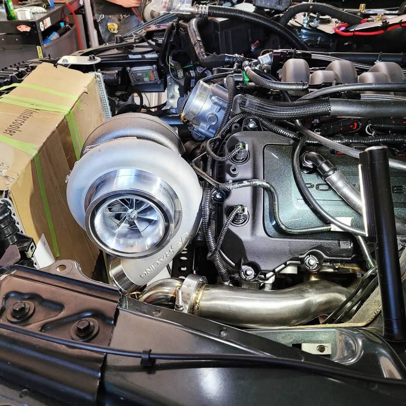

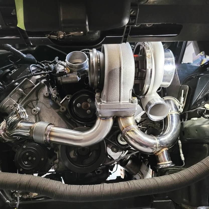

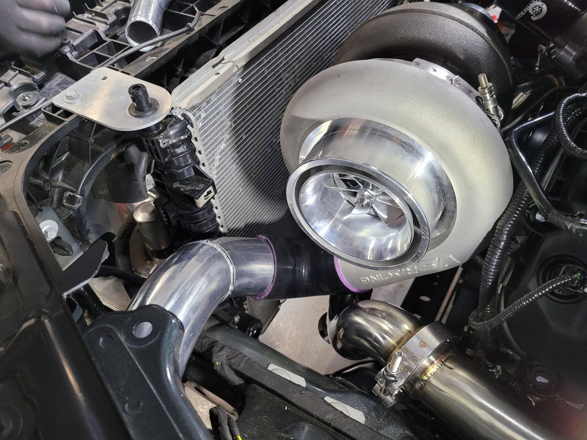

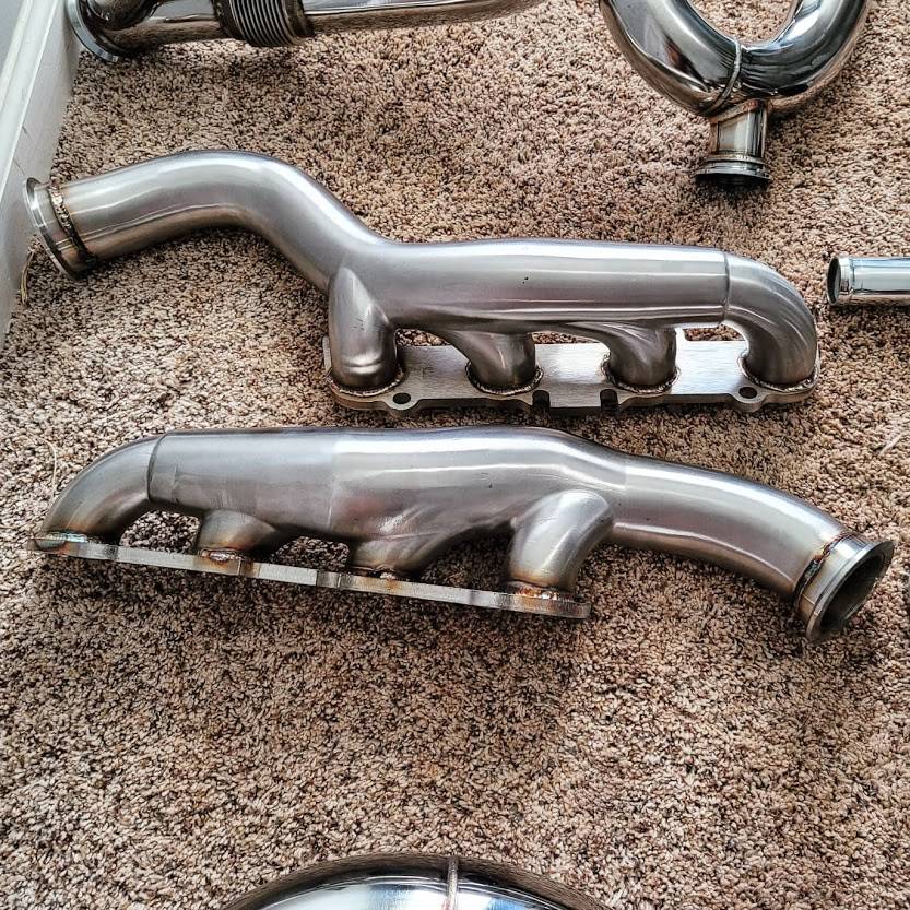

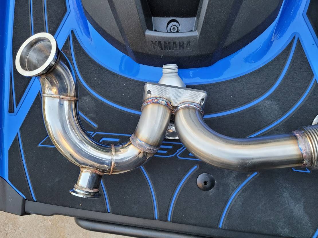

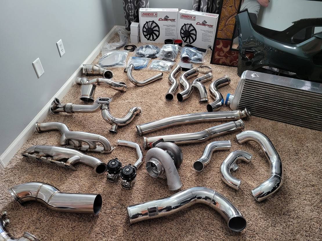

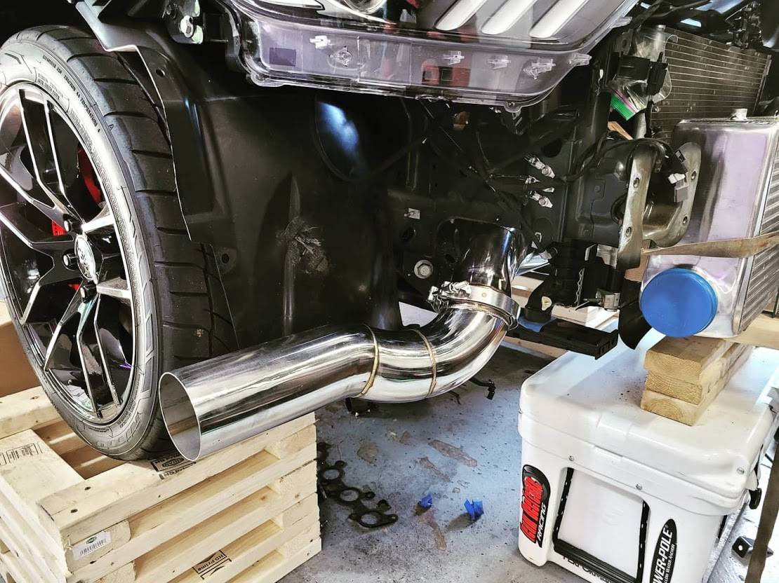

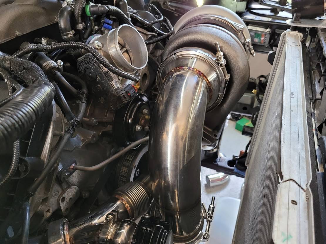

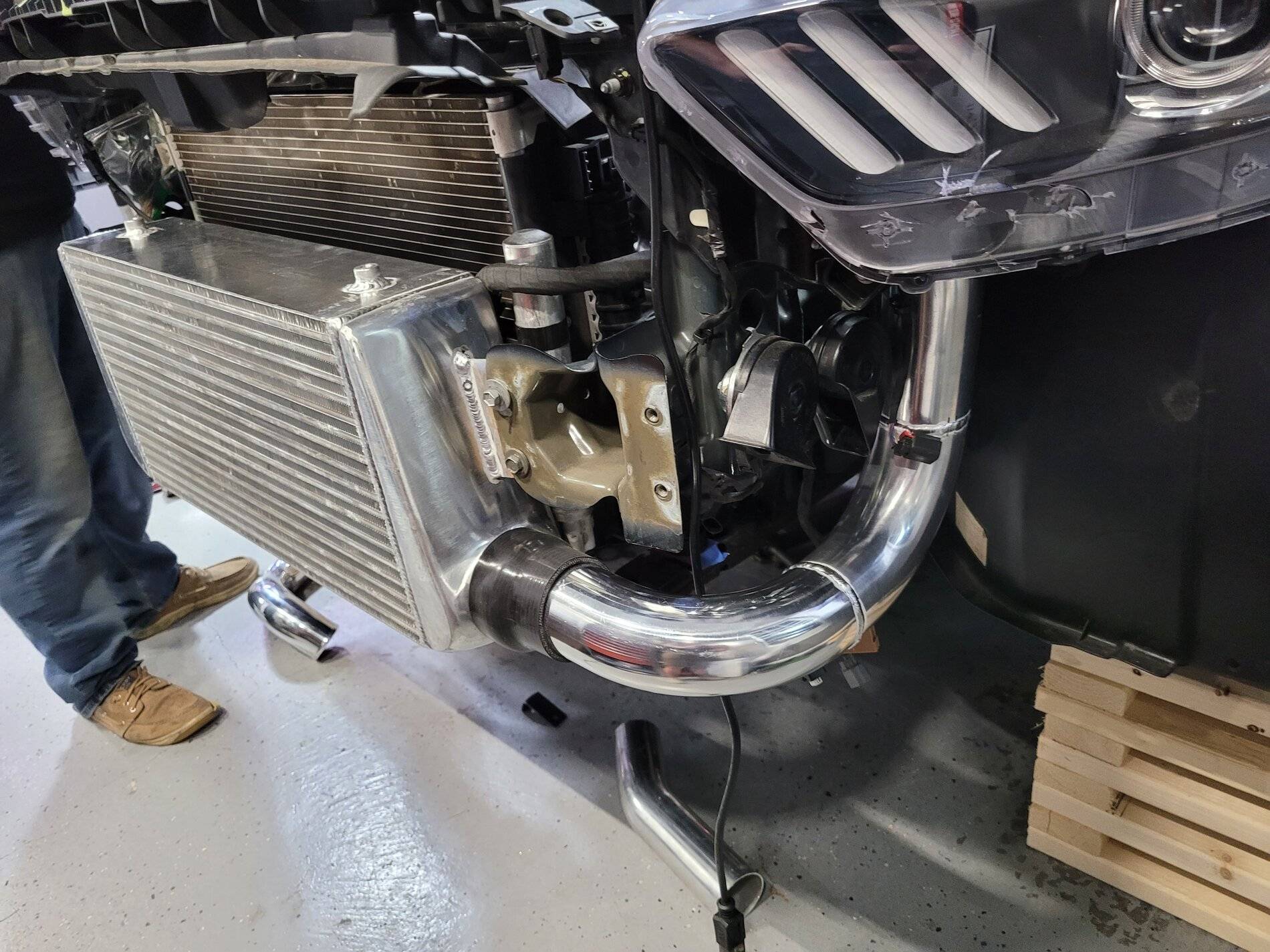

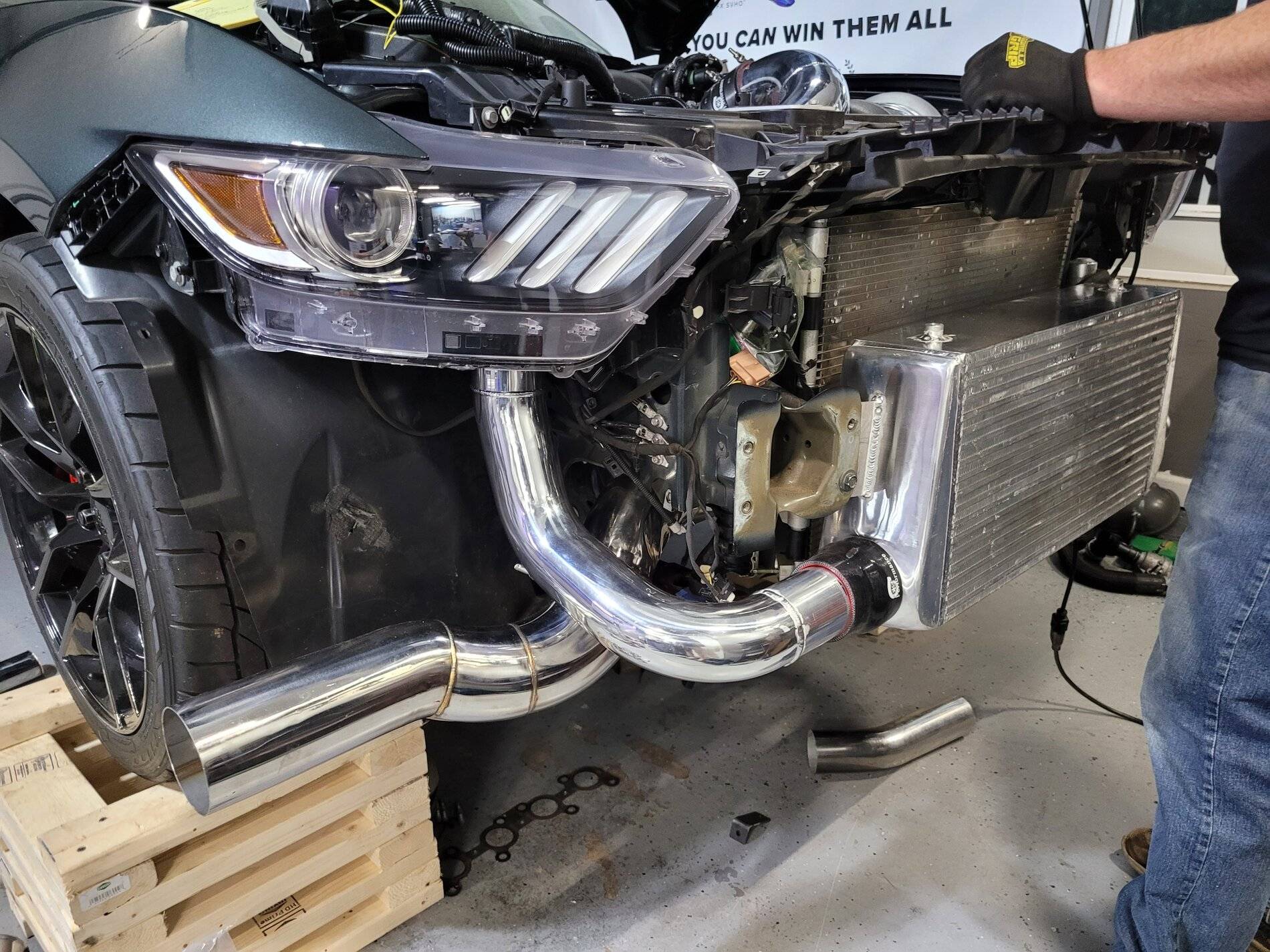

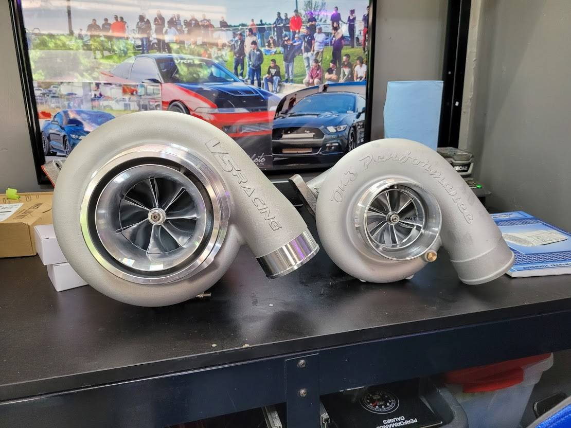

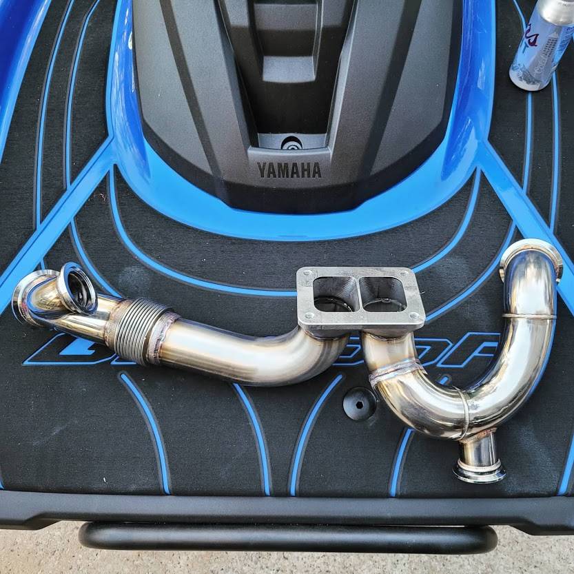

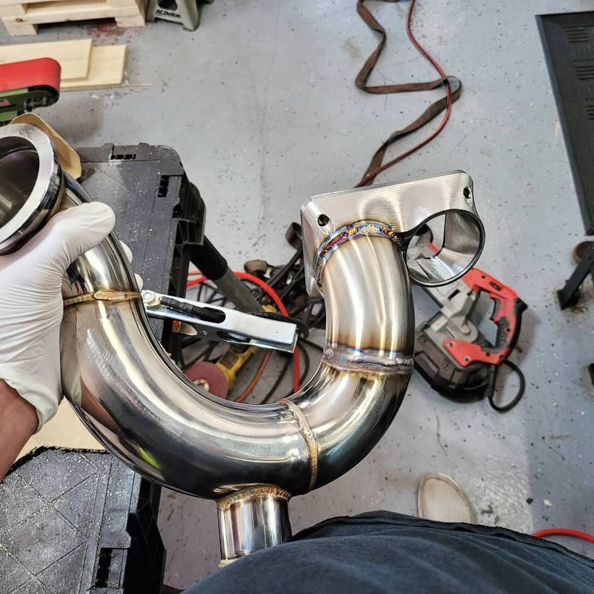

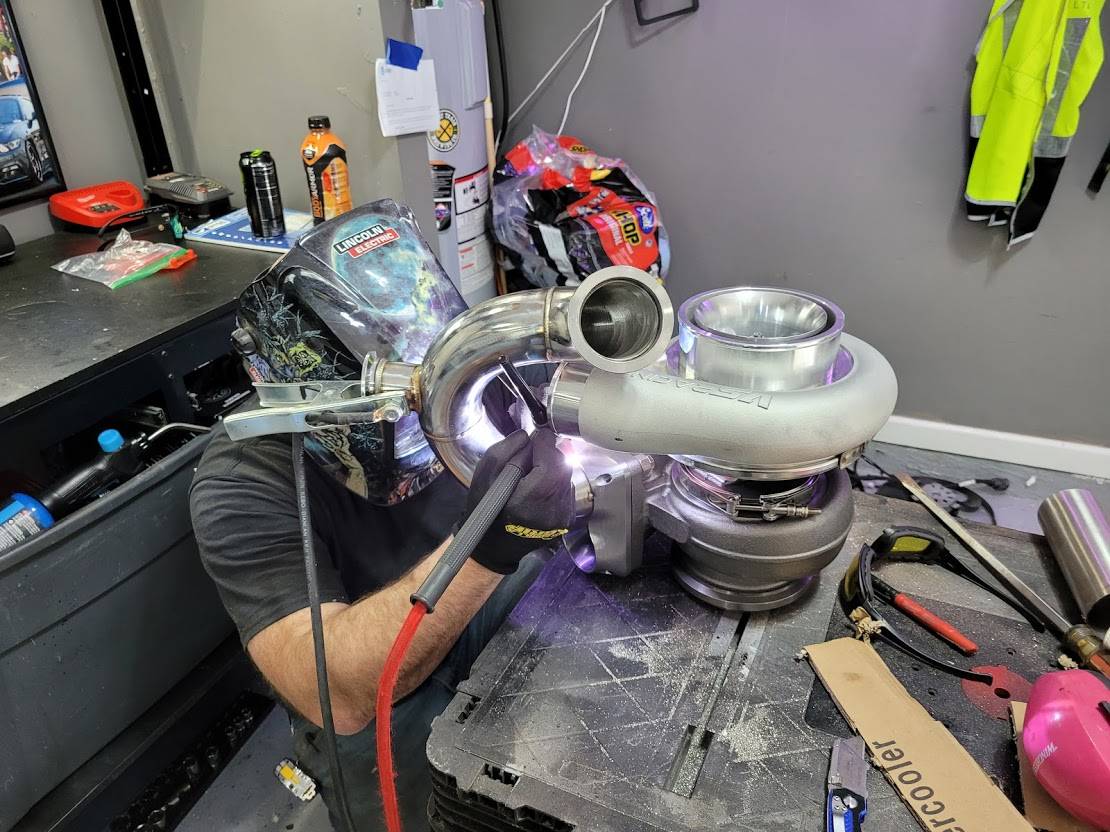

Received my new On3 kit a few weeks back, while it is a nice kit for those wanting to make 600-800whp as it comes it simply is not enough for my setup. Instead we decided to use basically the manifolds and as much of the kit as possible and transform it into a 1500hp capable setup utilizing a VSR 8896 Turbo with a T6 1.32 housing. First thing first we chopped off the T4 flange and fabbed on a T6 flange, We braced the setup as well. The downpipe is changed drastically from the tiny 3" provided to a pretty massive 5"-4" downpipe with some of the provided bumper exit piping still used, Also the intercooler piping from the turbo to the 5inch intercooler was changed drastically as well and enlarged... I have big hopes for this kit as I believe we have created a 7 sec setup for less than $5500 all in granted with a good fabricator and several hours of modification to the original kit.
Heres a few pics, Enjoy.

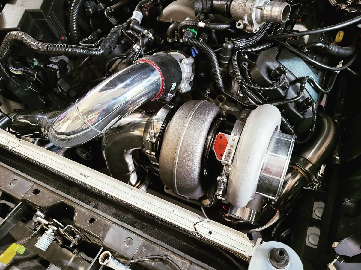

Little more progress
