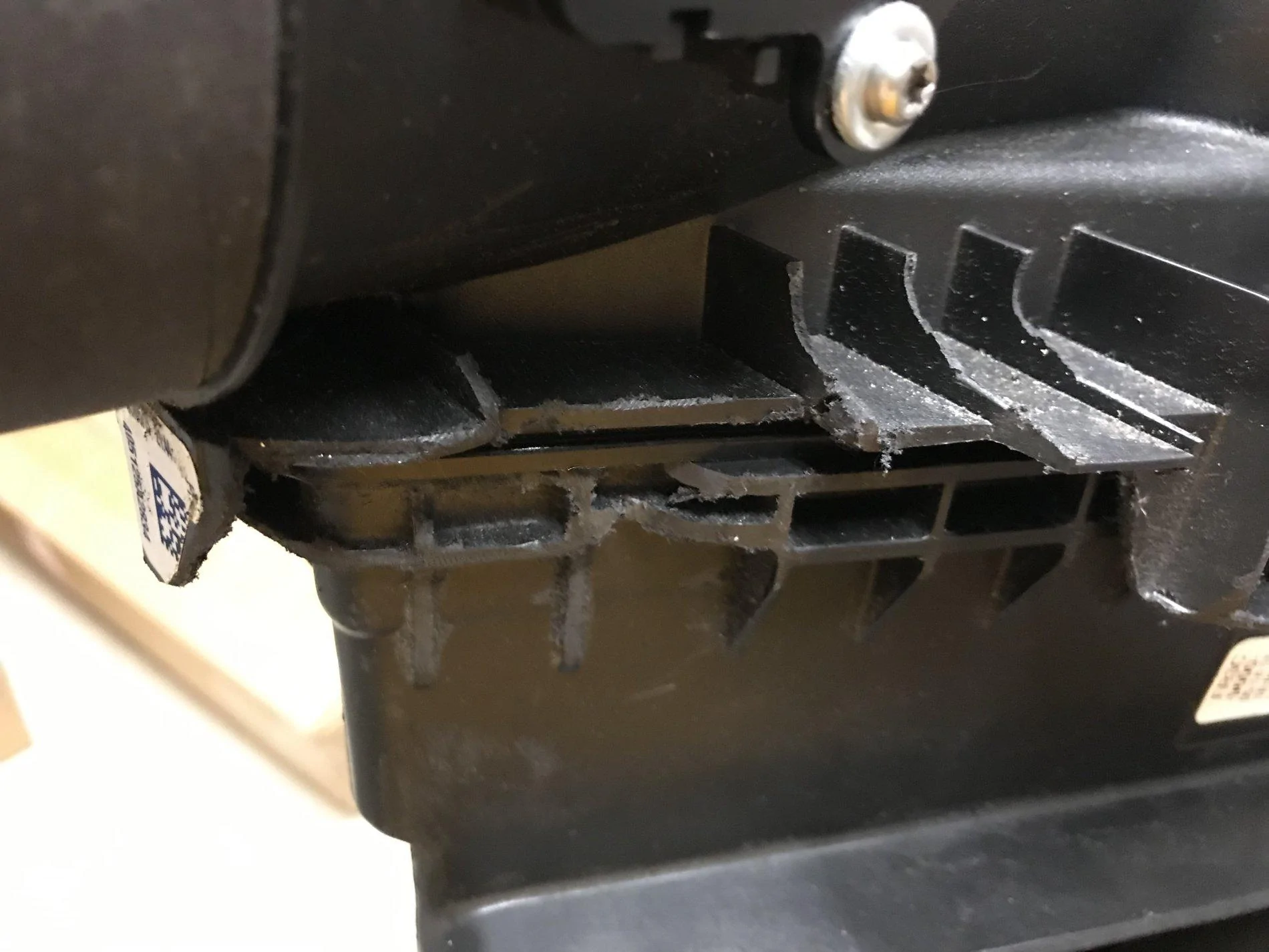

As far as airbox options go, I've seen people with the stock air box or the JLT style one with the tube. I've also seen people run a honeycomb on the blower itself or trim the fan shroud slightly and run a filter off of that.
Aside from the obvious power differences of the last two options, how much trimming of the stock airbox do you have to do? I saw someone with a Steeda setup and Vortech and that looked pretty interesting for a closed box setup. Do the IAT's of a more open version like the JLT really affect the performance versus a closed box with lower IAT's?
I currently have a JLT and of course I've seen some IAT's reach around 137 degrees on a hot day, but not much higher than that from idling. It recovers extremely fast. Wondering if it's similar to that with the JLT filter on the tube?
There’s not too much trimming. I think it took me about 30 minutes or so to get it just right. I’ve got the stock air box that I trimmed and used prior to switching to the jlt in my parts room. I’ll snag a pic of it when I get a chance and put it on here so you can see.
I did pick up 1 lb of boost when I switched from stock air box to jlt as measured by a mechanical gauge, so it’s an accurate reading in my opinion. It was a noticeable increase in power that I could feel before I did any data logging. You wouldn’t think 1 psi would make that big of a difference but it does. Especially seemed to pull harder in the 4000-6000 range. Some people say they get closer to 2 psi increase but I only saw 1.
As far as temp difference, I could go back and look at some logs but I feel like I would have remembered/noticed if it was significant. The shield that comes with the jlt does a pretty good job of blocking it off from the engine bay. I think that the increase in boost makes any minimal temp increase a non issue as far as performance goes, especially by the time you get through the intercooler. Hope that helped answer you questions, I’ll get that pic for you when I can.
That absolutely did, thanks! Seems like the cone style filter is the way to go with this setup.
