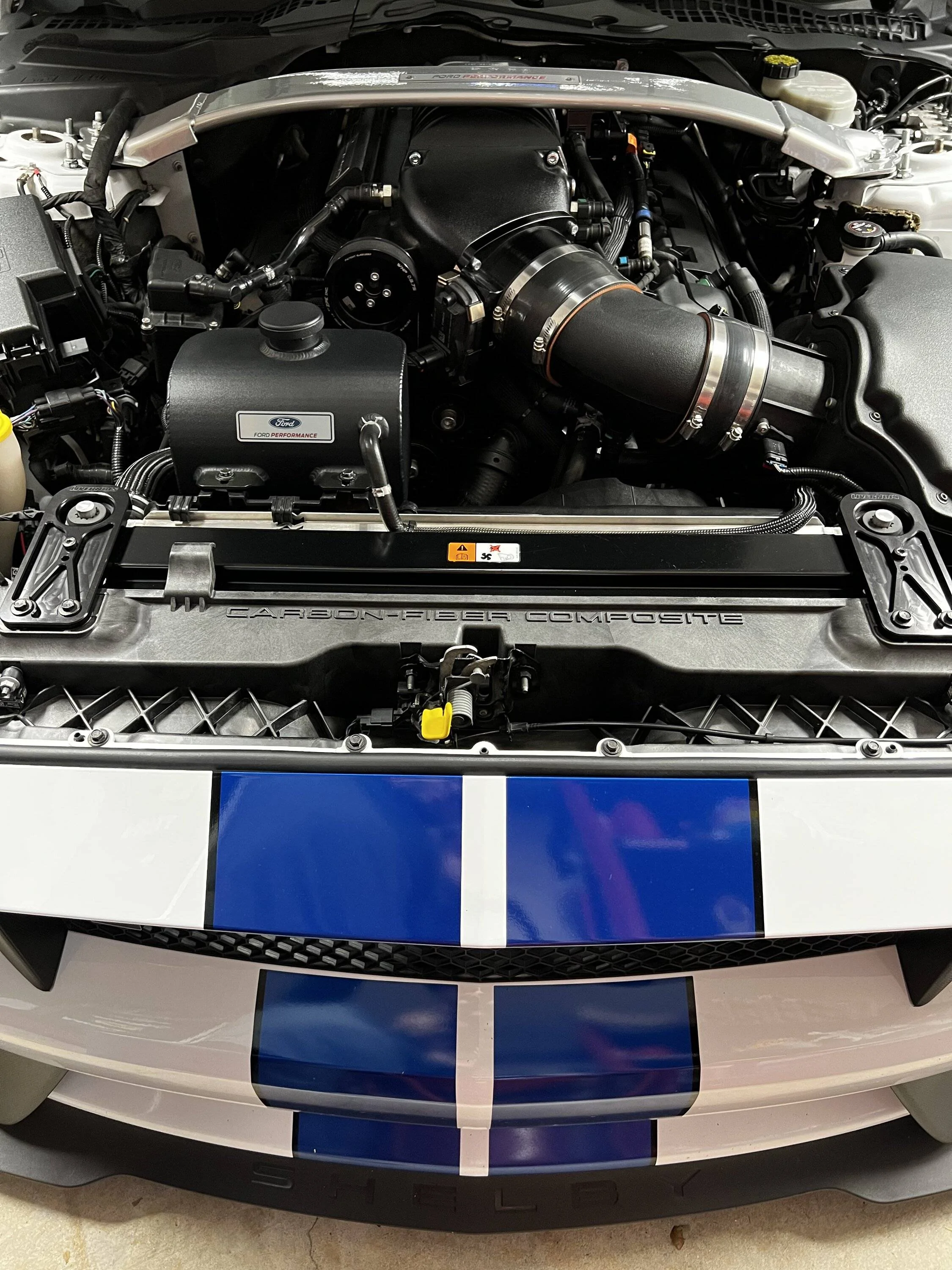

I went with a FatHouse tank. Well made, no issues. Add a Ford Performance badge for visual appeal.
Looks great. I had my Mishimoto powder coated gray and painted the Mishimoto letter yellow. It looks really good but the buyer shouldn't have to trouble shoot their product because their customer support sucks.

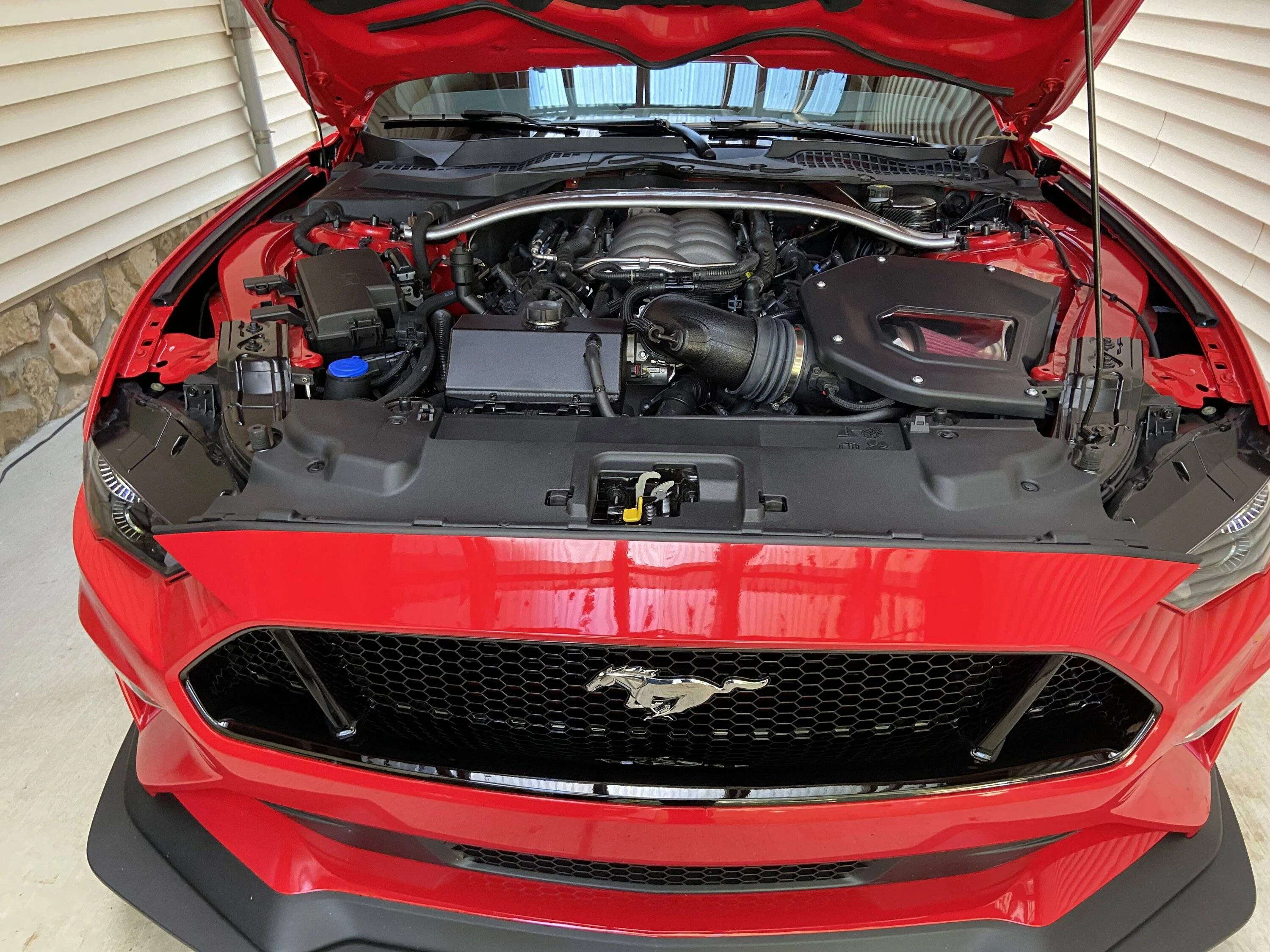

Steeda installed

If referring to the Steeda tank you're wrong about the capacity. It was measured before replaced.
It is odd that you found machine oil in the tank, and not saying it can not happen. I would think any oil would have been removed before the seems were welded?
