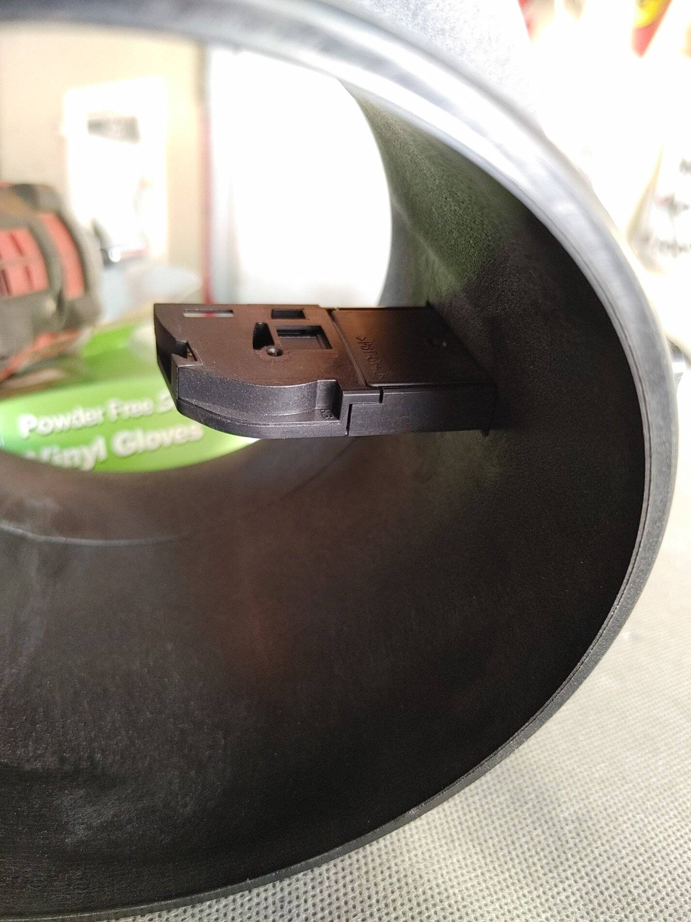

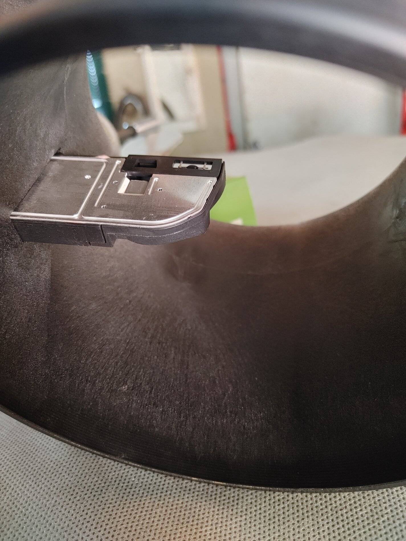

Could the oil possibly have already coated your MAF causing it to display a lower temp than the air actually is?
Just throwing ideas out there.
Gimmie 10 mins I'll check

Clean buddy
