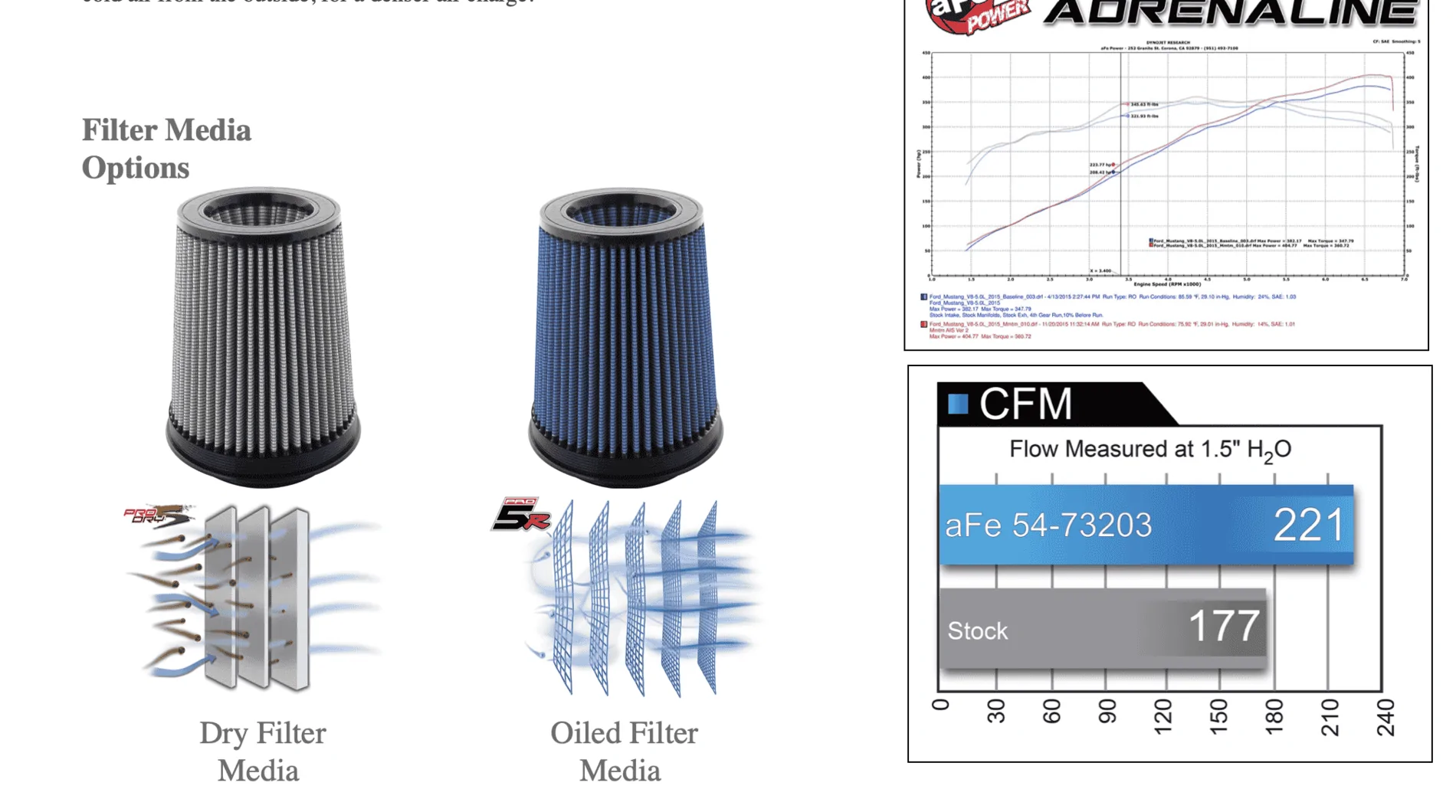

Heres the next brand equivalent, AFE page for info
https://afepower.com/2015-2016-ford-mustang-s550-performance-products
has both dry/wet filter comparison, looks like (their) dry is 3 layers, and oiled is 5 layers, as oiled lets more through, it needs more nets to catch those dust mites. they also offer a like 7 layer PRO but its only recommended for like the desert.

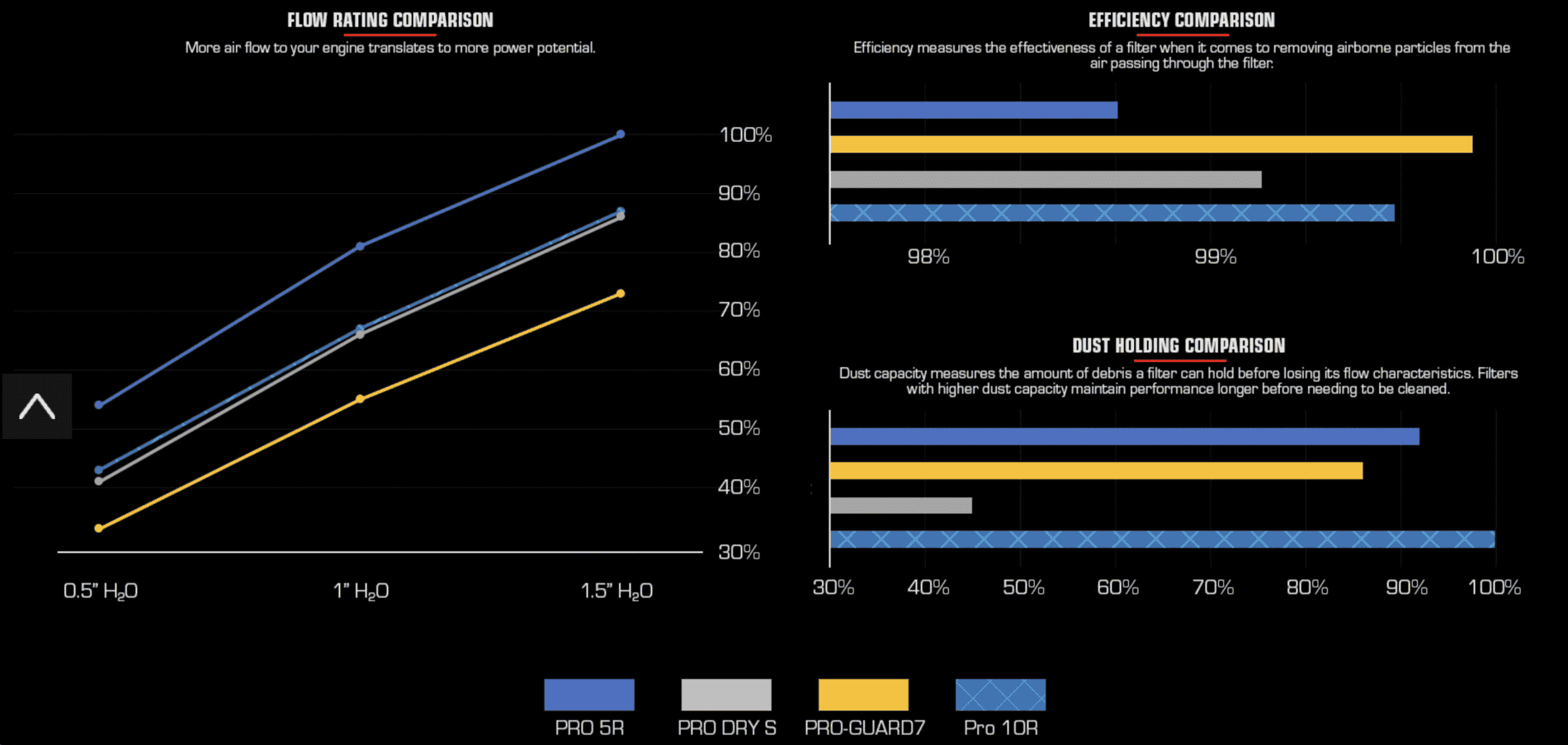

edit here's all the filter types they have. - you can also have custom ones made with diff layers etc
https://afepower.com/air-filter-media

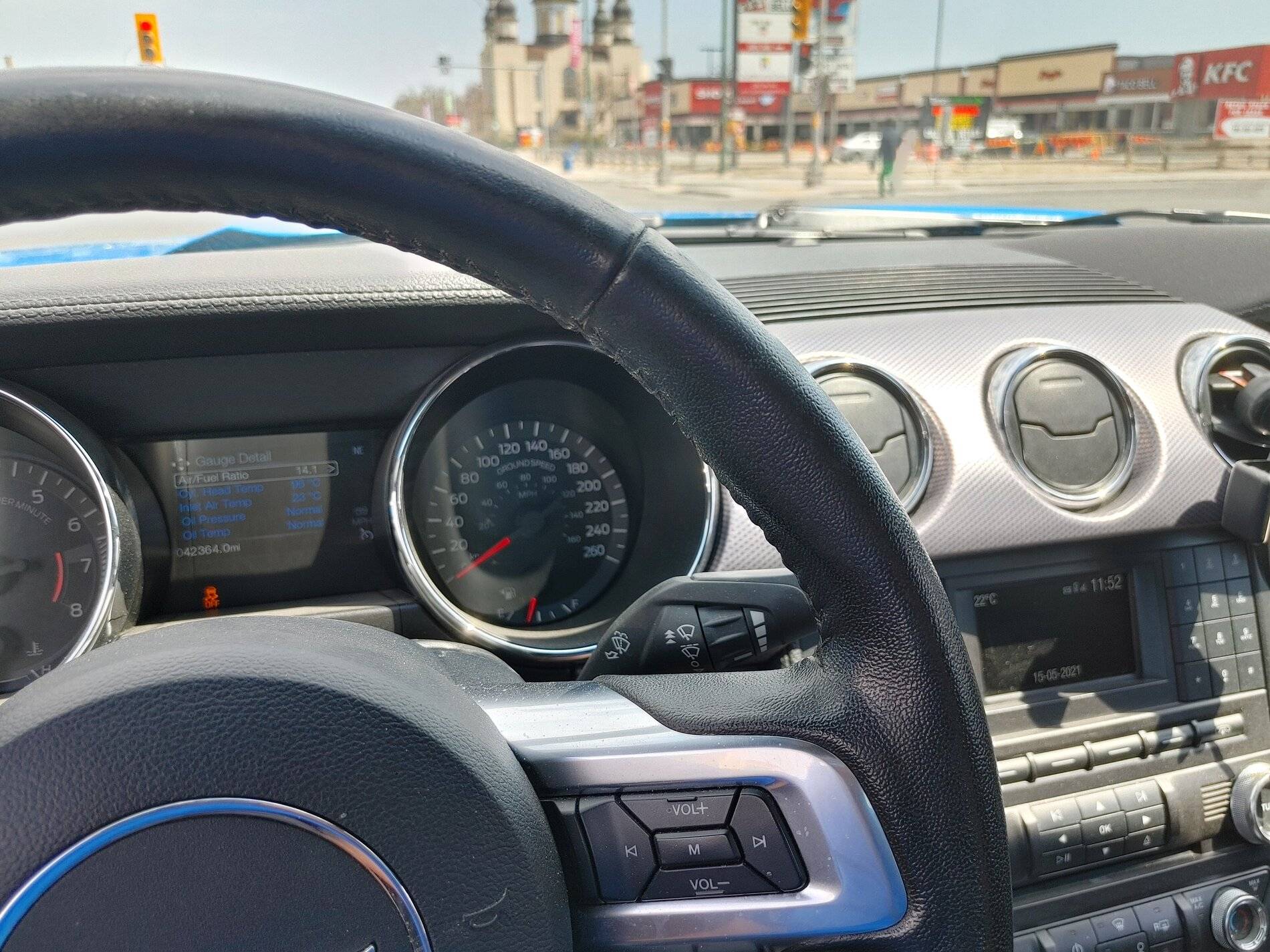

Here you can see my IAT at 23c Ambient at 22c. This is in the city. Switched from dry to oiled. Never seen that with the dry filter.

Are you saying the dry filter was not displaying the IAT temp?

It was. Much higher than a oiled one. City driving it was always 10 above ambient, waiting at a light rose quickly, moderate rate to drop. Oiled filter it's been 1-3 about ambient, waiting at a light temps rose a a moderate rate, once moving cool very quickly. It's repeatable.

One function of oil is cooling ? I wounder that is interesting..
You being able to repeat it, is telling .

Every little bit helps. Especially from light to light haha.
