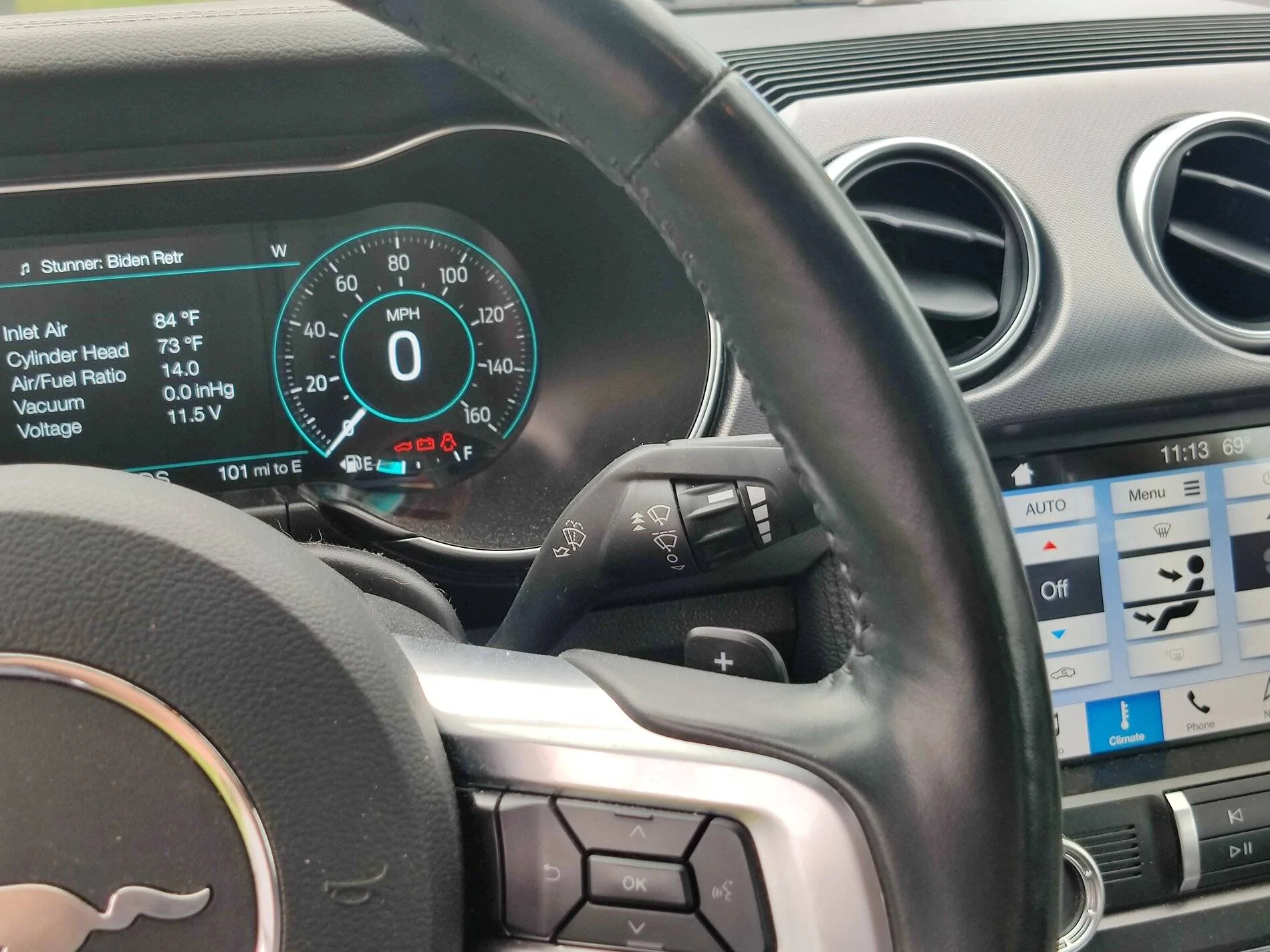

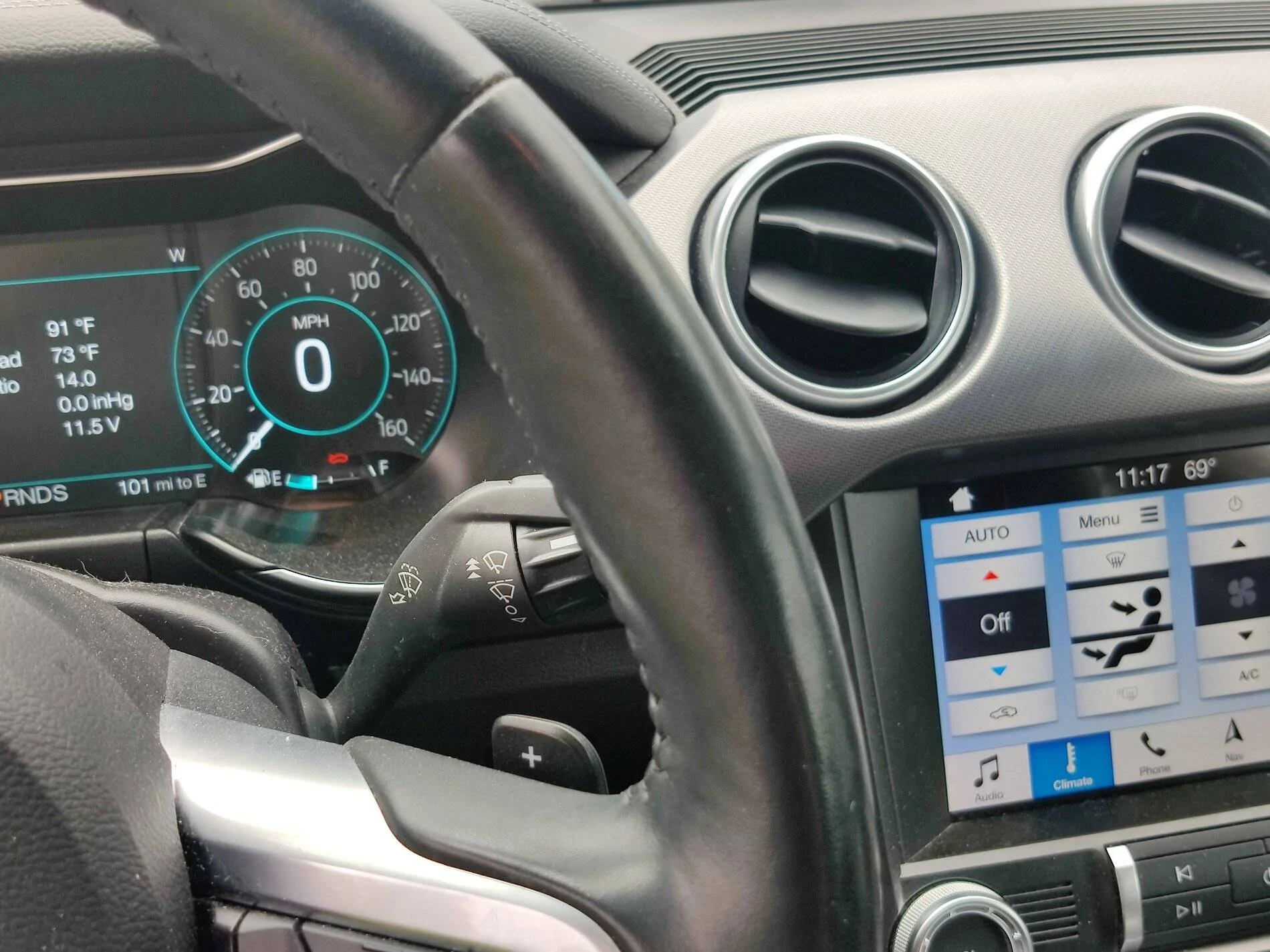

Did you know if you just go out to your car after it's been sitting for 12+hours and turn on the acc power, the IAT will increase? Probably cause the hot wire MAF is right next to the tempature sensor and the heat has no where else to go. Ford should probably redesign this. Or an intake manufacture could come up with some thing using a break out harness.

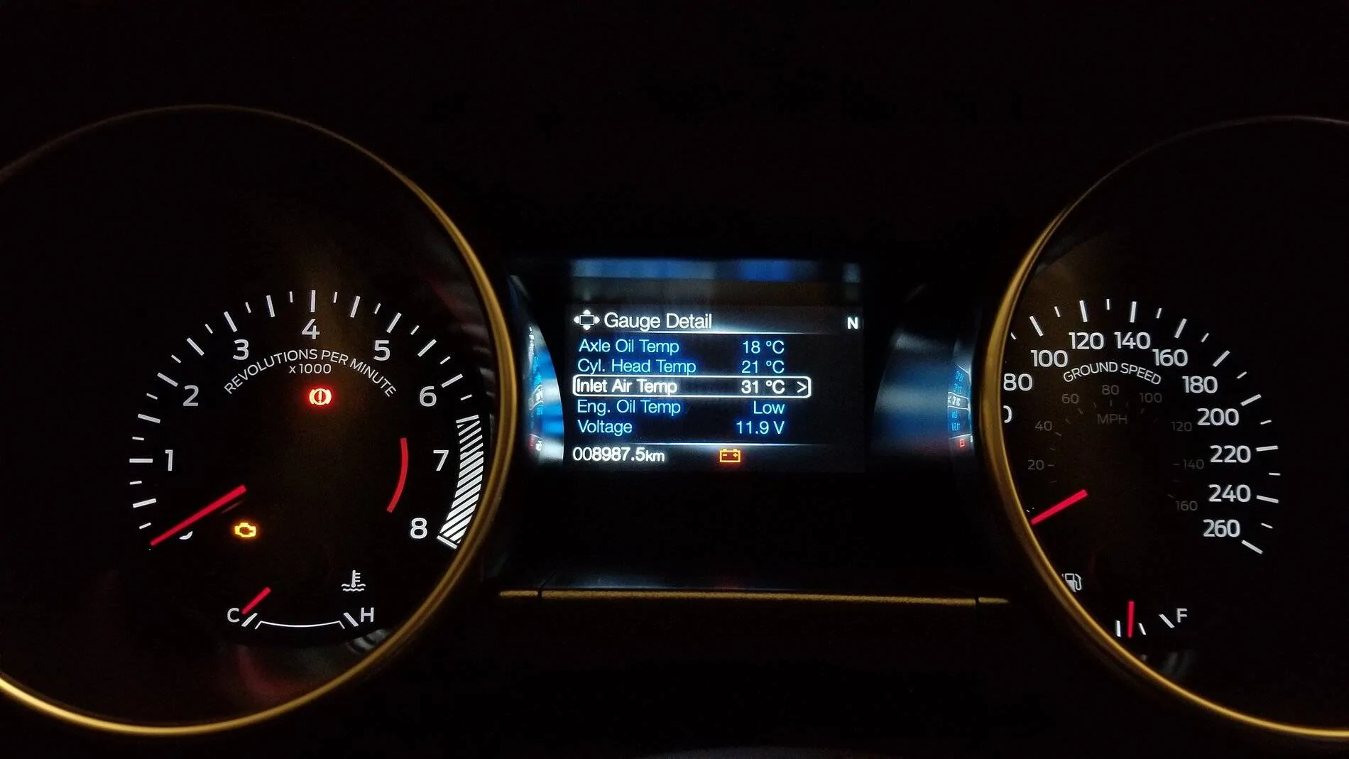

Yes. I noticed the same thing. Car was sitting about 24hrs. Ambient temperature in the garage was 18 C all night. Pushed the start button and AIT is showing 31 C. When the car is moving it is between 2 and 4 deg C higher than ambient. I have the GT350 style open top airbox.
