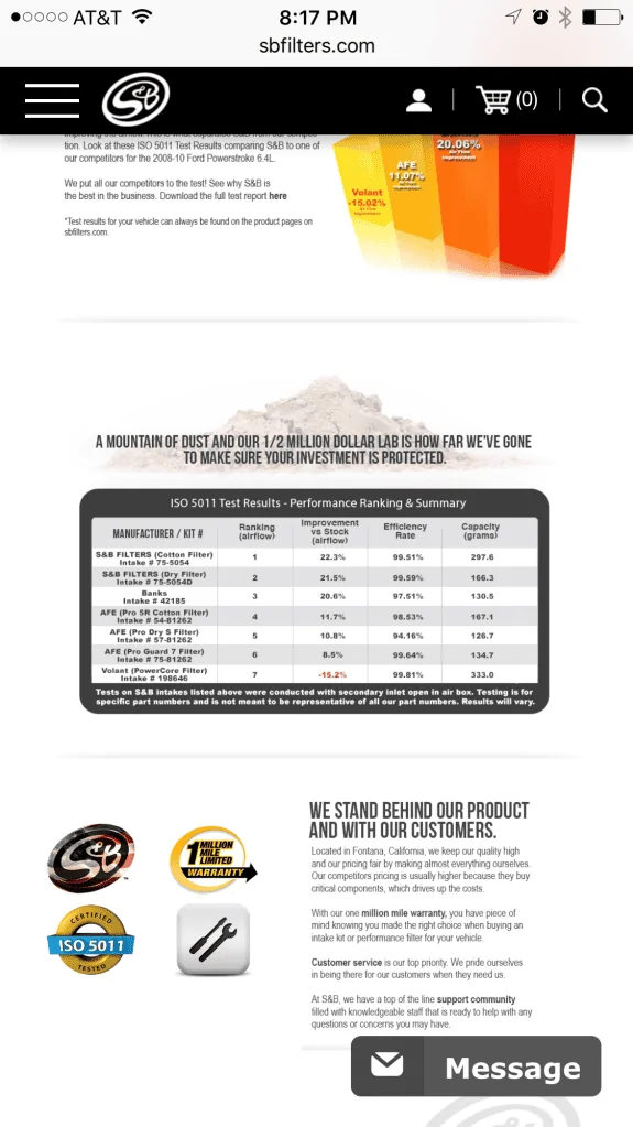

That's odd because often times oiled filters flow a bit more than dry filters. Also they tend to hold more dirt than dry filters. AFE oiled vs dry and S&B oiled vs dry.

What about them letting dirt into your cylinders? That was kind of the reason I started this thread. Curious if people with sports cars and Ford V8s are as concerned as the truck guys with Cummins engines?
Finally someone who's asking the right question. Everyone obsesses over oiled vs dry and MAF sensors getting fouled, but no one seems to be concerned at how well drop in filters actually filter. If you do some research you'll find K&N filters just aren't good at filtering. One study I read showed they're actually the worst performing aftermarket filter on the market in terms of stopping dirt.
Bottom line is that the OEM filter is going to do the best job of filtering. But if you want something that performs a little better go with a quality dry filter like AEM. :thumbsup:
