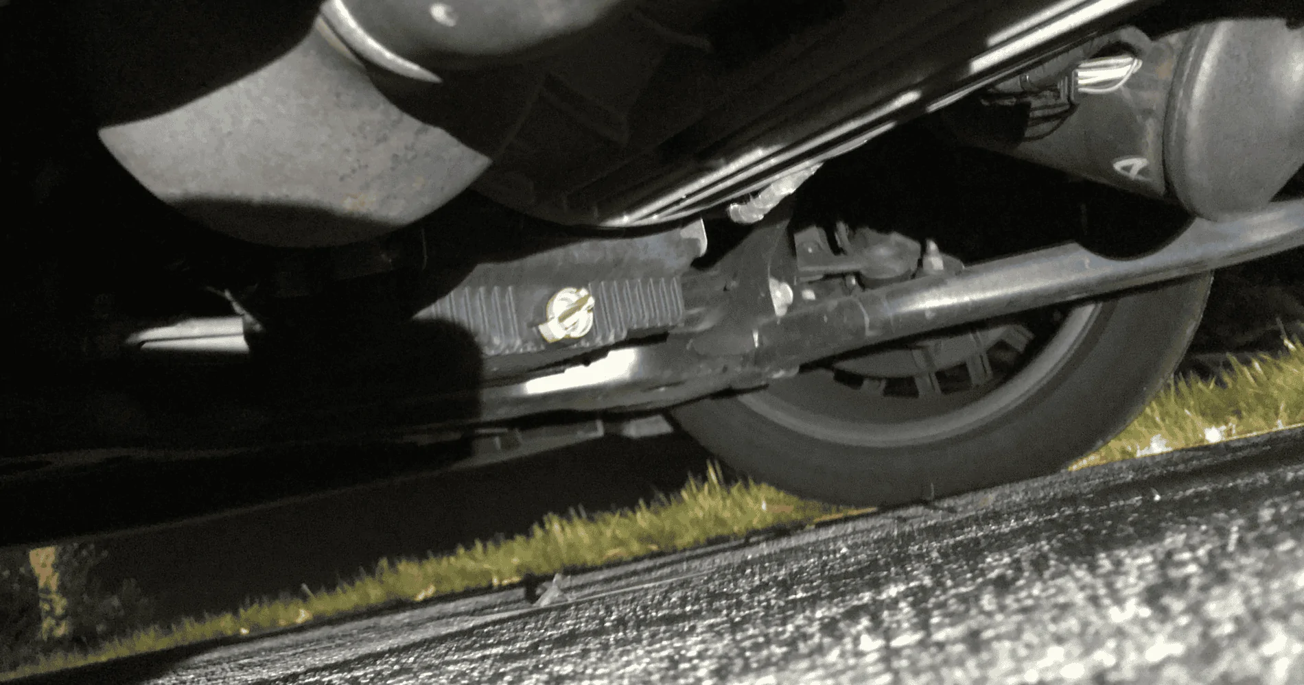

This thread was freaking me out a little as I tightened up the oil plug a little tough ( but not to tough ) and if it was plastic I could of easily stripped it.
Not a chance. It's plastic AF and it cams into place, not threaded in the traditional sense. This is my 2018:
Thanks for that pic and that puts my mind at ease. So much plastic on modern cars Yowzer
