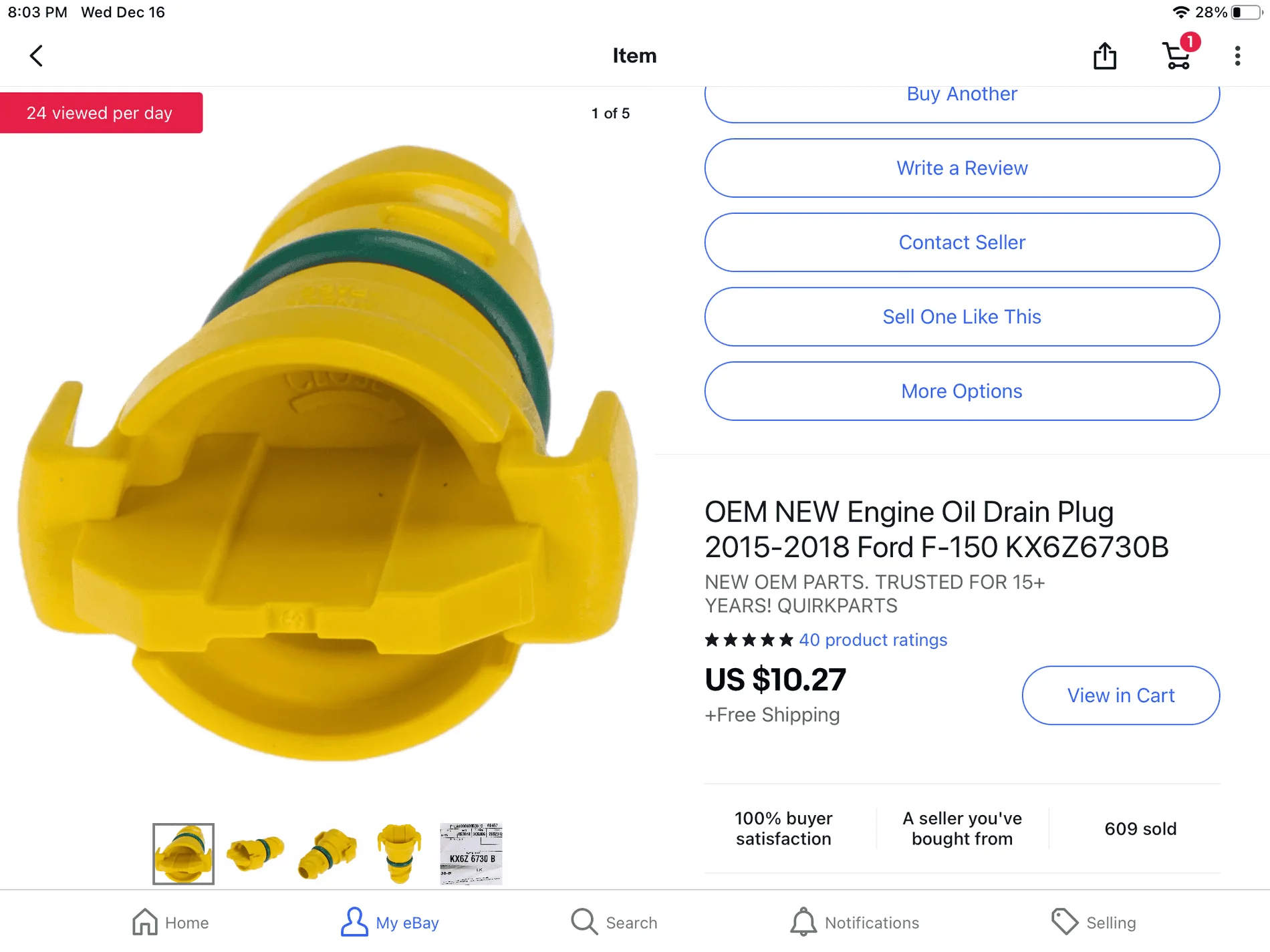

Do you know what the part # is for the plug? I'm having the damnedest time finding it.

The best thing to do in those cases is get under the car and investigate. The majority of times it's spilled oil, and not an actual leak, but the only way to tell is to get under there, clean everything all around, and see if it leaks again. Checking oil level should reveal if there's a real leak or not. As far as plugs, I don't trust the metal ones, but I treat the stock one as one-time use. If somebody finds the exact same Butyl O-ring, I'd only replace the O-ring, but so far nobody has posted such finding. So I'm going to replace the entire plug. Last time eBay conned me and sent me an aftermarket 'OEM like' Dorman plug, which has held fine so far, but have a genuine OEM one (with the square hole) waiting for next oil change. Good luck.

UPDATE: I used Mr. Old Racer's factory plug and so far, so good. Interestingly, the washer on his plug seemed larger than the one on mine, which is the original stock piece. Now I will use new plugs w/ every oil change.
