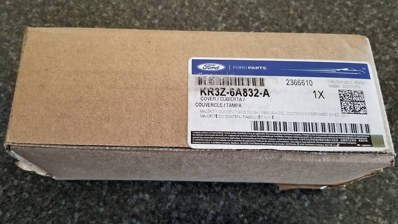

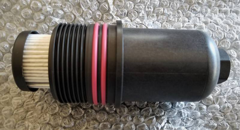

Your local dealer can order you a new housing. Which begs the question....is the car sitting, with the filter uninstalled because of your damaged housing or did you reuse it in conjunction with a new filter?
This is what you need to order...
Comes with a new filter and housing...
My guy says they are on national back order with no release date....

Just tried to order one for a 2019 GT350 and was told this: "Sadly, to get that on the GT350, you would have to buy it with the adapter. The canister portion is not sold separately."
Adapter--KR3Z-6881-C 543.20$ (no way!)
I have a hard time believing that. I sent them back the info on the GT500 canister and asked what the difference is. Waiting for a response.
Edit...response: "My apologies. Our catalog is actually incorrect! It shows the standard GT350 one. By build sheet it would it did spit out the correct number of KR3Z6A832A and run 56.28$. It would take us 3-4 days to get one here."

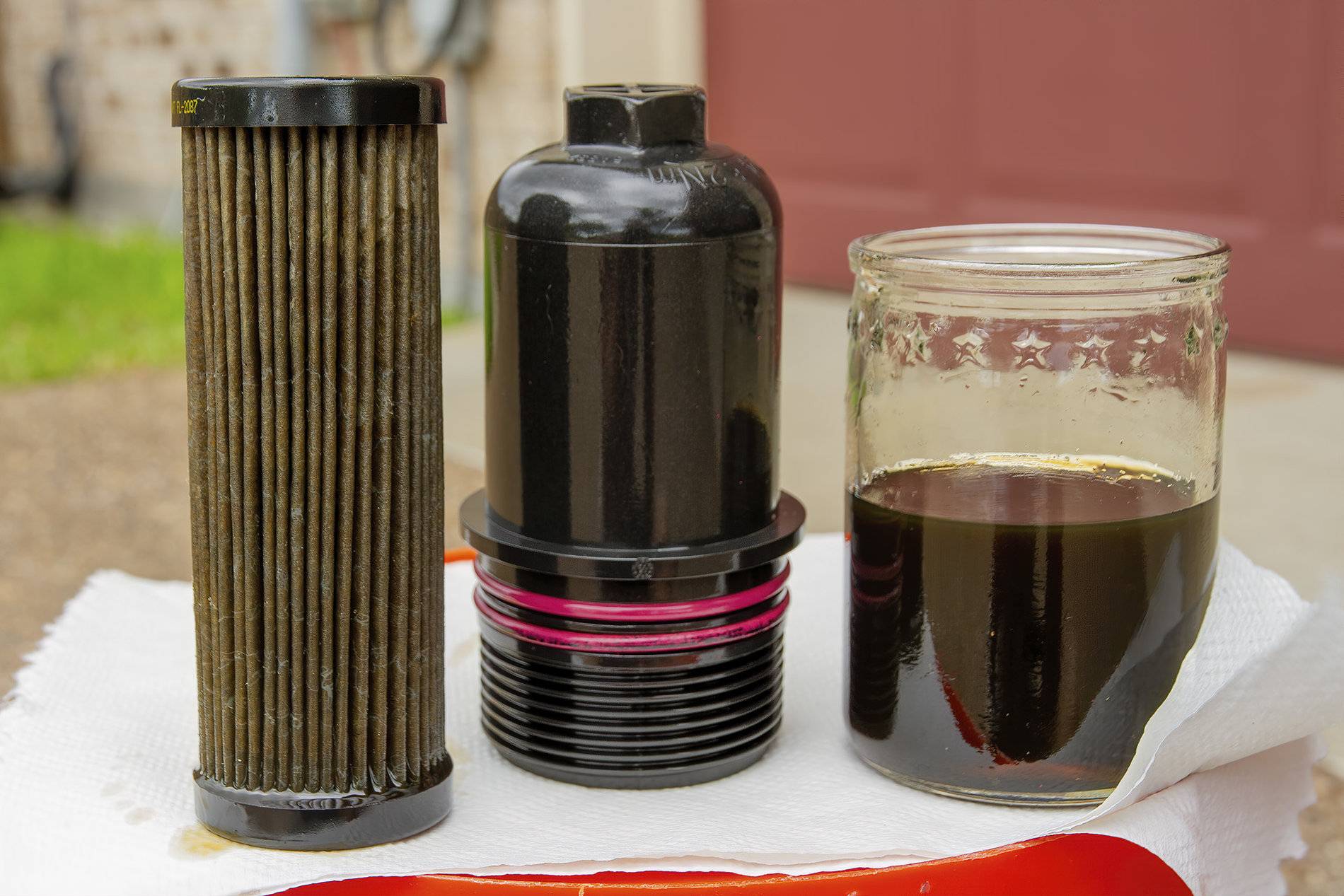

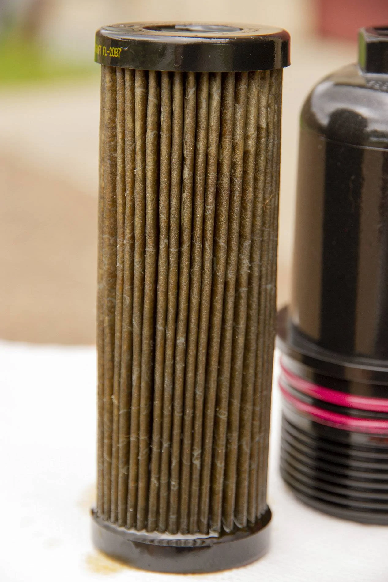

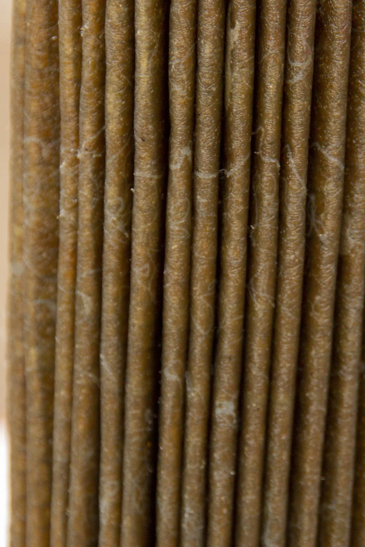

Did my second oil and filter change today with the help of the little QuickJack. Even so, the dang car sits SO low that it's still too tight for a crawler...you gotz to crawl yourself. :-)
And I don't know if that access panel for the filter was an afterthought or not but I'm sure glad it's there. It'd be a PITA otherwise.
Everything looked normal, filter was obviously used but not deformed and ditto for the housing. Don't much care for even that hard poly carbonate or whatever it is though. Got in a hurry and let the socket slip off twice. Didn't wear the corners much but it still PMO. Gotta get a six-point 27mm socket, twelve-points just don't cut it on plastic bolt heads.
Also, based on Don's recommendation, I installed one of the new versions of the Fomoto Valve and was able to turn it just enough to keep the snout above the lower body panel. Nifty device.
I was able to fill the housing about halfway with oil once the filter was installed and managed not to drip any inserting it into the block.
But I'm bushed..didn't sleep well, again, as usual, and finally got up at oh three hundred. The old geezer needs a nap. <smile>
Anyway, grabbed a couple shots for you engineers including an oil sample. :-)

That 2nd filter should have next to nothing in terms of debris, etc, between the pleats.

And that's pretty much what my old eyeballs saw, Tob. Underneath while draining, I could clearly see right through the stream of gold...literally. :-)
