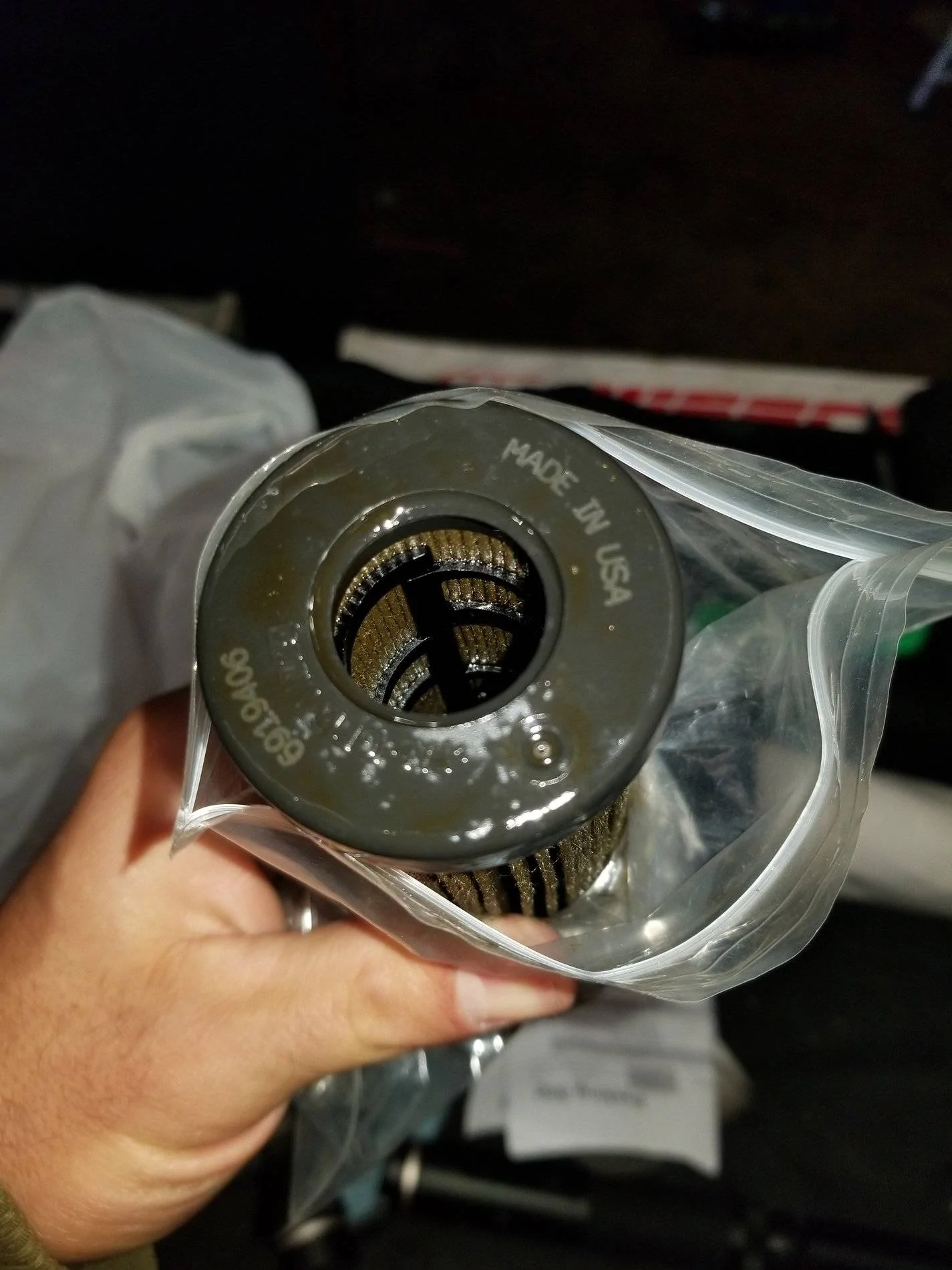

That's a little better so thanks for posting that. Still can't see the inside of the filter to verify it was indeed a GT500 filter and not the older unit that wasn't as robust.

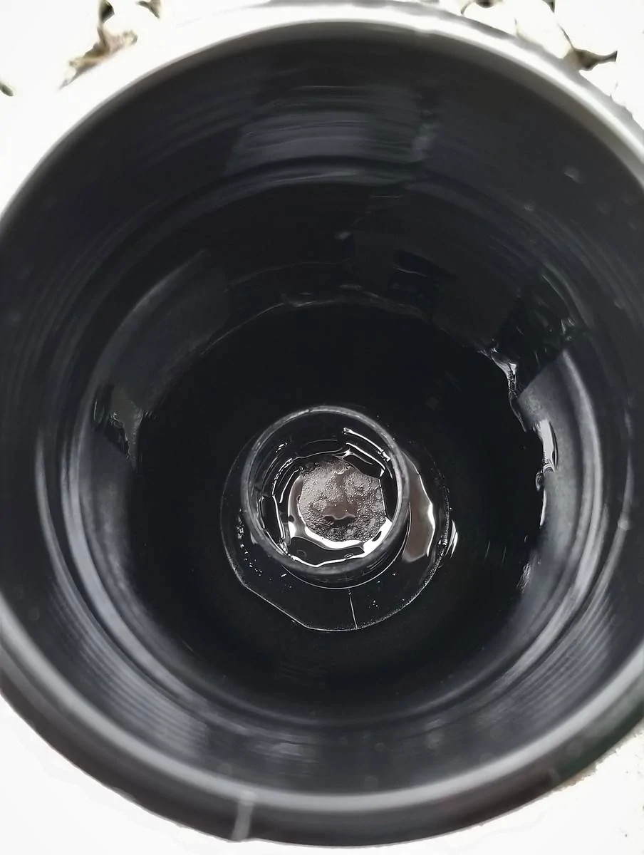

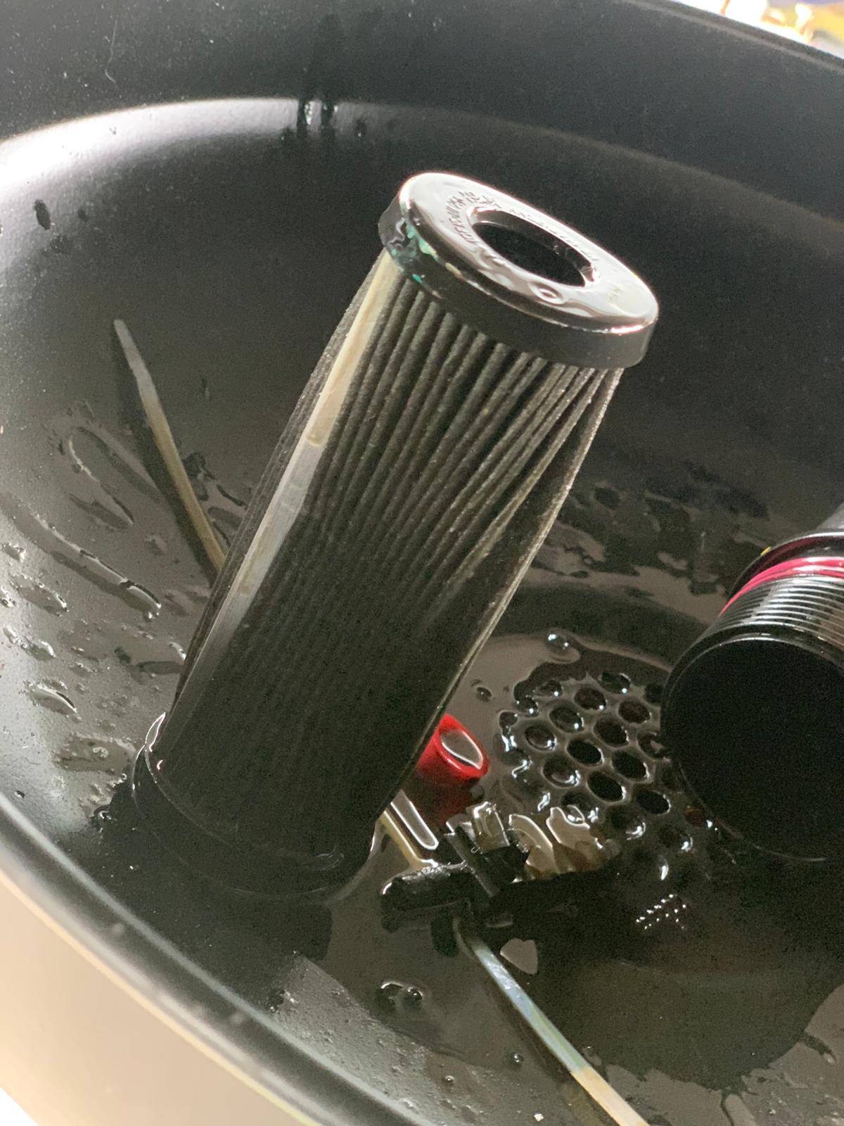

Something weird about the housing. I don't see why there is damage at the piece inside that locates the base of the filter when you push it inside. I can't figure out why it would be twisted like that. Excessive heat or pressure...both....not sure. Anyway it should look like this inside...
@Rcgalore, can you ask your friend if that is the original filter or if he had it changed previously - just to be clear. If the weaker filter was mistakenly used this is exactly what you'd see...

Yes, I saw you mention 1,000 miles. Just wanted to be certain the dealer never changed the filter for any reason. Do you have a shot of the inside of that filter or are you certain it was the latest filter? Since the Niche line builds both the Voodoo and the Predator engine I suppose it is remotely possibly that the wrong filter was installed when the engine was built. The filters have the same external dimensions and look the same until you look inside.

Thinking out loud here: Based on the pix in post #15, it appears the filter may have been installed crooked in the housing. Then, when they tightened the housing, it crushed the filter and bent the centering mount inside the bottom of the housing.

I considered that too and then abandoned it. Look back at the second round of photos the OP posted. You can clearly see the two metal, crimped pieces over the pleats that run vertically - they are straight and don't appear to have been crushed.
That metal strip is the only piece like that. The filter could have been twisted and that strip remained straight. It’s the crushing of that bottom alignment piece in the housing that makes me think that’s what happened. How else would that have been crushed?
Another reason to have a spare housing unit handy like you bought (at least for the first oil change). Clearly a warranty item.

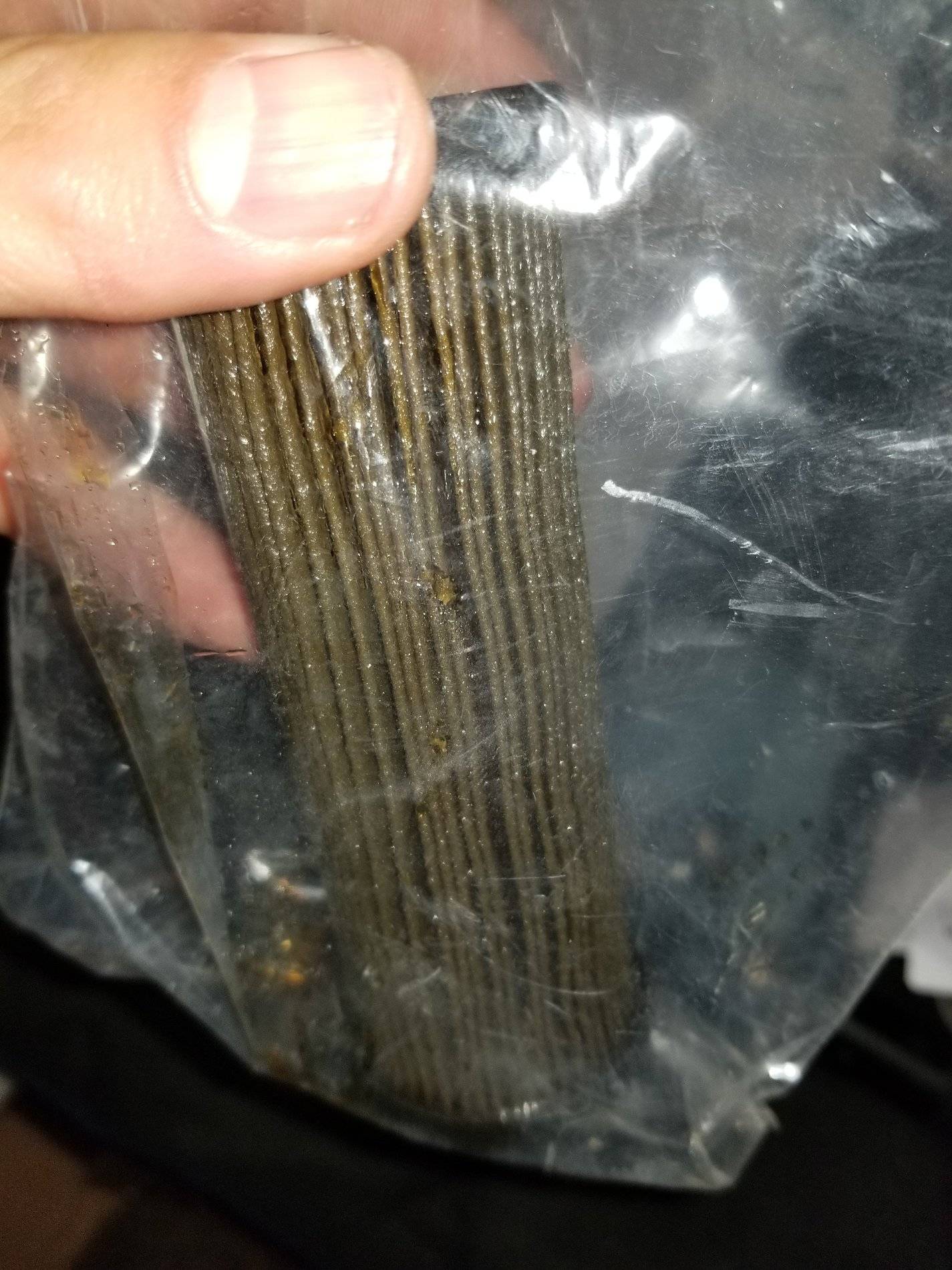

Hi, owner of the crushed soul here !! hahaha.. I mean the crushed oil filter.... in my humble opinion, I agree with you guys.. maybe a poorly installed filter from the assembly line??? The car's currently hemodynamics are stable with good and healthy oil pressures, monitored on different pulls ( Dyno and street passes , as well with no drop in oil pressure. Will defiantly keep a close eye on this and will be performing at least two more filter changes in the near future for monitoring( can't seem to get a good hit on the oil housing part number . There was not that much debris nor metal shaving as seen with others, actually surprisingly 6A832 , if someone has a clue or hint to where I can get my hands on a new one please let me know !!!) clean,,,, although the filter had a "saturated" feel and look to it.

Unfortunately I don to have a pic of the inside , but I do remember seeing the perforated interior. I think we did not throw the filter away, will try to get pics of the inside soon.

Changed my oil today. 1st change at 1200 miles, this one right at 4000.
Admittedly,.i used the old filter as i felt the change of oil was more important than the filter used amd the new # wouldnt arrive in time.. A gamble, but one i lucked out on.
Im now on the proper filter. Ill cut this one open tonight, but oil looked damn good.
