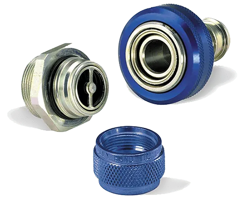

I used an Aeroquip on my Evo X and loved it. Used a quick disconnect system on the drain, so no threads on either side to bugger up, and not made of soft brass.
Lost C... & M3Convert,
How has this Aeroquip connector worked out in actual use for you? Any small cons at all?
HoosierDaddy,
Had you seen these when you were doing your extensive research (and thanks for all of it!)? Do you have any comments on this option functionally? I know is costs more at $72.
M3Convert
HoosierDaddy,
I am shopping too. I just posted the link as a public service as I hadn't seen these either and wanted to check if the size was available.
They also have the quick brake line disconnects if you need a quick caliper swap too! A snip at 350!

HoosierDaddy,
I personally wouldn't spend that much more to avoid screwing on a drainer instead of snapping one on.
But I did request information from Aerotech last week about the pan thread length on their devices. For a mostly vertical drain like the Coyote I want threads that don't extend into the pan because it will reduce the amount of oil that can drain.
Now clearly that is not a high priority for many or companies like Aerotech would offer different thread lengths. And it might not be a concern for me anyway because the Aerotech may have 9mm thread length. 9mm is the thickness of the drain boss plus the washer (what I call it) that goes between the valve and the pan. Femco offers numerous thread lengths for many thread sizes, including the 5.0's.
And in addition to price (and unlikely much too long of threads) I would prefer Femco's threaded drainer simply because I haven't had problems with threads in general but have had issues with older air and water quick connects which I assume are similar in function to the Aerotech (or Femco's snap-on versions). But I think that too is a very minor point as a oil drain valve would be used so few times in its life that any age related problems would be extremely unlikely.
Glad I already have mine and don't have to juggle a decision on which to order (assuming the Aerotech has reasonable thread length).
... I would prefer Femco's threaded drainer simply because I haven't had problems with threads in general but have had issues with older air and water quick connects which I assume are similar in function to the Aerotech (or Femco's snap-on versions). But I think that too is a very minor point as a oil drain valve would be used so few times in its life that any age related problems would be extremely unlikely.
Nor sure I'd spend the extra, but another advantage over other types of quick connects is that this one is always lubricated, so corrosion (esp. w/ water cons.) should not be an issue. :)
Thanks for your continuing research on this topic for the community!
