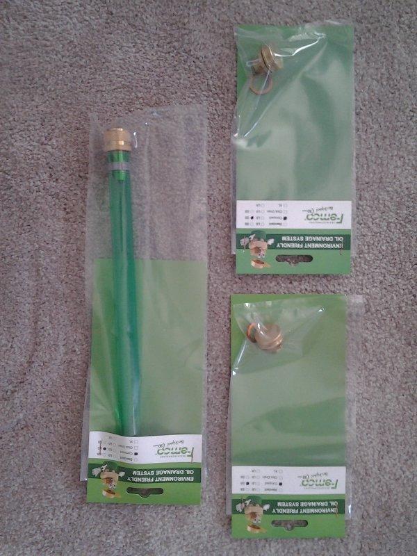

Well guess what? Wifey didn't tell me but the Femco parts also arrived on the same day as the Amsoil, 6/16. Just three days from Holland via DHL for $10!
Bottom line is the bottom line is cheaper ordering through the www.drainplug.com website.
Here is a photo of the packaged parts. Wife's TL shares same drain tube as the Mustang plug.
I can't see a part number in those pics. Can you measure the length of the threads that go into the pan. Should be 9mm if its part#7090010153. I'm asking because its hard to be sure from the pic BUT the threads look to be longer than that on both valves based on visual comparison to the height of the part outside the pan.

Yes that is the part#. Yes, it is 9mm. And only 1/2" below the pan.
I need an oil change now. Good thing I didn't install it yet!

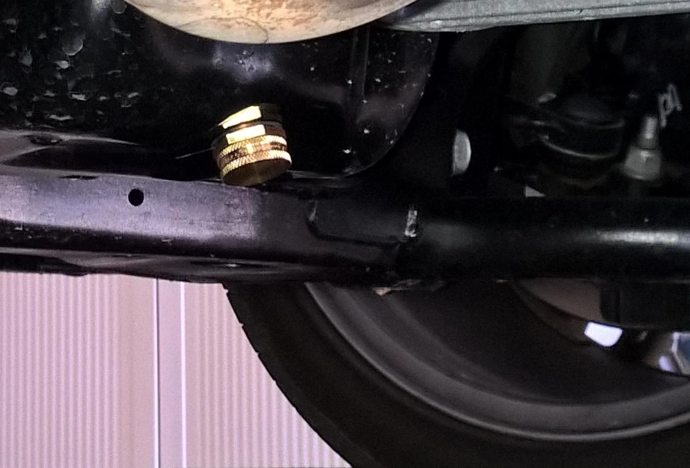

Here is a picture of the Femco (compact version) installed in my 5.0. It's dust cap extends about 1/8-1/4 inch more than the factory drain plug which has a large head.

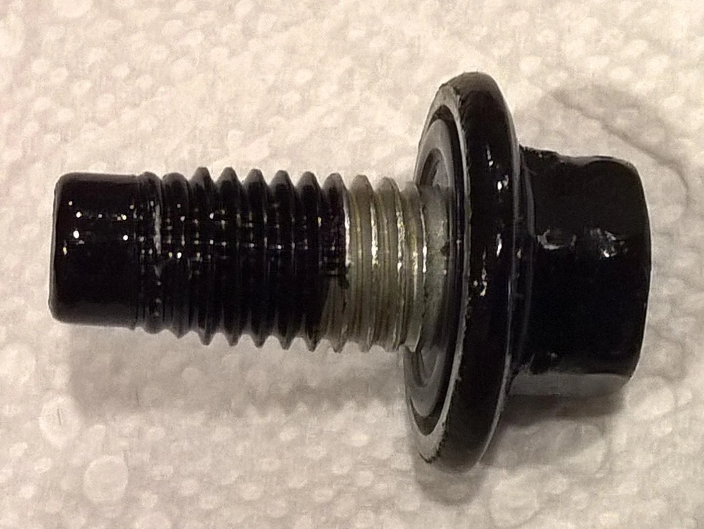

Note about the factory drain plug picture in a previous post:
Ford apparently paints the pan inside and out with the plug already installed so you can tell how thick the oil pan (and any internal bung) is by looking at the unpainted threads. Notice there are ~ 4 threads not painted. So that is the preferred number of threads on a drain valve since any additional length will prevent some amount of oil from draining. So regardless of the style of Femco valve (compact, standard, larger or small base, etc.) a part description ending in -T9 is optimal. The 9 represents the length of the threads in mm and is ~5 threads for M12x1.25 threads. The washer is about one thread thick, so a T9 will be virtually flush on the inside of a current 5.0 pan. Same concept for Fumotos; if there are options, try to get one with threads approx 9mm in length.
I have no idea of the thickness of a V6 or Ecoboost oil pan.
