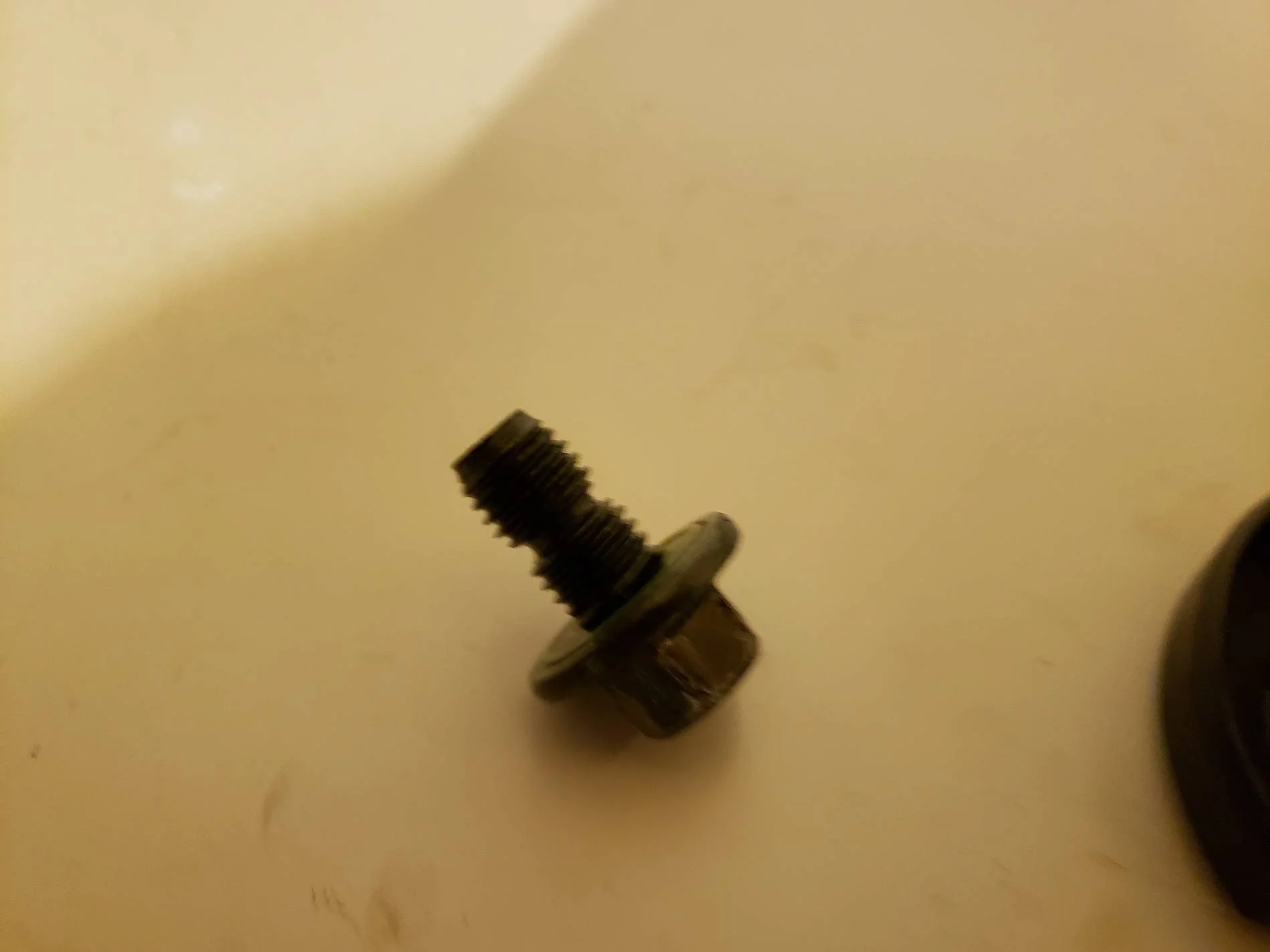

Usually the pan threads are harder than the plug threads so the plug will start relieving upon being over torqued well before the pan will. I bet when OP pulls that bolt out he will see it stretched in the middle and almost broken. I agree that pulling hard and twisting counterclockwise normally should remove it. I had a shop way overtorque the drain plug on my Mercury Sable back in the day, I was amazed that it didn't break. This is what it looked like when I got it out.
LOL, for some reason we all have these worn or broken parts from the past.... for what reason, unknown.
Like little trophies, they should have a glass case in the shop. To properly display these mementos of back in the day. :champagne:
