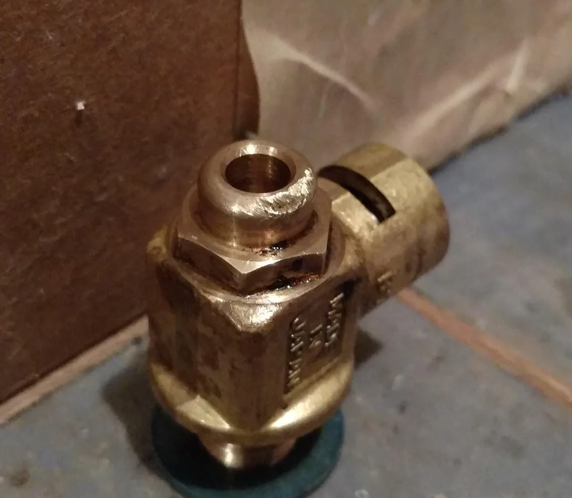

IMHO the Fumoto is too long for the GT.
Admittedly my car gets more torture on gravel roads than most but the fact is that the valve sticks down far enough compared to the K frame to be in danger.
The pic below is a result of a single very light scrape down the middle of the car from a highly crowned dirt road.
I'm back to a good old drain plug for now.

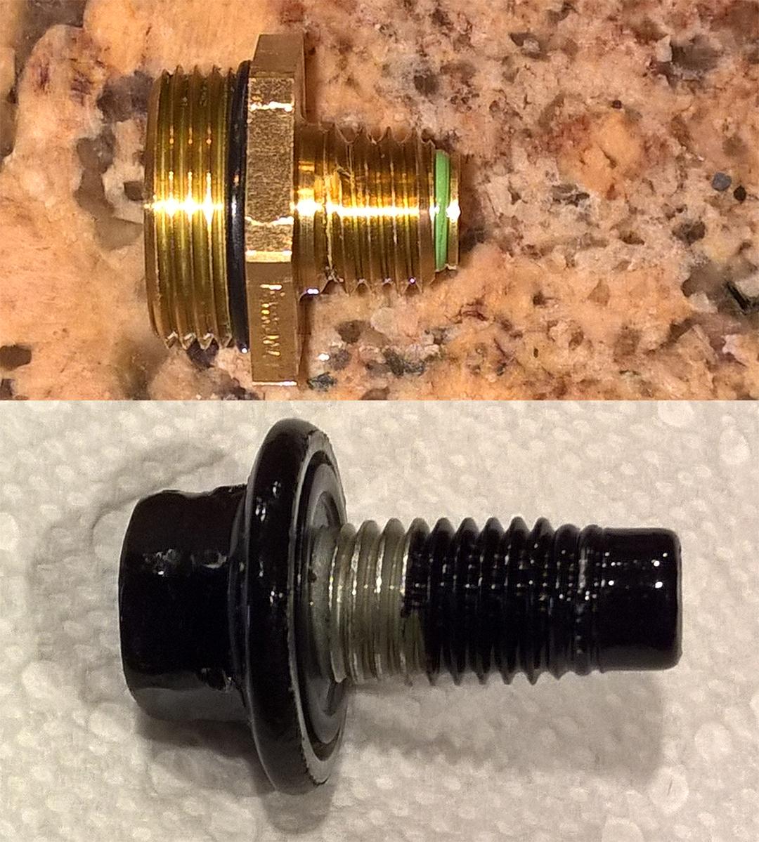

For anyone concerned about ground clearance, here is a picture showing the factory drain plug and a compact Femco. As noted, the pictures in the first post were of a standard size which I exchanged for a compact version.
I matched the scale between the factory plug and the Femco in this composite by resizing to make the width of the threads identical.
The factory drain plug was taken at more of an angle and that picture of the valve doesn't have the dust cap on but the dust cap adds less than 1 thread to the length outside the pan. The valve picture also doesn't have the 1mm washer so I shifted the valve picture about that much to the side to make it easier to see how much each will extend from the pan. As you can see, the Femco does not extend much, if any, beyond what the drain plug does.
The only downside of the compact over the standard valve that I see is that since the valve itself can never open farther than the height of the threads for the dust cap, a compact valve will take longer to drain the oil than a standard. And of course any valve will take longer to drain than the factory drain plug because any valve even when open will have a smaller opening than the pan threads its screwed into.
