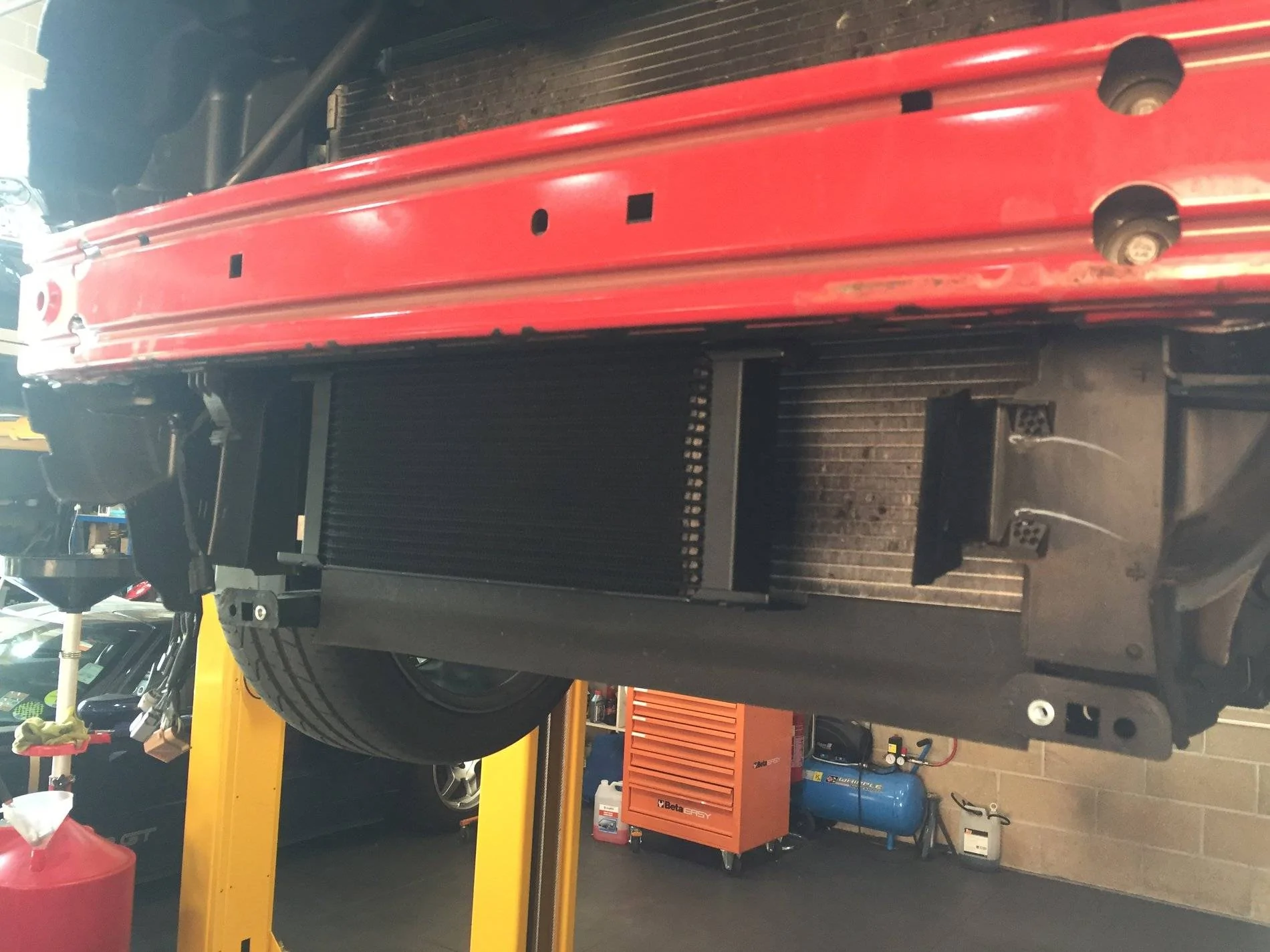

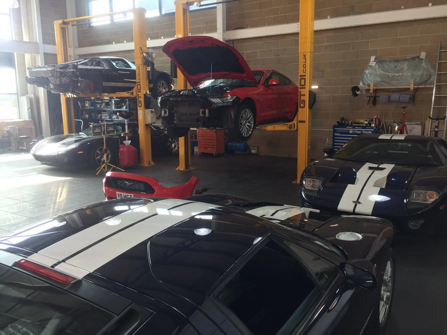

Just had my cooler replaced today as my car is now out of warranty and I’ve decided to keep this car long term.
Being in the UK,what brand did they install? I have the same colour GT as yours,with the nickel alloy forged wheels.I am fitting a “Harrop” cooler(very well respected Australian engineering co.) The core apparently is manufactured by “Setrab”(Swedish,based out of Malmo) but that is the only component they are waiting on,hence the delay.Cheers:):)Ron.

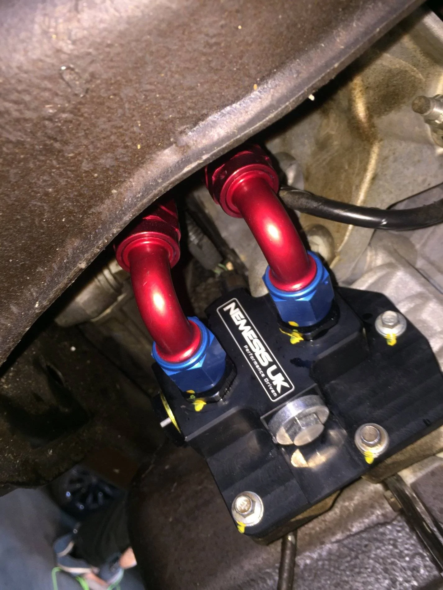

Nemesis don’t sell the cooler direct. It’s only available via gt101 and maybe one other specialist shop here in the U.K. to ensure correct fitting etc.
The rad is a setrab unit by the looks of it, while the block as machined by a U.K. engineering company for them, and crucially for us has a thermostat in it. Maybe not such a big selling point in Australia mind.
That is were Harrop engineering(Melb Australia) source from.(Setrab) still waiting for mine to come in.Covid has been the cause of a lot of delays around the globe.
