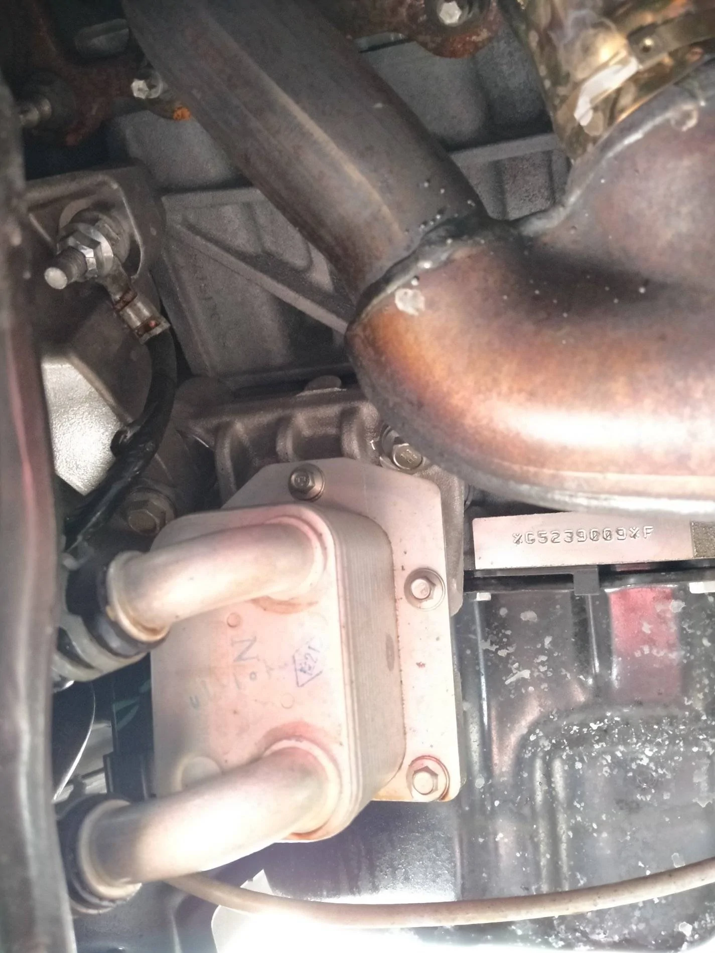

I followed the strategy (on some Australian forums) of replacing the Oil Cooler Assembly (from -'B' to ‘-D’), which apparently was the only crucial difference in the area from the 2016/17 models to 2018 onwards. All good so far, after 28k miles (and my car was an April 2016 build - right in the centre of the batch that was hit frequently by these failures)

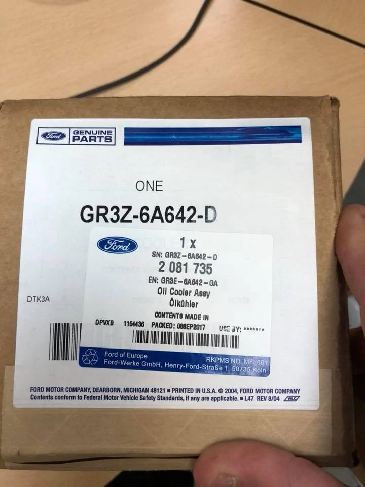

I am located in Australia and have an early 2017 GT build. Decided to purchase the 'revised' oil cooler; GR3Z-6A642-D.
When the box arrived it had the 'new' part number on it but the actual cooler had a different part number on it. The part number is GR3E-6A642-GA. Suprisingly this part number is exactly the same as what is on the current cooler that is on the car! Even identical dates on it; 27/9/16...
When I asked the parts guy what was happening he wasn't too confident and said that should be ok!

It would appear that the 10 speed auto uses this same part as it’s cooler. Maybe the D
Suffix is related to its use on the trans
So who knows....
I believe that GR3E-6A642-GA is the engineering number, which will stay the same when a part is upgraded, except that the 'GA' changes (it would have been 'FA'). The GR3Z-6A642-D is the serial number, and the 'D' would change (from 'B'). This all suggests a changed oil cooler (hopefully for the better !). If you bought a boxed 'GA' and that was the same as the original on your car, then I think your car had the latest cooler on it originally. (one of the first on the early builds).
Also, if oil and water is mixed on failure, the TSB tells the dealer to change the engine (that TSB is on this forum). If the failure is just an external oil leak, then only the cooler is changed.
Hope this helps.

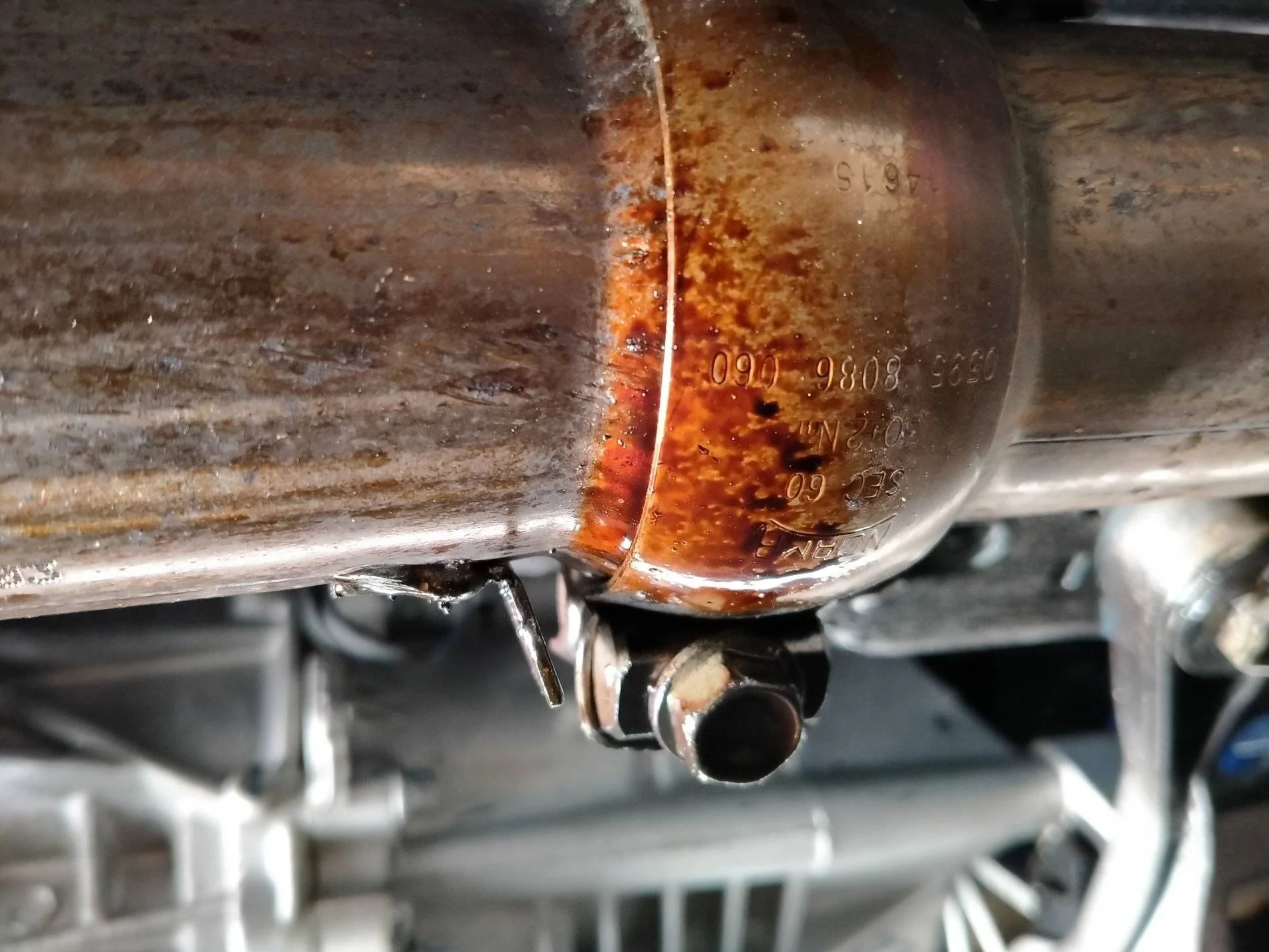

We are from NZ and our oil cooler has let go(our mustang is pre July 2016 with 17,000KM on the clock) and we have oil contamination in the header tank. I Have read all three TBS's 16-0140, 16-0153 and 16=2092. From the later we are up for a new Motor. Did Ford ever come to the party in AU? Did they pay for the ones out of their warranty? I have been turned away by the Ford dealer , he said it's out of warranty. I am in the process off writing a letter to Ford AU. My argument is that I was in warranty when they did all of the TSB's. With no recall. I would appreciate your input, before I send this letter.

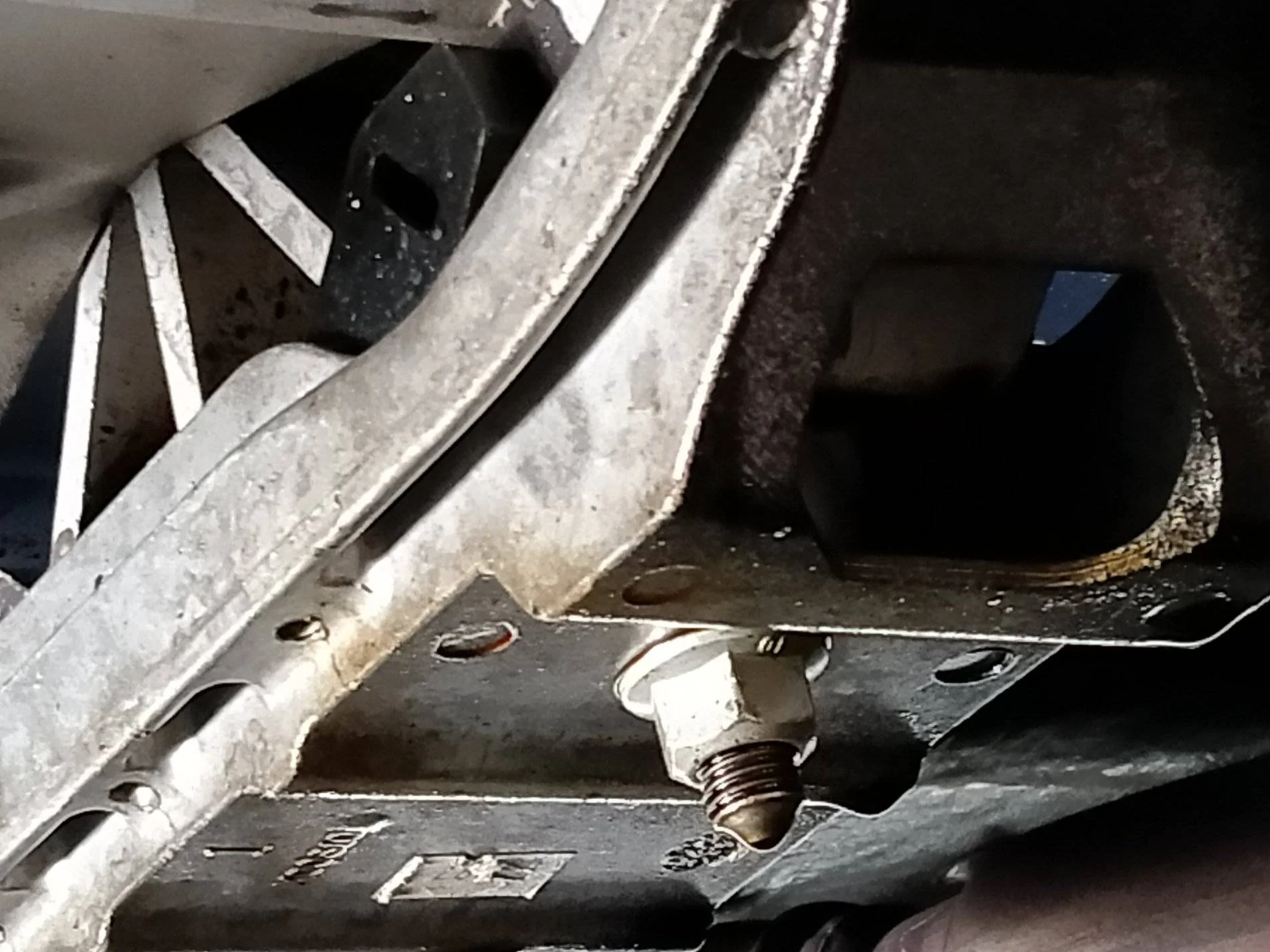

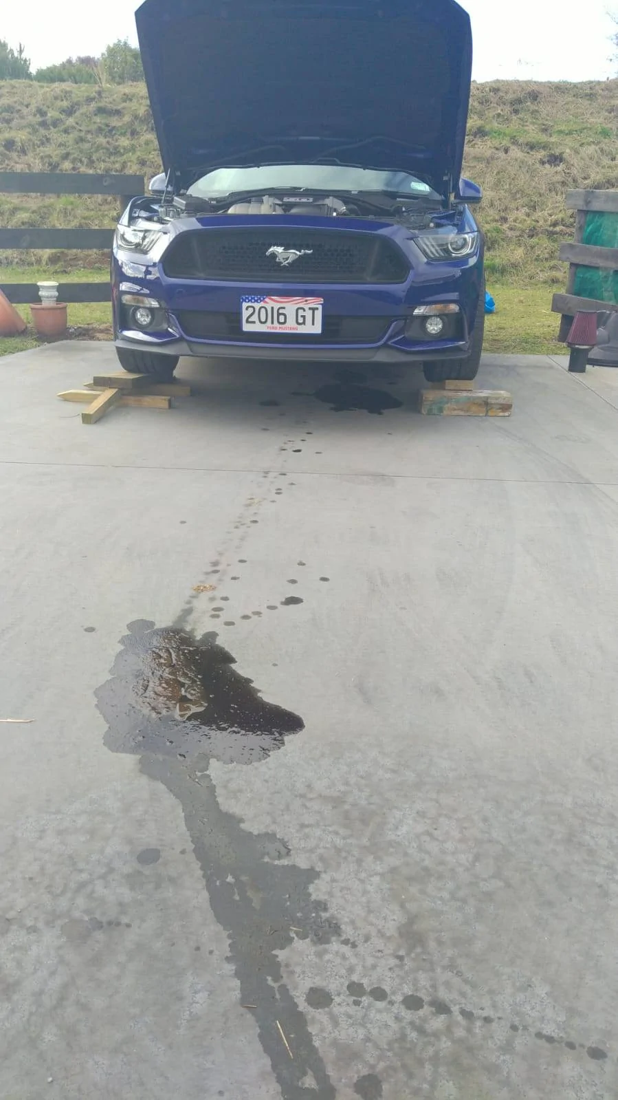

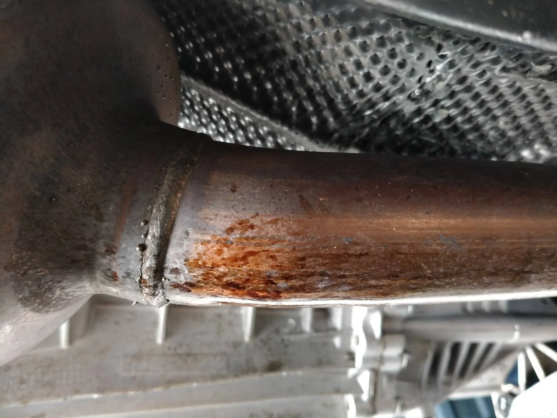

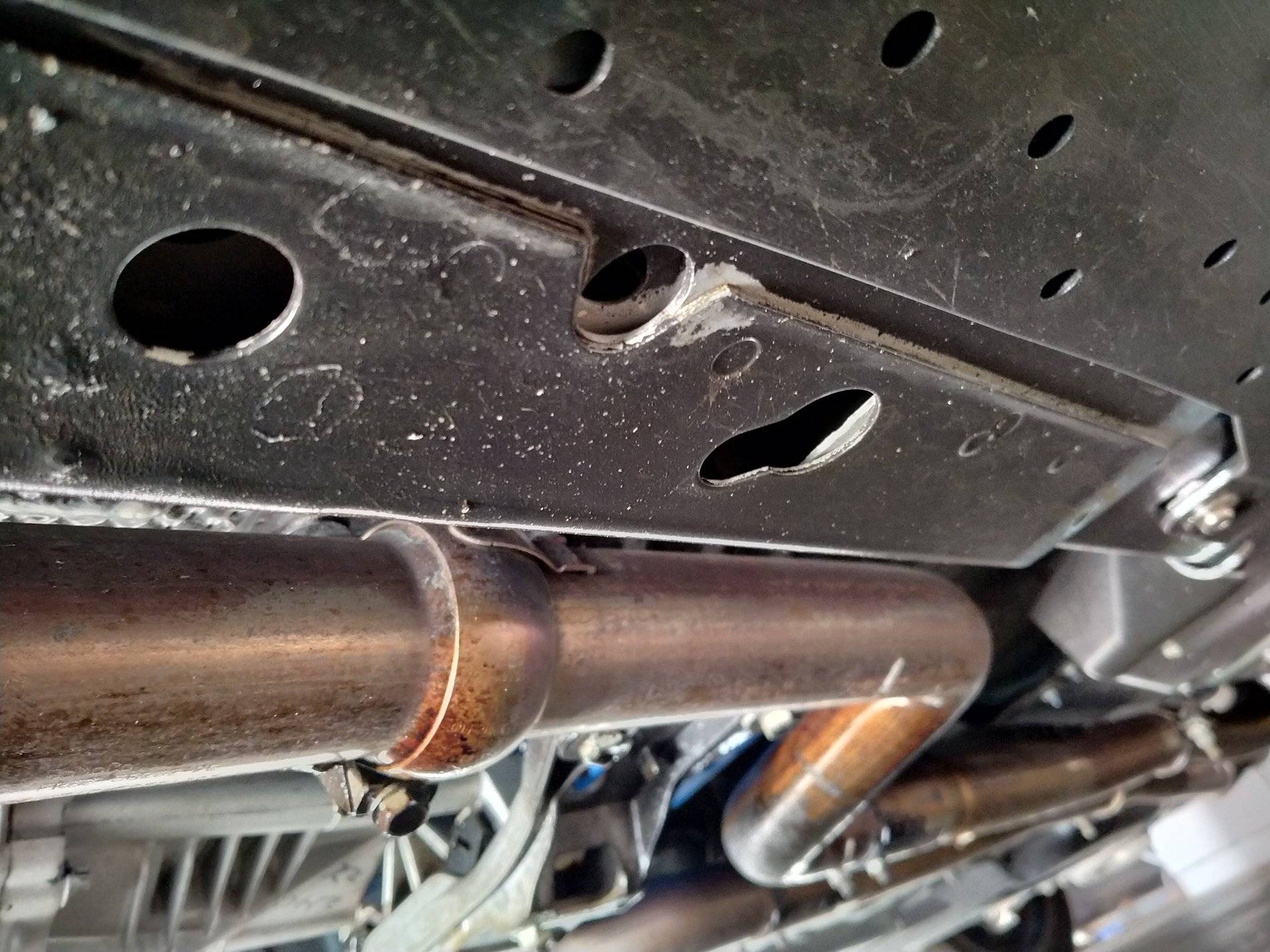

I am from New Zealand and our 2016 GT 17,000km on the clock (pre July 2016) oil cooler let go the other day. I have red the TSB's (three of them) The Ford dealer said sorry out off warranty.We are up for a new motor, total cost of $25K NZ(218K Rand) My question are 1) was your Mustang out of Warranty? 2) Did Ford SA pay for it ? 3) was it hard to get them to pay?
The sad thing is our car was in warranty when they put out the first TSB 12/10/2016. They should have recalled them.
I have sent my letter off to Ford AU and Ford NZ acknowledged the letter. I will update as I get a full response. I have added photos, the oil was leaking for a while and went from one end of the car to the other, including all over the exhaust. (Burnt)
Cheers Andy
