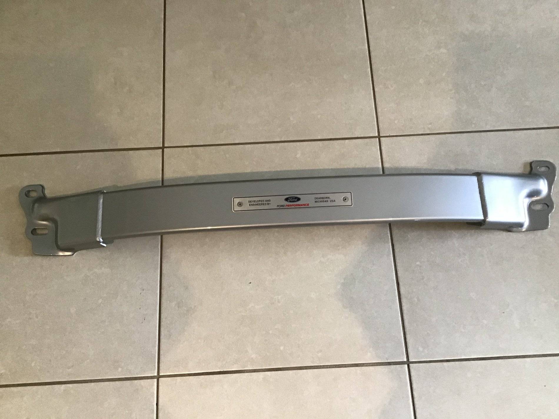

Finally! My Harrop oil cooler has arrived.Vehicle is booked in on 2/9/20.Plus my Strut Brace arrived.Woo Hoo!
