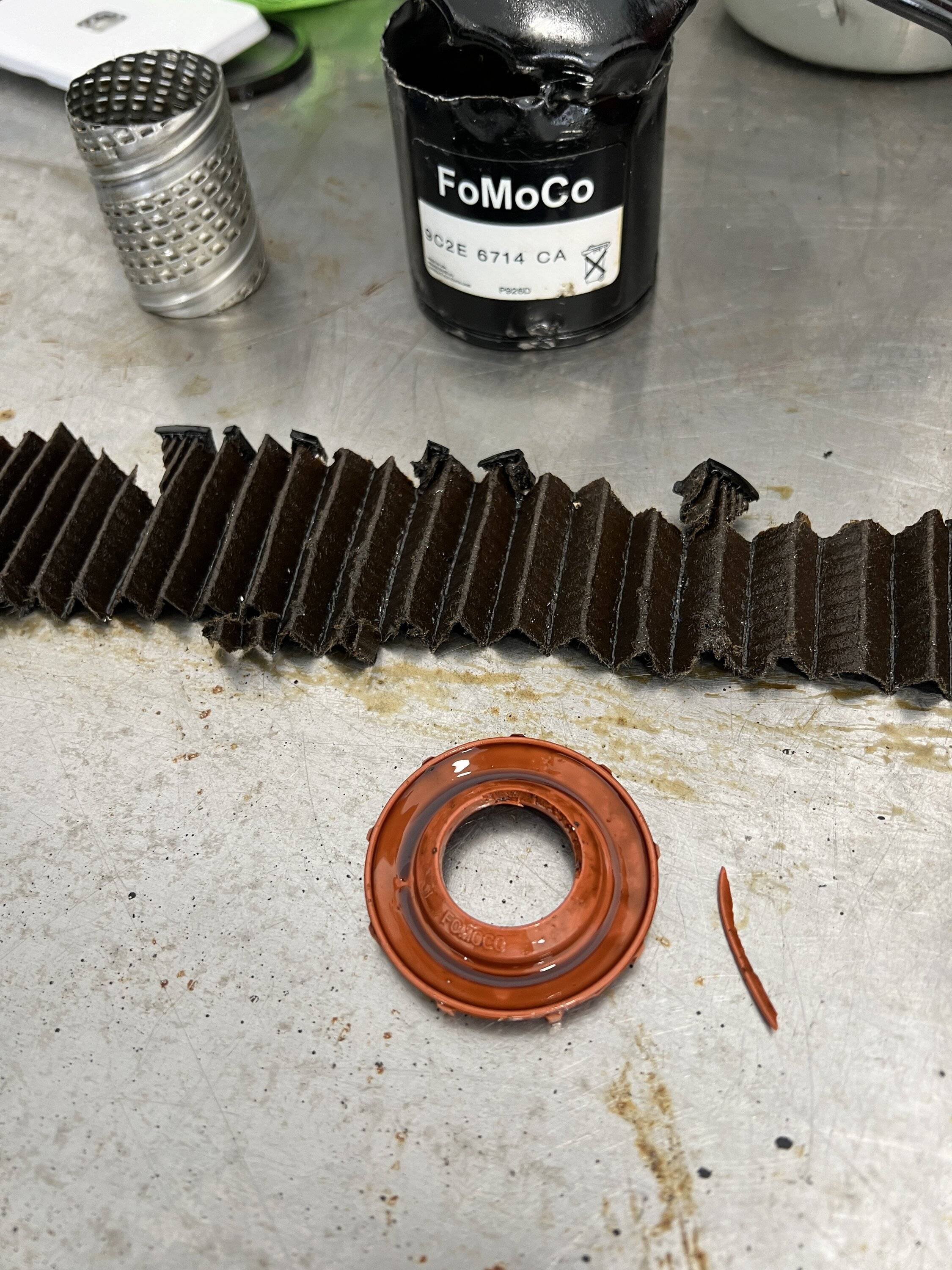

So first oil change is scheduled at 15000kms for the GT. Being an old tech, anything over 10k for a new engine makes me nervous, so I decided to get oil and filter changed early. Dealer tried to convince me it was unnecessary so call me paranoid, but whatever. I was planning to do it at half distance, 7500kms but due to some unforeseen family issues, I have ended up having it done at 9230kms. I have had no mechanical issues but asked the dealer to keep the old filter so I could open it up for a look, just out of interest.
Very glad I did and thought it might be of interest to others to share what I found, which is as follows:

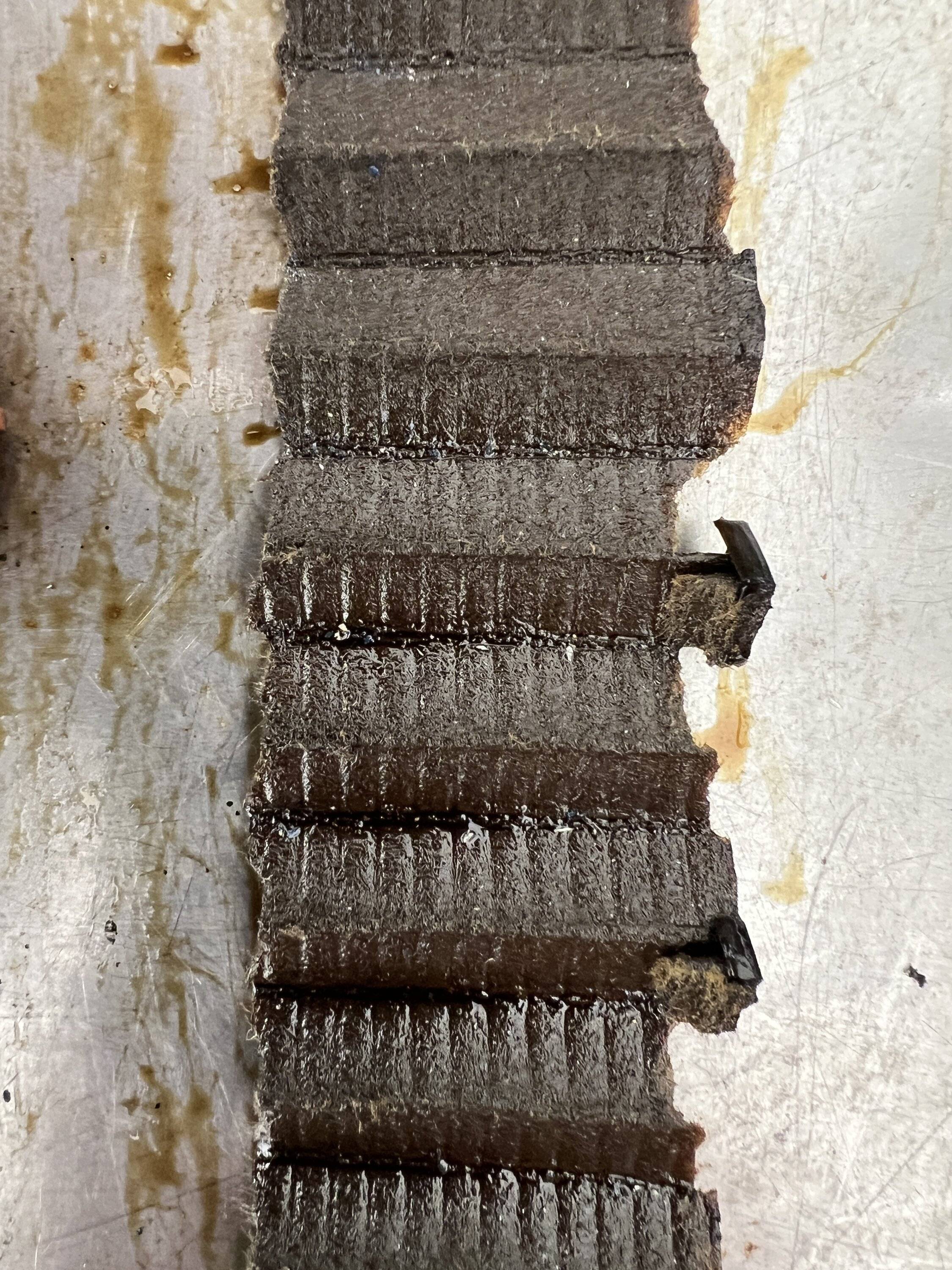

  • Flecks of metal. I ran a magnet over them and they appear to be alloy. They are more like shavings from machining rather than bearing material. I am guessing they are from the block machining process.
  • Flecks of blue paint. Looks like the old Ford blue that they used to paint their blocks. No idea where this would come from.

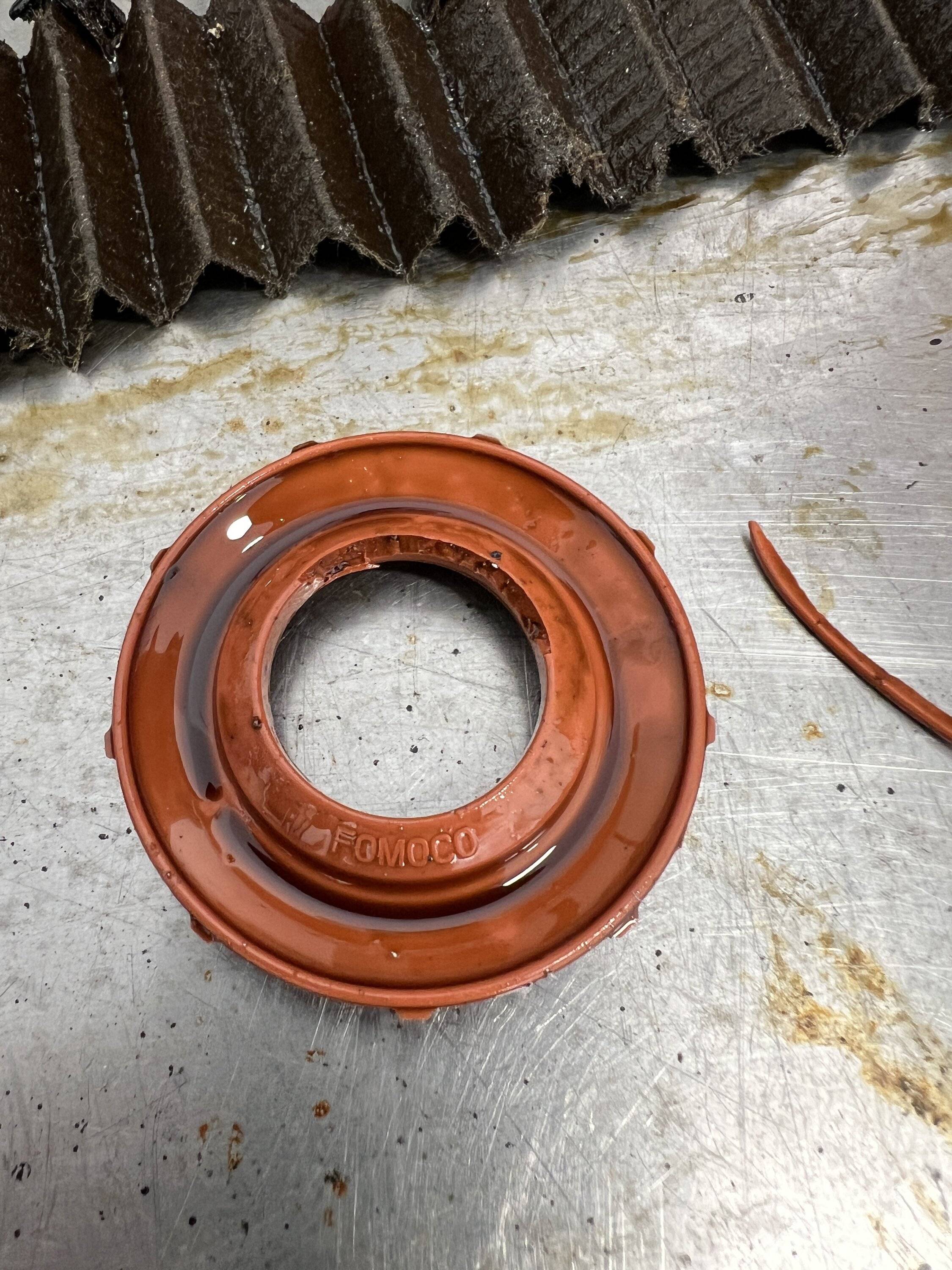

  • Torn internal seal in the factory fitted oil filter.
There is not ton of material so I dont want to exaggerate the issue, and the torn seal could never have gotten through the oil filter which has done its job, but none of this is stuff I want floating around my engine.
For what ist worth, if you have a new S550, I strongly recommend you get the first oil and filter changed early.

I think 15k is too long between oil changes anyway. I'd recommend doing the first at 1500. I would not use the Ford oil filter. The filters internals looks a bit cheap. I'm in Australia and I've found Ryco syntec to be the best but shop around for price.
Same with oil I use Penrite.
Thanks for heads up and yeah always use Ryco . Cheap filters on Ebay fwiw , just ordered 5 . I will do oil changes every 5000km . When a great deal comes up i buy enough oil to do 4 services , usually couple times a year you get get 50% of deals at one of the major auto retailers .
https://www.ebay.com.au/itm/165564599868?hash=item268c6b4e3c:g:x5MAAOSwpuZjtIEZ&amdata=enc:AQAIAAAA4ObHB5md4OdUXj7IHAxVrL4mz3DdylLe0/QlKLE3Yb+gTVfoFYTN50tYDy00XoZ/deFGTOFdrhkYVeUZY1A7/uayw25p8BtGSxm1IfoZ5qVByyEUJdTqW0rlBYGity6MMjUWC/icVQ5GVrrTiZSJx8Gy9aaNXT4sKs/fpoaE/Dw2kBokd5H7bms7CXVFsPjgbY8nRvpPB+6zR/NcKLfuAGchqjXvkYneBZx/dNzErG1LUDCw5QN+uwPxk2amh/b9BDVe5mKLUTnsGW/fCrrxNem7BVOKUrTTOxCYCzxsExs0|tkp:Bk9SR9Lm7NX8Yg
Edit : Also as @Case above states cutting open the oil filter is a great idea as well for a headsup . I will go as far as getting oil tests done every 10,000 km until factory warrenty expires
