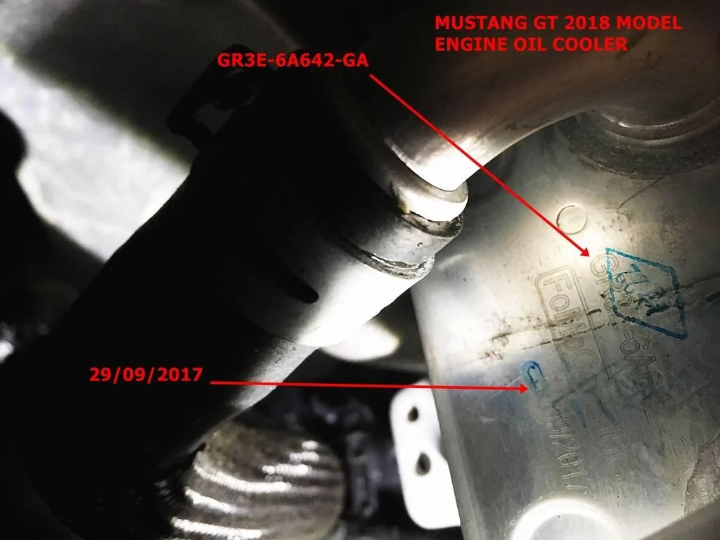

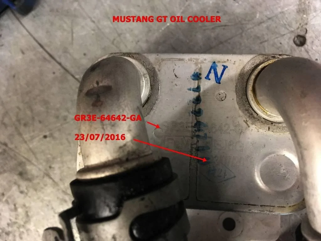

We have been waiting for the 2018 Mustang to inspect it to see if the oil cooler had been upgraded.
As per the pictures below it seems that the part numbers remain the same as the previous 2015-2017 models.
The first picture is many of the standard coolers that we have replaced over the last year.
The part number stamped on the cooler is always the same, with only the date changed. GR3E-64642-GA
The second picture shows an oil cooler we removed from a 2016 Mustang. The part number is the same and the cooler is dated GR3E-64642-GA 23/07/2016
The third picture is a factory oil cooler on the new 2018 Mustang. The part number is still the same with the date being 2017.GR3E-64642-GA 29/09/2017
It seems that by part number and prefix of the oil cooler has not been changed.
Ford may have retained the same part number and prefix , while manufacturing a more robust unit.
We tried to see if there are any physical, material and manufacturing differences between the early coolers we and the new 2018 Mustang coolers. Externally all looks exactly the same.
We cannot be sure if Ford has manufactured a more robust unit, along with the unit looking the same , the physical positioning is all exactly as previous models. We are now waiting to carry out our first 2018 cooler replacement to test if the erratic oil pulsation problem from previous models still exist.

@ Streetfighter great work David. Looking forward to the results of the 18 pulsation testing.
In the meantime is it possible to compare the weight of 15-17 against an 18, and sectionalise them both for a look inside. I believe @12g was going to do this at some stage and it generated quite a lot of interest. Would also be good to find one that comes from within the build batch in the TSB and do the same.
It'd be so much easier if Ford would just stop hiding from us.

Will definitely be doing so as soon as we have a 2018 cooler to dissect.
I hadn’t appreciated how much coolant piping was involved with the standard set up!
