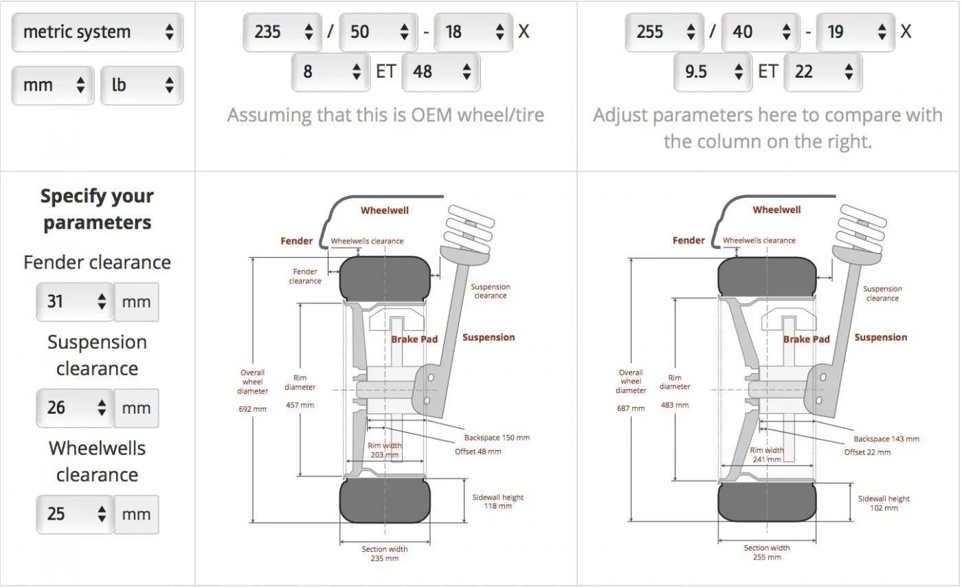

anybody know if 19x9.5 with 22 offset and 255/40/19 will work for a squared set up? will I rub at all?

Don't think so unless you're on lowered spring set.
Here, stock 18" is on the left. and clearances are what I measured on my non lowered car. on the right is what your proposed setup would look like on a non lowered car.

22 offset is too much. I'm on a 19x9.5 with +30 offset and it sits flush.
To his defense, you're also on a 285 tire per your signature (correct me if I'm wrong). His wheel will stick out further, but his 255 tire won't so it should still clear fine. If it rubs, add a little camber.
It will poke but if you do a smaller tire and run a tad bit of camber you can do it.

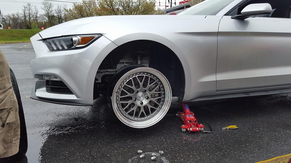

(4) 19x10 +45 MMD Axim wheels from American Muscle
(4) MPSS 295/30/19
(4) 1" hubcentric wheel spacers from American Muscle
I have only put a little over 100 miles on them I believe so I am still breaking the tires in (all city and no highway or twisty roads :( ) but I can already tell a difference with steering and turning. DEFINITELY looking forward to when these babies are ready for the canyon!
My ONLY complaint is that I went with 1" spacers. The quality from AM is top notch, no complaints about the actual spacers themselves, but as you can see I am sticking out too much. To summarize, front wheels/tires rubbed suspension without spacers so I got 1" hubcentric ones to be safe, but now I am not sure if I like them being so far out. I put them on all four corners since I thought it might look weird with only 1" spacers on the front. However, I do have a pair of 8mm hubcentric spacers ordered and will try the car out with them on the front and no spacers in the rear when they come in.

Yeah, 19.6mm is way too much (little) offset with those 1" spacers, the 8mm should work better for the fronts. Remember less is more with wheel offsets.
