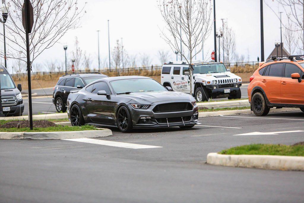

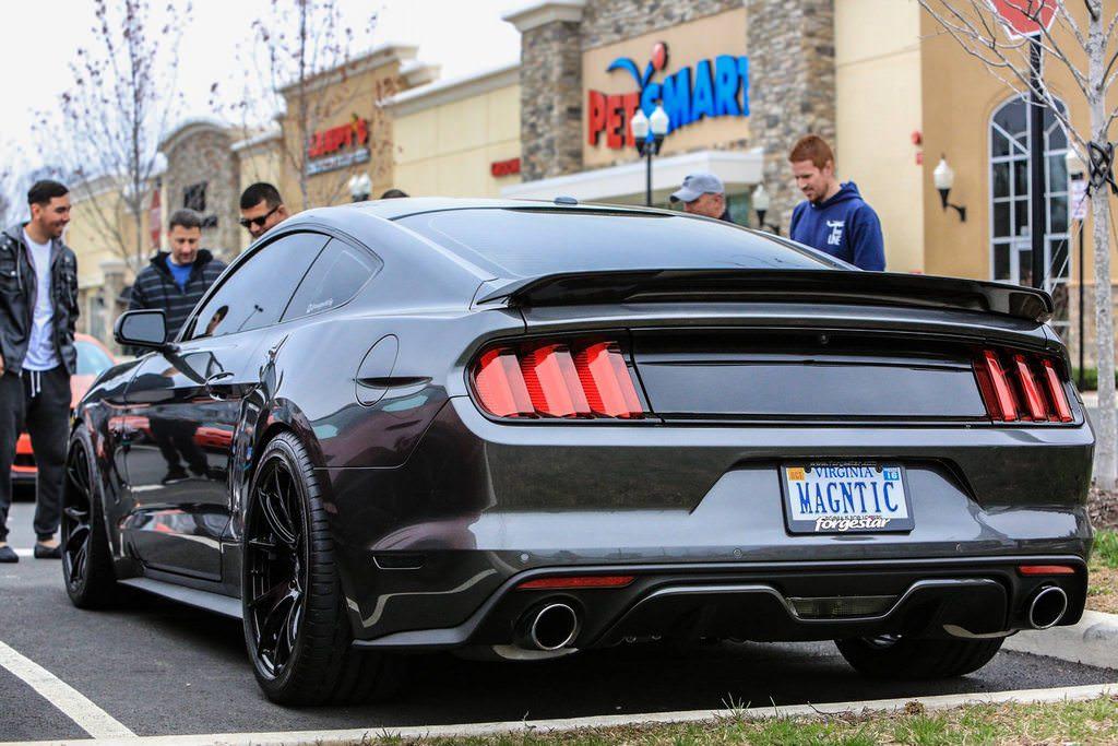

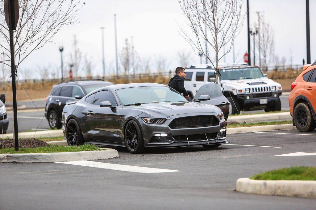

Forgestar CF10's 19x11 with 305/30's.
No issues at all, works great. Street handling is great, with a little tram lining, hope to do a track day soon to see how they do when pushed to the limit.
