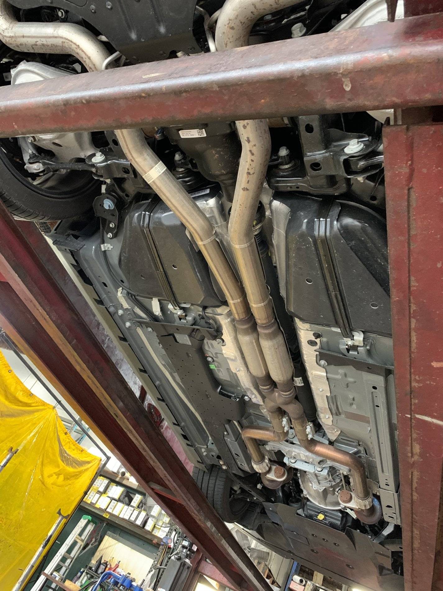

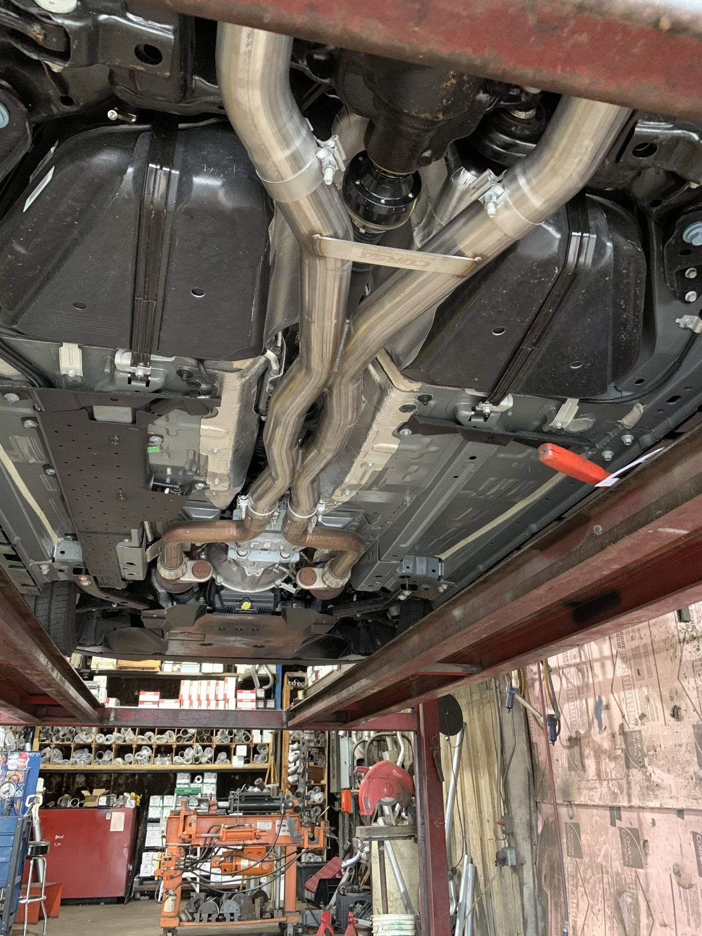

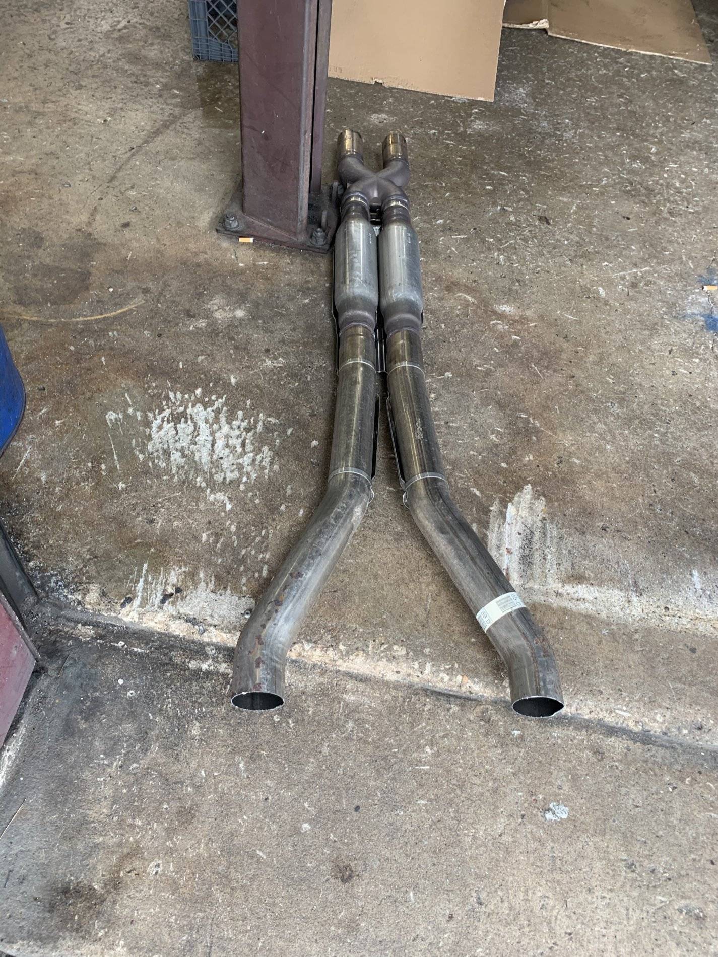

Got my Corsa Double Helix installed yesterday. The car sounds awesome in Sport mode with none of the rasp at 3-4K like a straight pipe resonator replacement. I think it was well worth the extra cost to avoid the rasp and crank up the volume!
Out with the old:
In with the new:
