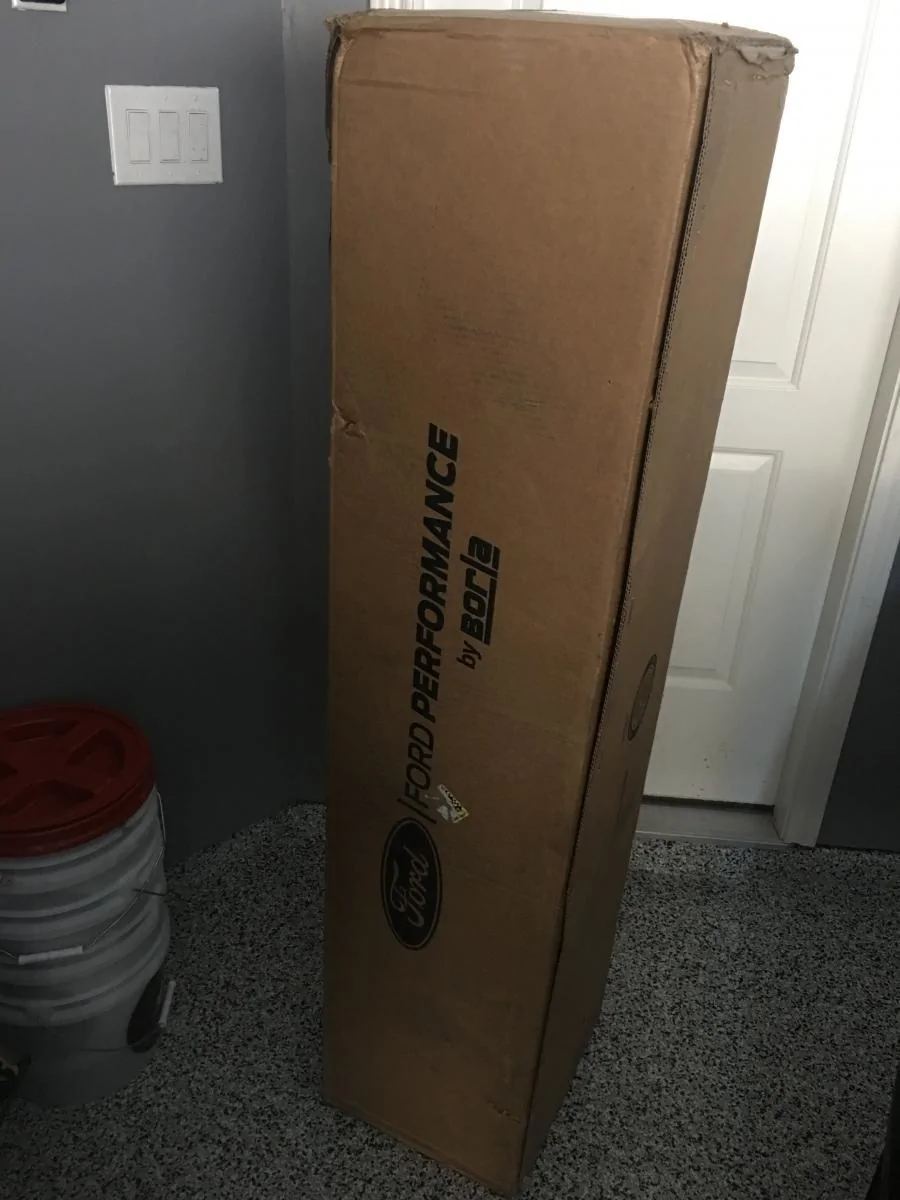

I have installed the Borla ATAK's on my 2016 Shelby GT350. Sound is great but the tips of the exhaust didn't line up very well (too long and not angled correctly) with the factory valance tips. After back and forth with Borla determined that must be factory manufacturing error. So Borla sent new set from CA they personally checked. Well they are exactly the same. Solution is to trim both outboard pipes by 1.5in and bend the inboard pipes about 1/2in or so to line up. Going to paint the tips black so can't see them. A lot of money and headache but again sound is really nice.
