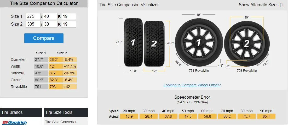

Are these 30 series tires? I might have missed it.
If so, the GT will gain a small, but not unsubstantial gearing advantage.
I estimate another mph or two in the 1/4. It’ll also help with the 7500rpm redline too.
"It’s highlighted by a lower stance, a redesigned front splitter and rear spoiler, and 305/30/R19 Michelin Pilot Sport Cup 2 tires wrapped around split-fitment aluminum wheels – 19x10.5-inch front and 19x11-inch rear."
