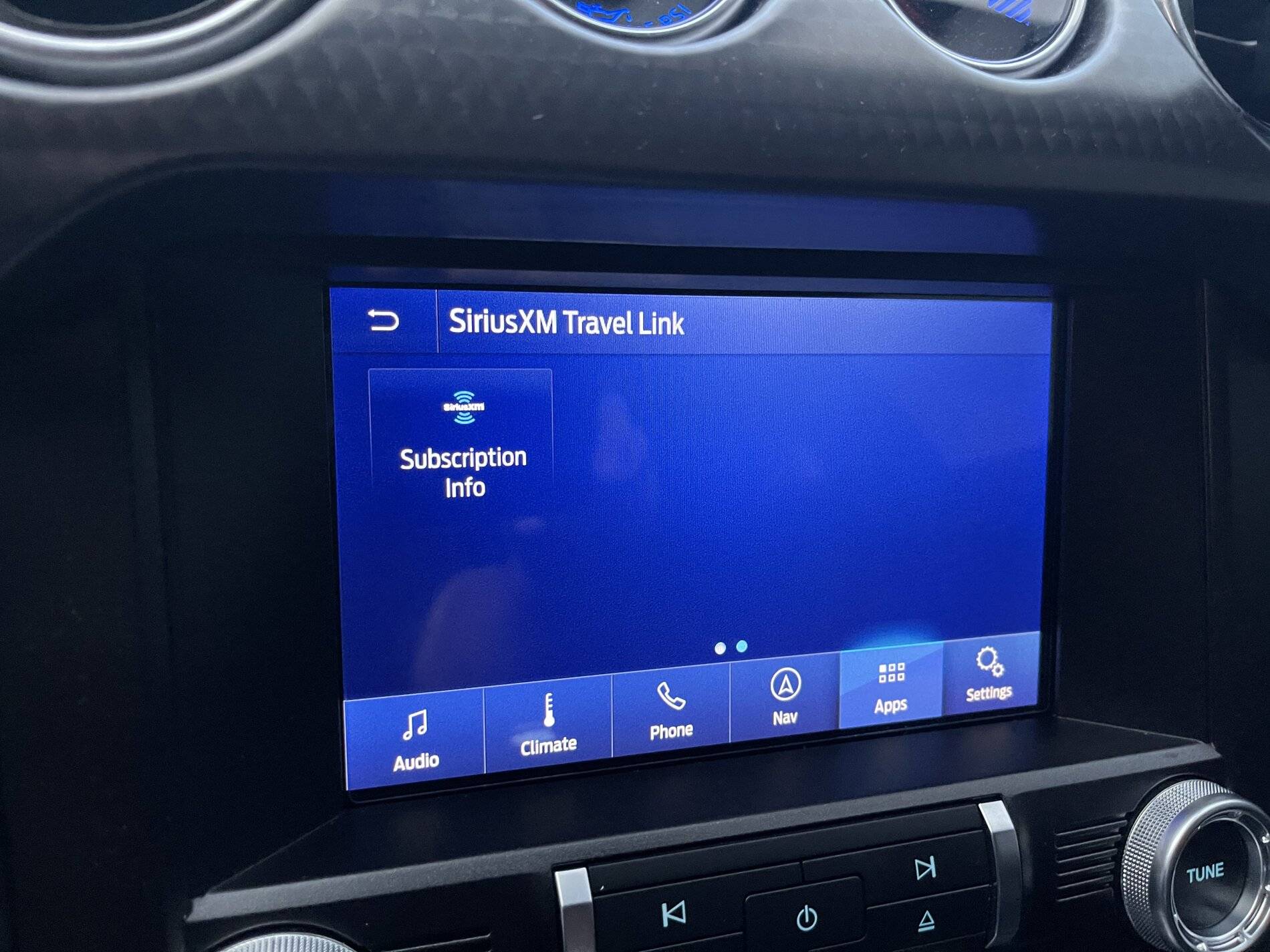

I have never seen that list of apps, can you explain how you got that display? Thanks!
From the Home Screen click on apps, then click on SiriusXM Travel Link and then swipe to the right and you will see the subscription info icon. Click on that and you will see your subscriptions
Thank you Sir!
