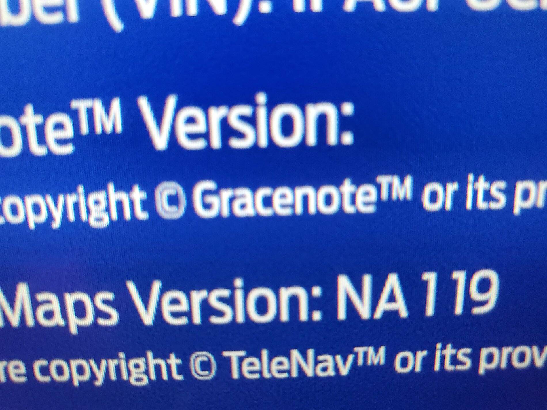

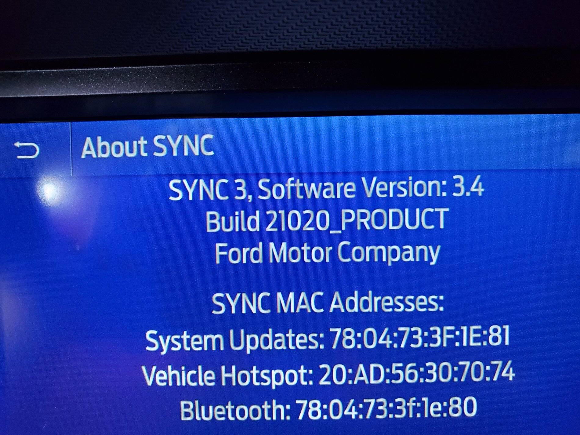

Here are my current sync and maps.
There are seven files in the "SyncMyRide" folder. The current ones are listed below. Your's looks like an older one. What is your current build #?
4U5T-14G423-CC.tar.gz
5U5T-14G381-ER.tar.gz
5U5T-14G391-CN.tar.gz
GB5T-14G386-AD.tar.gz
HB5T-14G386-VBB.tar.gz
HB5T-14G386-VEB.tar.gz
LU5T-14G386-CA.tar.gz

Mine keeps trying to download the same update. Ford website keeps telling me I have an update: 21020 but that already installed over wifi. C'mon Ford.
