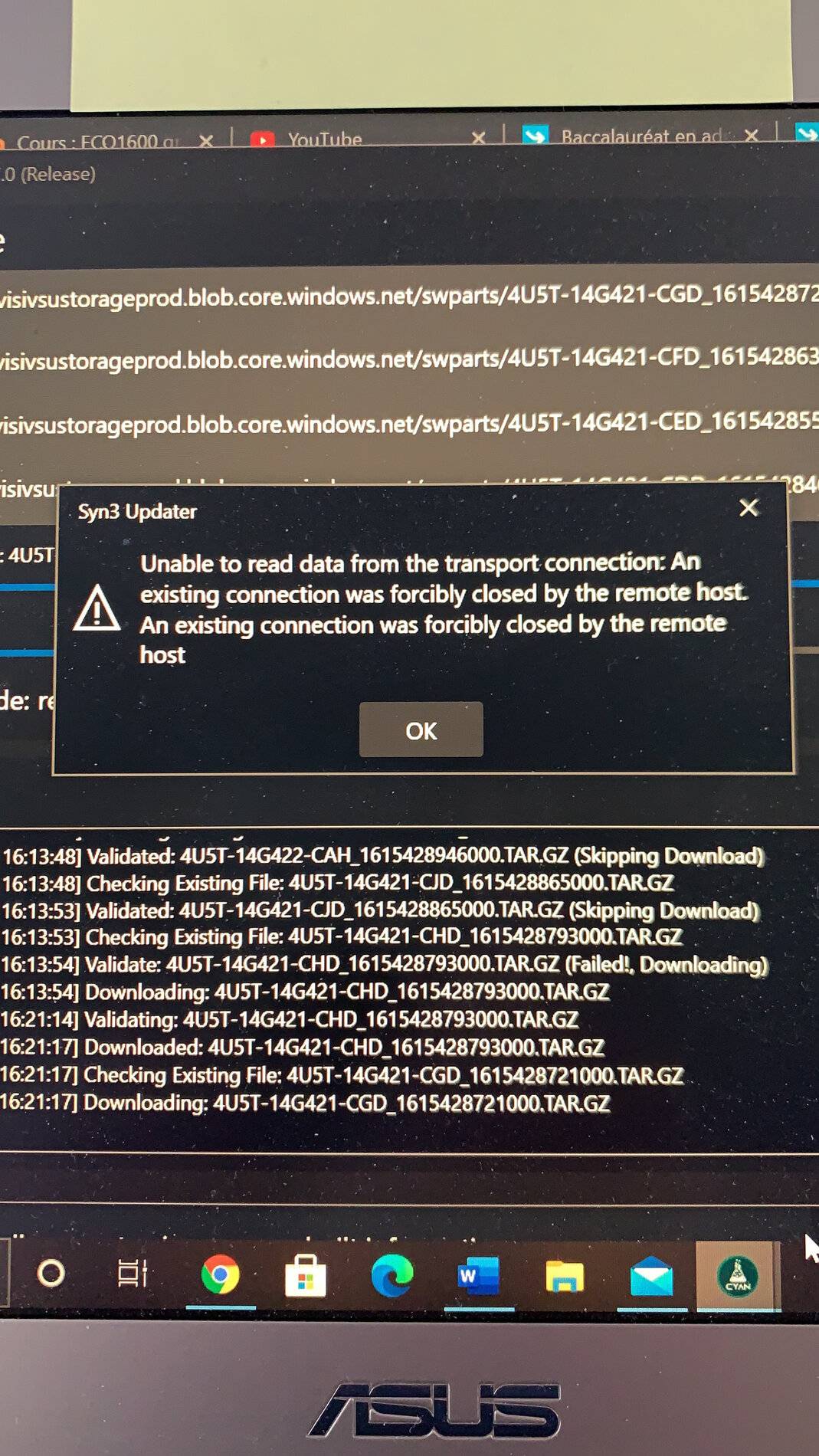

Hmmmm….trying to upload the log file, keep getting “Upload Failed, try again later”. This happen to anyone else?
Yep, happened to me 5 times trying to upload Sync3 updater to my usb stick.
Have no clue what’s going on...
Try doing the download late at night or early in the morning. Server is getting hit hard that is the reason for the errors. The update does work fine once you have it all downloaded and on your USB Drive. Go for a ride for about a 40-60 minutes and should be good to go. Your error from Cyan Labs is not the same error as the upload they are talking about to Ford after the update. That has really never worked well. I'm Currently on 3.4.21020 and 2.20 (2020) Maps.

Try doing the download late at night or early in the morning. Server is getting hit hard that is the reason for the errors. The update does work fine once you have it all downloaded and on your USB Drive. Go for a ride for about a 40-60 minutes and should be good to go. Currently on 3.4.21020 and 2.20 (2020) Maps
Haha just PM’d you minutes ago, thanks for the reply. 🙂

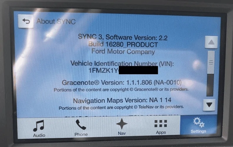

Yes, exFAT. I 'think' I updated Sync but I'm not sure. I called the Maps hotline and the guy said 'oh, you don't need to update'. Then WHY did the website tell me to update and I wasted my free update!?
OK, so what version of maps do you currently have? Most likely 1.19, right. To the best of my knowledge 1.20 hasn't been released by Ford so there was nothing for you to update (1.20 is available on Cyanlabs but I wouldn't go that route on a warrantied car).
When it comes to the Ford update website and the folks at the hotline, "why" questions are not allowed. For the most point the answer is "because". Sad but true. If your maps are current you didn't waste anything.
Also, are you saying your drive was properly formatted? If yes, have you checked to see if you have all the files properly downloaded? Check and double check. For what its worth most of these issues are user error.
Edit: Last thing. There is no thinking you did an update. Go into your "About SYNC" screen and check to see what versions you have.

The car did recognize the drive. Thanks for your photo. I wiil compare it to mine.
Sooo... I should not use Cyanlabs to update my maps? That's a bad thing? I don't want to mess with my warranty in any way.
The car also did an OTA update. I drove around and for the longest time the progress bar was 2 millimeters long. Then it went to 2 inches long. Then it said update complete. But I have no idea what it updated. I think it said file 4ZJSTXXXXXXX.TZ.TAR. I think.
