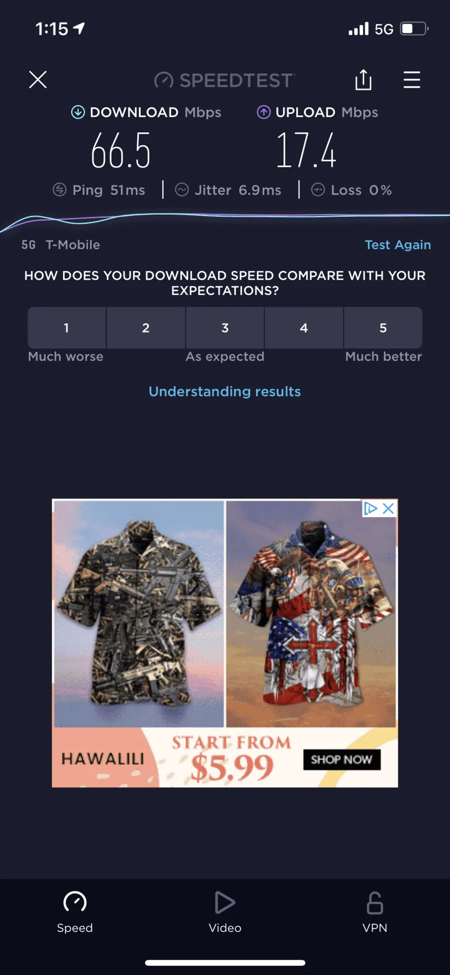

I tried the Sync OTA scan for updates and no-go for me, as it never finds and downloads an update and no I am not on the latest update. I have a super-strong wifi signal that doesn't drop until I'm at least a block from my house, so that isn't the issue.
Now that I typed this, I'll probably walk out to the car in a couple of days and it will have updated via wifi.

Try using your phones Hotspot.
