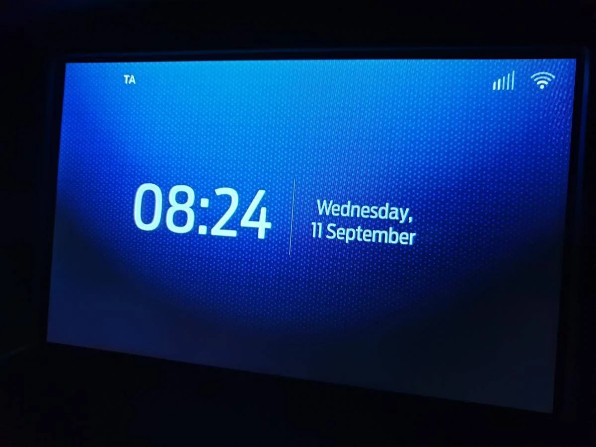

Calm screen looks like this (not my car):
So I went through the themes last night in test mode and ran out of time to actually find the right codes for Forscan programming. All themes are blue except for the Lincoln versions. There could be subtle differences within the menus. I think the themes are setting the animations for the different vehicle models.
Now from what I have learned about the APIM theme programming it may not be possible to combine the Mustang animation with the Lincoln theme. I'm finding conflicting information about this and will likely need to experiment with the codes.

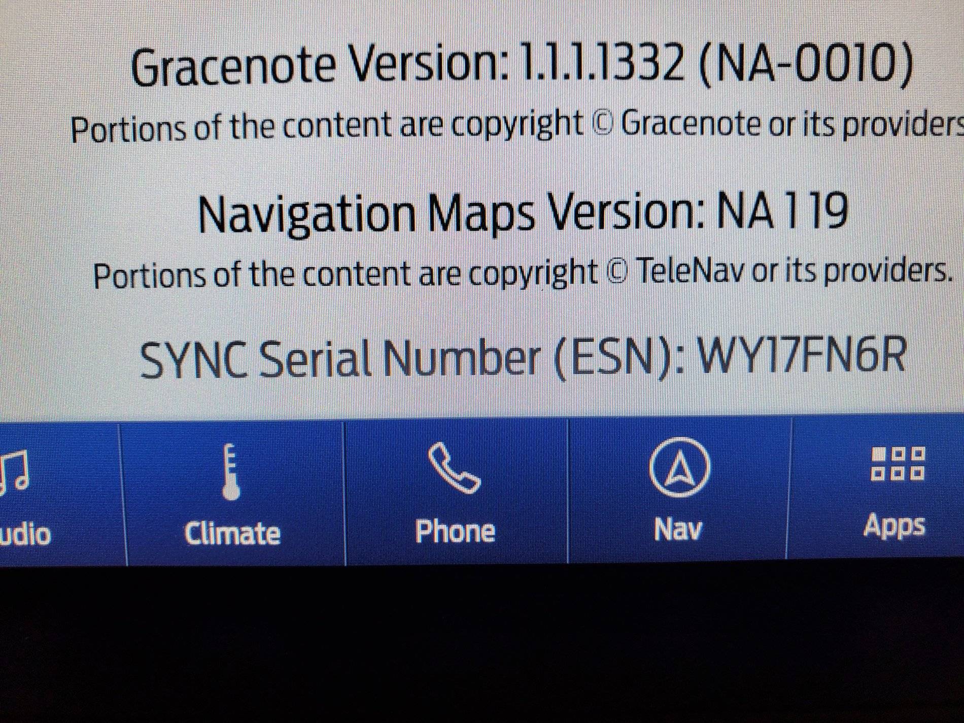

Beware that even on a charger, and in accessory mode, the car will shut down after about 45 minutes to save battery. I went out to the garage and it had just shut down. I hit the accessory to turn back on and the screen said system updated.....but it didn't say remove USB, so I didn't do anything and then the system updating popped back up on the top of screen. I will see how it goes, and if the interruption caused any problems.
I had removed the navigation completely before starting the update....it did something before it shut down, because the maps are showing now, as it shows system updating.
Edit....after restarting and letting it do it's thing.
Shows the right maps.....but guess what, I still don't have Nav Voice Commands. I think that accessory shut down must have something to do with it. Guess I'll give it another try later.

View attachment 497519 Shows the right maps.....but guess what, I still don't have Nav Voice Commands. I think that accessory shut down must have something to do with it. Guess I'll give it another try later.
Check IVSU Versions diag. It's possible it's there now, but didn't mount. Master reset clears that up.

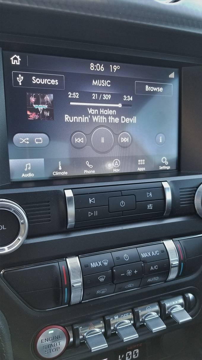

Here's pic of the audio screen in dark mode during the day:
