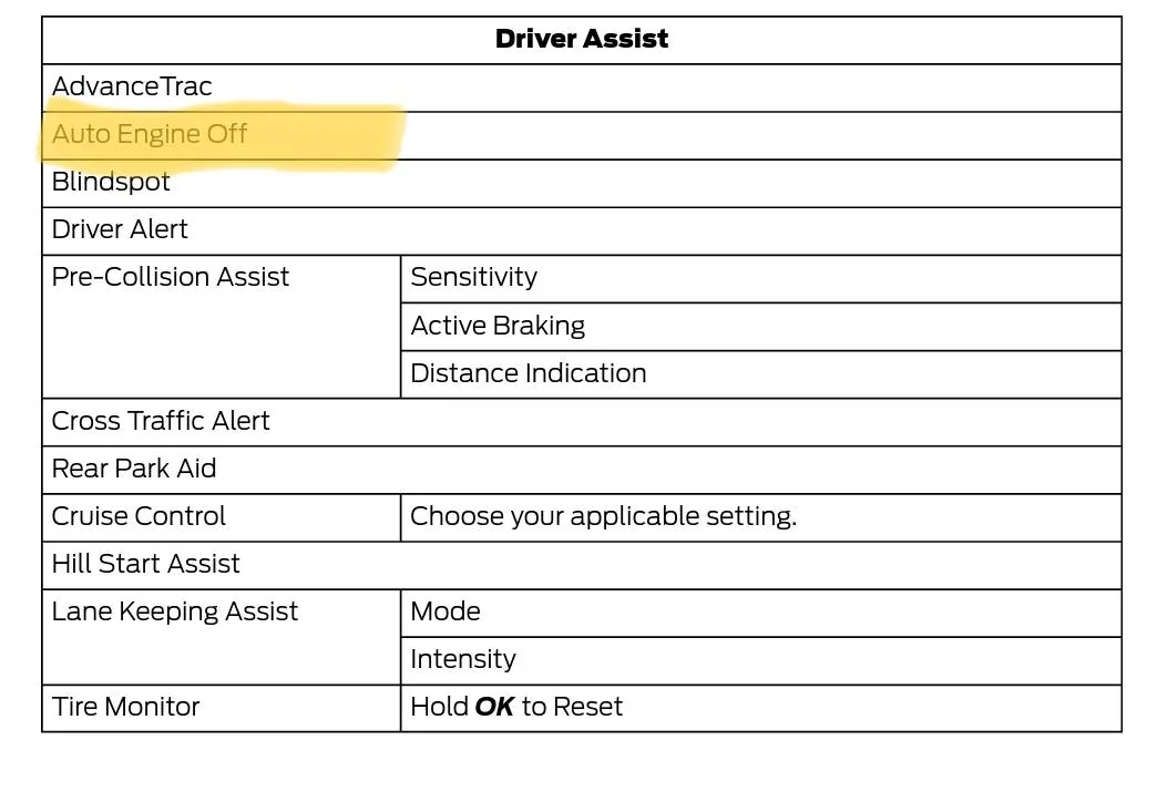

Hi Mike. Not referring to “auto stop/start” as no Mustangs have that. What I am referring to is an item in the information display.
This is from my 2019 owners manual.

That is correct. If you don't disable the "auto engine off" when doing the update with a memory stick, the engine will shut down after about 20 minutes and you have to start the installation all over again.
The auto engine off is a safety feature. If you forget to turn the car off when you park it then it will shut down without filling your garage with carbon monoxide.
I thought that only pertained to if you start it remotely with the fob/phone so it will only run so long before you start to drive it. So does the engine have to be running or will the "auto engine off" kill all power if you leave the ignition in the key on engine off position also.

Nope this has nothing to do with remote start. But you make a good point. If you go the charger route I believe that the update will start without the car running (this is easy to try). If you plan on running the engine then you have to make sure the auto off is turned off. Sorry for the confusion. Honestly I've never done an update that I wasn't behind the wheel for. It's just more fun!
