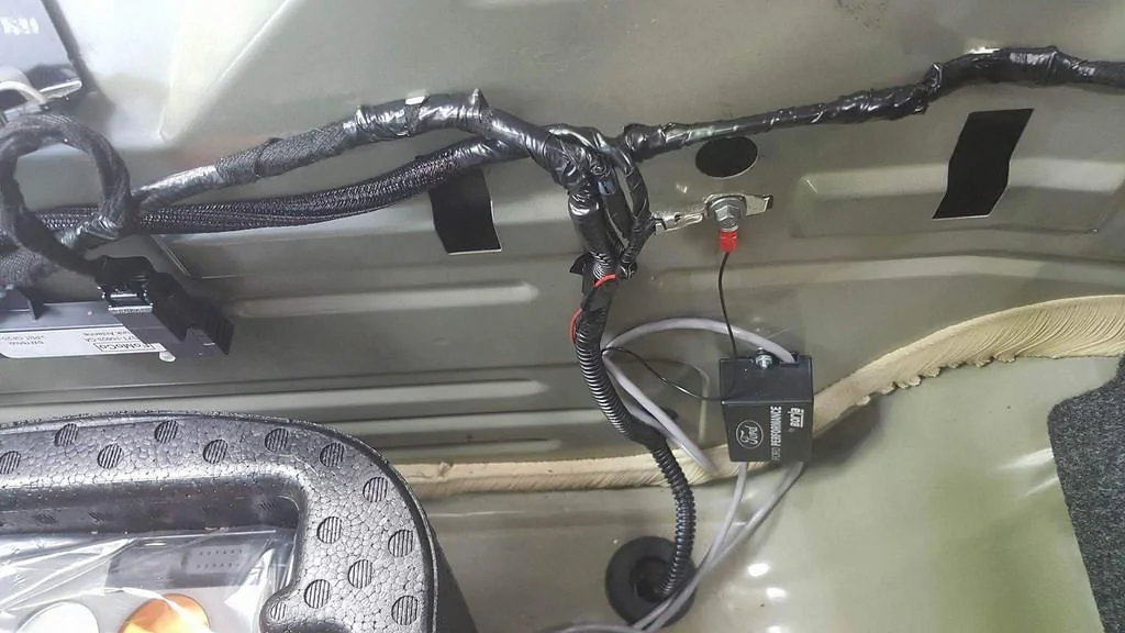

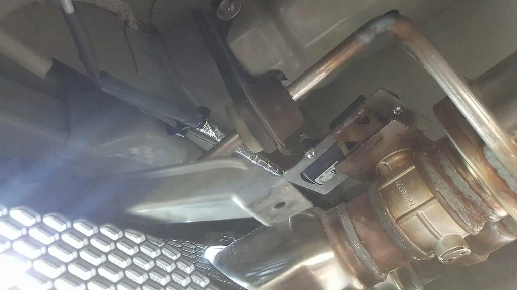

Finally got this done!

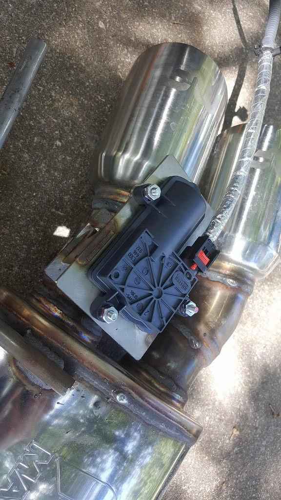

I scored a great deal on a Magnaflow GT350 Competition Catback. I had the exhaust shop take the leads down to 2.25'' and the rest bolted right up. Since I didn't have any of the motors or wiring yet, I rigged some bailing wire to keep the valves from fluttering and rattling.
I contacted Borla and (thanks to advice from Ford Performance) told them that I needed to replace a broken part of the M-5200-M8 kit. The control box, wiring, and remote cost about $100 shipped.
Motors came from Levittown Ford for $93 each. Borla was certain that their wiring would not work with OEM motors and that theirs were "different" but they fit right in and work properly so no worries there for anyone who may get push back.

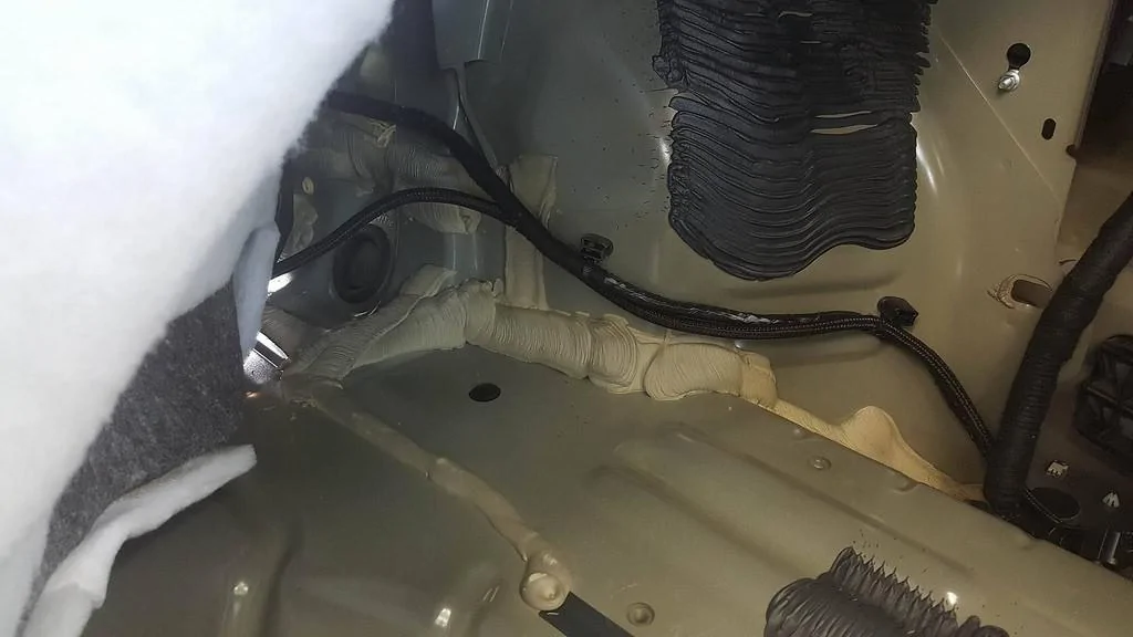

Wiring is relatively simple, even though the directions from Ford did not work with my vehicle. The box is mounted down low in the spare tire well. You reuse a factory grounding location. Power (for me) had to be pulled from a switched 12v source and I used a blue/white wire that powers the backup camera. I got power right behind the pass side back seat and ran the wire next to the factory harness to the back. Everything else dropped in and was plug and play. I love the active exhaust!
My wire running alongside the OEM harness
Tip :
it's easiest to plug them in BEFORE putting the axleback on.
Route the wire, get the axle back situated, and make sure it's all aligned. Secure the excess wire and enjoy!
