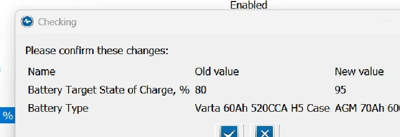

Has anyone changed this ? I upgraded to a AGM battery with much higher CCA and the closest selection I could find in Forscan is this.
