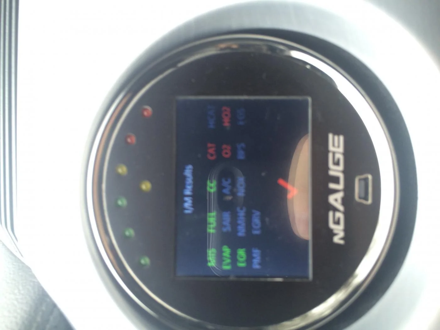

I have stock manifolds and a Catback exhaust along with all other mods below. My CAT, HO2 and O2 readiness monitors aren't setting as "ready". Very odd... I talked to Lund and he said all my emissions settings are stock and nothing has been modified in that area. I'm wondering if I should install the O2 spacers just to see if they will set for shits and giggles. Sorry for the sideways pic... The pic is actually taken correctly but when I link it to here it switches it to sideways

How long has it been since your re-tune? Does your car sit for long times?
